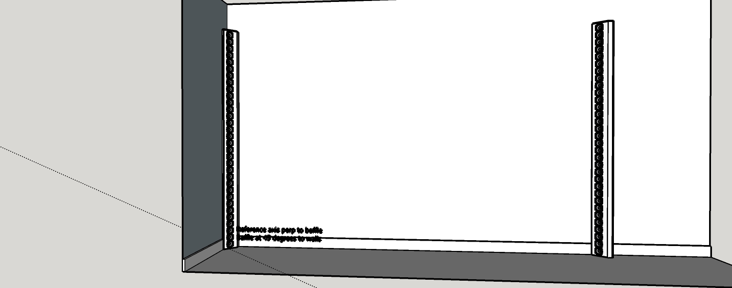

My stereo pair has one in the corner, as you saw, and one on the wall far from corner. The baffle/drivers there are rotated also, unfortunately. Maybe not unfortunately - I think/hope it has less boundary interference that way even if I can't model it in Vituix.
I will content myself with looking at floor and ceiling reflections, without side or front wall reflections, as I plan absorption on walls next to the speaker. Results seem reasonable that way. With rotation and front and side wall reflections, need for absorption was clear and that tracks with what I've seen online.
One more rotation parameter to VCAD could be useful because reflections from walls parallel and perpendicular to listening axis is not very common in practice. It's okay for simplified studies.

I was just going to say in response to your prior comment about needing one more rotation parameter that it sounds like you were working on something.

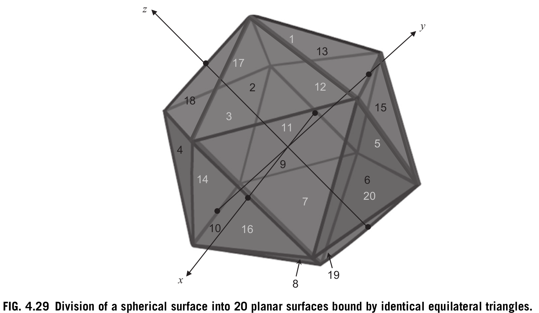

I am not sure, but I believe you are referring to Figure 4.29
Not that one.
I don't see how the method implemented in Vituix could be the same as the "simpler Beranek + Mellow" approach. I am therefore left with the (somewhat vague) assumption that Vituix uses the formula described in the Tylka document..
Short history of power & DI in VCAD: In the beginning whole 0-180 deg with constant angle step was required to get decent result. Weighting was simple sin() - just like in example of Beranek & Mellow. Calculator tool still uses that method. 2nd generation was simple weighting with sin() but at the middle point of possible arbitrary sectors. Arbitrary angle steps and left/right asymmetry and shorthanded data was allowed. 3rd generation had integral of sine within each - possible arbitrary sector. Current implementation is area calculation of sphere (instead of integral of sine). Logic for sector limit detection was updated (better or worse, but at least more readable code). All of those give quite equal results, but flexibility has improved.
So calculation is not Beranek & Mellow or Tylka or any other wise guy or smart a**. It's by Saunisto (local idiot from countryside) with required workarounds to manage shorthanded data.
Now BACK OFF please. This won't help you to make decision should you measure some monkey speakers from rear or not.
