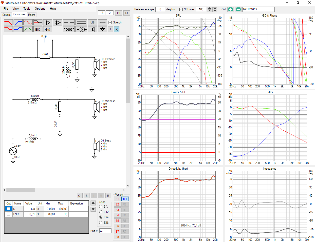

Hi folks,
I'll be using REW and Vituix for the first time to design a speaker crossover. The project is a 40cm wide baffle TMM 2.5 way with Vifa MG18WKs and Peerless DX25 mounted on a WG148 Visaton waveguide. The bottom midwoofer will be used as BSC.
The question is, the two midwoofers share the same box and need to be measured connected together, correct? But how to isolate them when drawing far field responses?
Or far field responses could be measured with separately connected midwoofers, gated measurements with no supposed influence from the box, but near field measurements with both of them connected? Then merging the responses?
What about impedance measurements?
Yes, far field can be measured with each driver individually. Of course, the cabinet response will not be correct with only a single driver playing, but only affects the low frequency portion that won't be captured in a far field measurement.
Near field requires both woofers connected to capture the correct cabinet response, you may try playing a pillow in between to reduce influence from the second woofer for the near field measurement.
Same for impedance, it requires both driver connected to capture the correct cabinet response. The measured impedance of both drivers may be used individually for each driver in VituixCAD, with scaling set as either 0.5 or 2 depending on whether the drivers were connected in series or parallel.

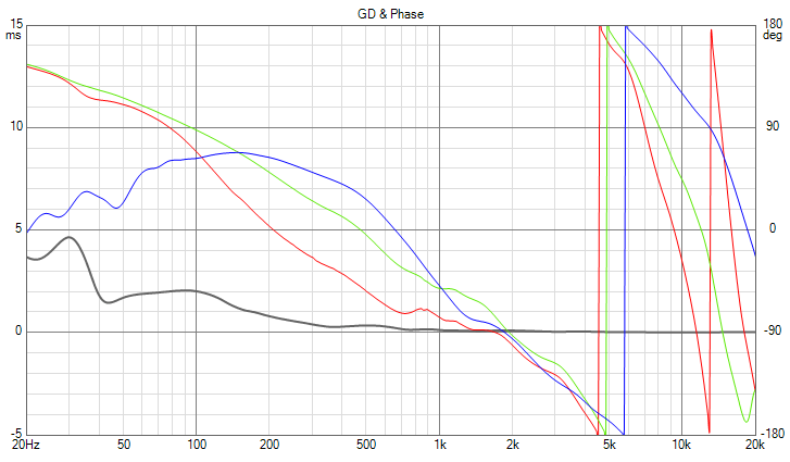

Quick questions. When aiming for good phase alignment, in Vituix, what are the priority targets to look for in the GD & Phase window? I'm currently prototyping the crossovers of the 2.5 way project. The blue line represents the waveguide loaded tweeter, whereas the green one depicts the midbass driver. As I've heard from other folks using Vituix, the Lines should interleave as most as possible, but at what point is the priority one? The crossover point?
