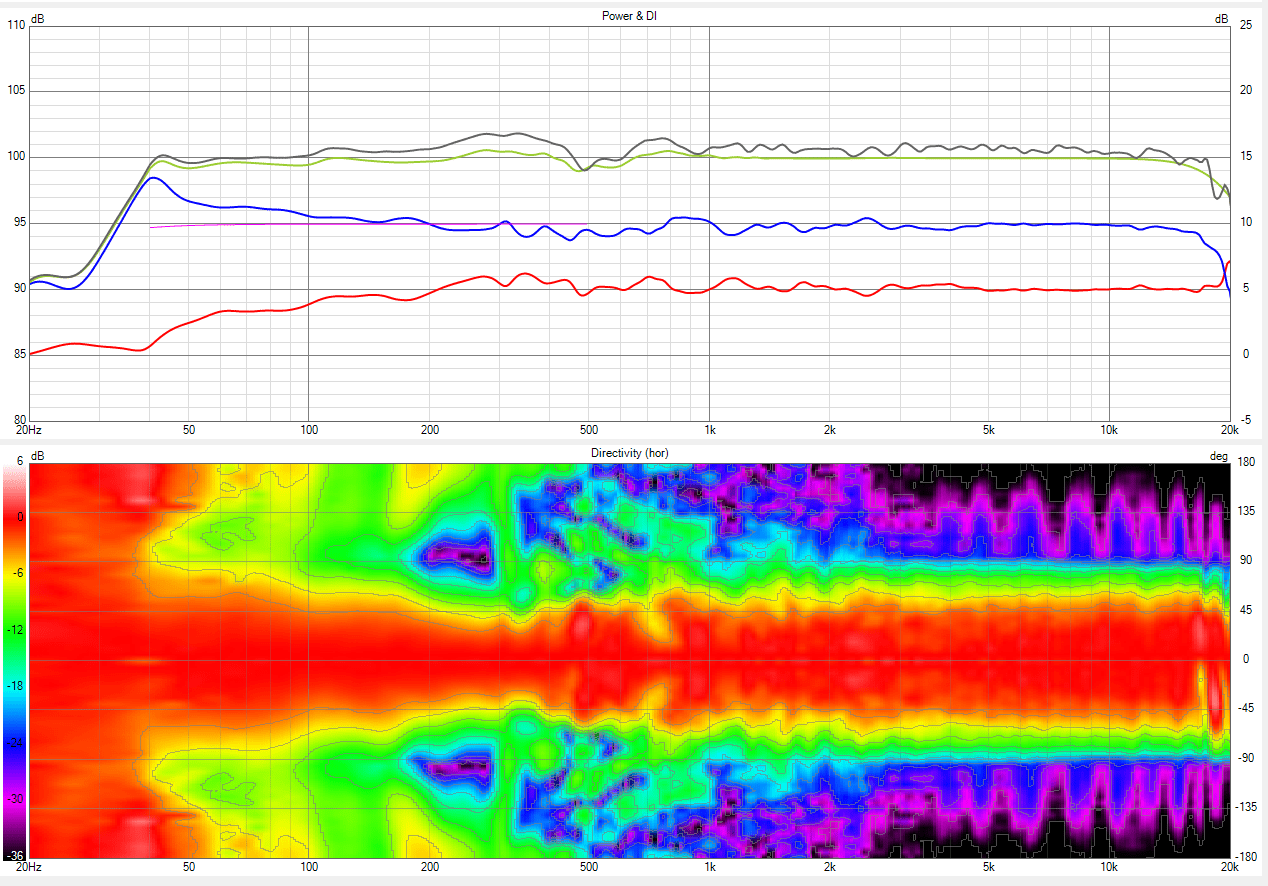

Dear Kimmo,
I have a request for an upcoming update;
- could you please remove the '0' limit of the listening window angles?
reason for this is that I would like to have the possibility to optimize on of-axis angles (i.e. take -120 tot -180 as listening window to optimize a cardioid filter setting, this is currently not possible because the listening window can only go from -x to 0 or from 0 to x )
I am trying to optimize the filters of the loudspeaker as shown below:
2- would it be possible to have the DI curve as an optimization target? This would be very useful imo
Thanks in advance!
Kees

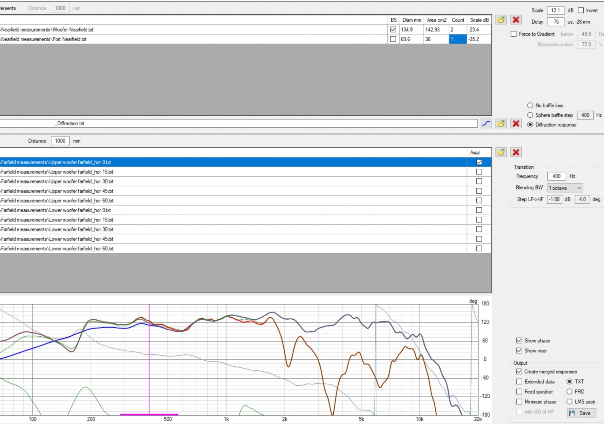

A couple of short questions about the merger tool.
When I measured nearfield, I attenuated the volume by 20dB compared to the farfield measurements. So the scaling should be in the neighbourhood of this according to the tutorial. However my scaling is at 12dB, thats a big difference. What could be the cause for this?
What does the delay of -26mm refer to?

Hi Lament, attenuation would not be only the 20dB attenuation used, but also the difference of SPL over distance from near field to far field. In the merger, you've set far field distance at 1m, is that correct?
Your screenshot is not showing only a -12dB attenuation. Based on the driver diameter entered it is showing -23.4dB adjustment of the nearfield response to compensate for SPL over distance, in addition to the -12dB overall attenuation.
Problem I see is that you've entered a count of 2 for near field response, and loaded both sets of measurements for each woofer. This would only be correct if you measured both woofers far field as a pair, in which case you would only have a single far field measurement set, not individual "upper" and "lower" measurements. Count of 2 for near field response will create 6dB reduction in the response scaling.
Change near field count to 1 and process the far field response for each driver individually. In any case, I don't put too much confidence in the automated math based on driver size and distance, use your eyes on the graph as the best guide.
Delay of -26mm is the delay required to align the phase of the near field measurement with the far field at your merge frequency. Best to not adjust this value, but for your education go ahead and adjust it and observe the change in phase response that it provides.

Yes 1m far field is correct.Hi Lament, attenuation would not be only the 20dB attenuation used, but also the difference of SPL over distance from near field to far field. In the merger, you've set far field distance at 1m, is that correct?
That makes perfect sense, the scaling to align LF and HF part is now at 18dB, much closer to 20dB 🙂Your screenshot is not showing only a -12dB attenuation. Based on the driver diameter entered it is showing -23.4dB adjustment of the nearfield response to compensate for SPL over distance, in addition to the -12dB overall attenuation.

So if I understand correctly, I keep the upper and lower woofer measurement sets (0-60 degrees horizontal for each). Click save, and a merged response file for each measurment is created. I then import these measurement sets for each woofer in the Drivers tab in addition to the tweeter far field measurement set. And if I remember correctly, set scaling to 2 for each of the zma files for the woofers.
I understand, thanks Dcibel 🙂

The only caveat is that if you want to utilize power & DI charts to their full potential, 0-180 deg measurement set is required.So if I understand correctly, I keep the upper and lower woofer measurement sets (0-60 degrees horizontal for each). Click save, and a merged response file for each measurment is created. I then import these measurement sets for each woofer in the Drivers tab in addition to the tweeter far field measurement set. And if I remember correctly, set scaling to 2 for each of the zma files for the woofers.
Yes, scaling = 2 for impedance loaded that is measured as 2 drivers in parallel. Scaling = 0.5 for 2 drivers in series.

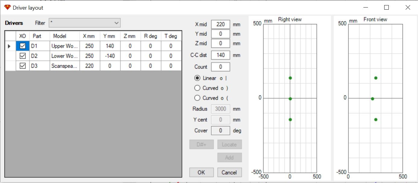

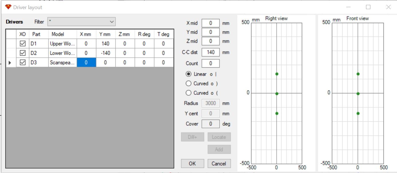

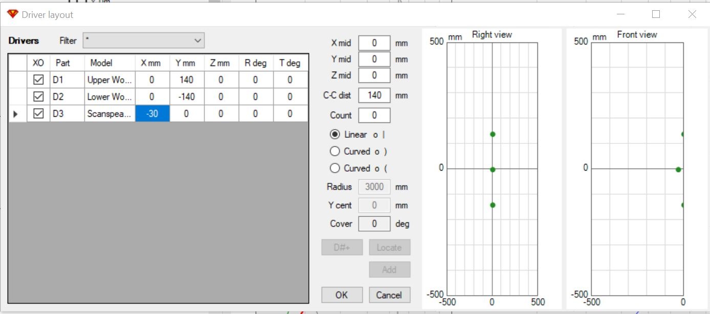

Driver layout in crossover.
MTM with tweeter offset 30mm, woofers 140mm above and below tweeter.
Layout 1 shows only vertical position of woofers relative to tweeter. On layout 2 I tried adjusting the 30mm horizontal offset for the tweeter. Instead of moving the tweeter 30mm to the left, the X'0' reference point is moved all the way to the right. So '0' is no longer in the centre of the baffle, like on the first image. What's up with that, is this a bug, or did I misunderstand something (I'm guessing the latter)?
Layout 3 shows how it is supposed to look, adjusted for the new X coordinates.
Also don't understand why Z'0' is in the middle point of the speaker, and not on the front baffle (Z'500' on the Right view).
But Z is not supposed to be adjusted I guess, since this is incorporated in the semi-dual channel measurements?

All 3 images are correct for the values entered, it is just axis scaling if you look at the x axis values at the bottom of the chart. I wouldn’t worry too much about it, based on your description the values in layout2 are correct. Alternatively you could enter x axis of 0 for the tweeter and offset the woofers to keep the tweeter as the design axis even though it’s offset on the baffle. At 2m+ listening distance it won’t make much difference.
z offset remains at zero for all drivers provided that :
-dual or semi-deal channel measurement was used
-the baffle is flat
-mic distance to baffle is unchanged for all measurements
-all measurements processed with the same window start reference time

DcibeL's answers probably cover these but in the other words:1 - could you please remove the '0' limit of the listening window angles?
1. Optimizing power average to some sector in rear (instead of listening window) without power response would not optimize directivity. It just searches the first local minimum to get that sector to target response with selected parameters to be optimized. It would probably ruin both on-axis and power response. Optimizing full power response and power average to limited sector in rear could also ruin on-axis without getting directivity to target.
So the only option to optimize polar pattern to omni, cardioid, super-cardioid, hyper-cardioid or dipole is to calculate measured/simulated polar pattern and penalty factor compared to target polar pattern designed/selected by user. That feature wouldn't be very difficult to add if target is simple textbook gradient with adjustable monopole part 0...100 %, and constant within frequency range of Power & DI target curve.
2. Optimizing directivity index is possible, but requires one more radio button for target response of Power & DI chart. Some weight for on-axis is also needed if parameters to be optimized affect on-axis response too. In that case optimizing on-axis and power response with 'Seek level' checked makes the same thing. This option would not optimize polar pattern so result could be anything within cardioid and dipole, just giving target DI.

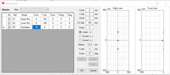

I just discovered that simulated frequency response differ slightly between layout 2 and layout 3.
The X offset and relative position between drivers is exactly the same on both layouts, so why the difference in frequency response I wonder?
Joined 2003
Layout 3 moved your speaker off axis. Instead of the speaker pointed directly at the listener, it has moved 250mm to the side
Of course, I should have thought of that.Layout 3 moved your speaker off axis. Instead of the speaker pointed directly at the listener, it has moved 250mm to the side
But I would have preferred having the X 0 position in the middle of the front view, just seems more intuitive to me.
Thanks again Dcibel, I appreciate your assistance 🙂
