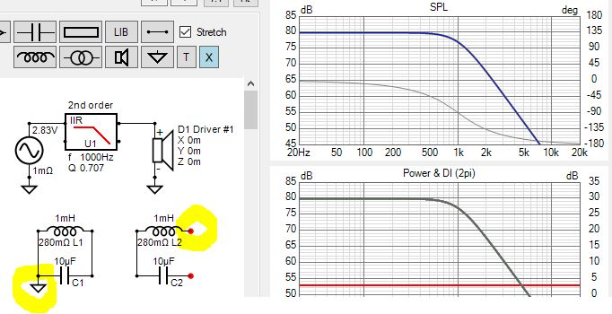

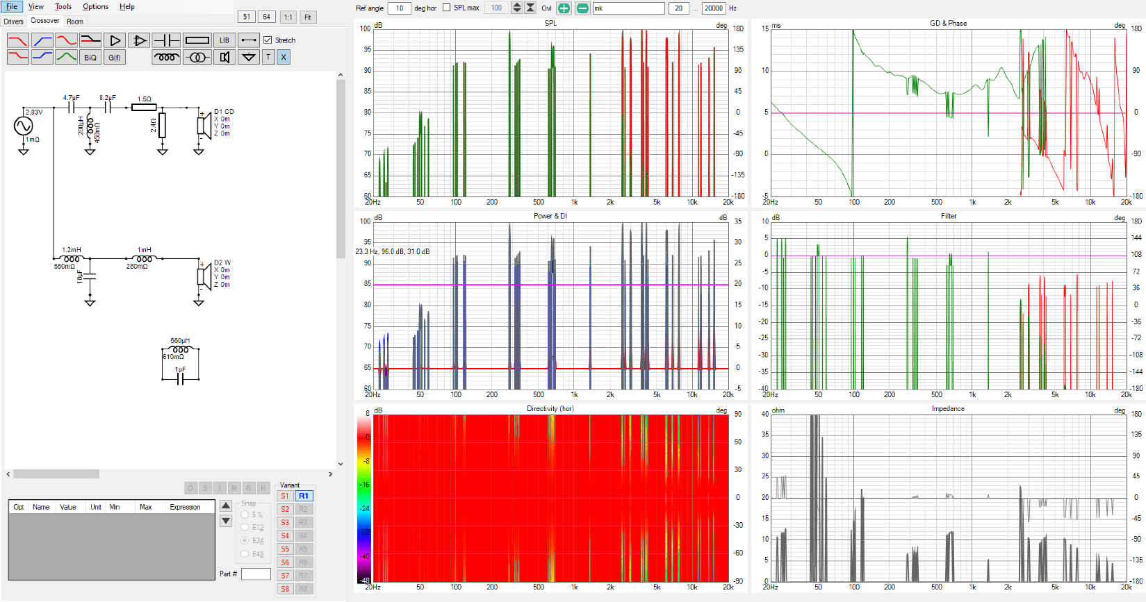

I've noticed I can make the calculated response go haywire recently, it's caused by those extra components at the bottom that aren't connected to anything (except each other). If I disconnect a link between those 2 components, everything goes back to normal.
Obviously I can easily avoid this but thought it worth mentioning anyway as I guess it's a bug
^Equation solver requires some connection to source or ground. For example transformer requires hidden resistor in the secondary to work at all. Basically most...all spice simulators have the same feature. Open connection points with red donut have this hidden resistor, but not otherwise legal circuits such as two components connected together. Try to make legal circuits because that will stay as is.
Two cheap tricks to maintain own "block library" in the schematic:
1) Add extra ground symbol to some terminal.
2) Leave one or more component legs unconnected. Program adds invisible resistor from red terminals to node 0 i.e. ground to keep equation solver running.
