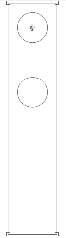

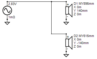

Quick simulation of MTM. Baffle 210x1000 mm, upper mid Y=895mm, lower mid Y=615mm, Dd=130mm, mic at 5 m while diffraction simulation. Both planes and positive and negative angles were exported from Diffraction tool.

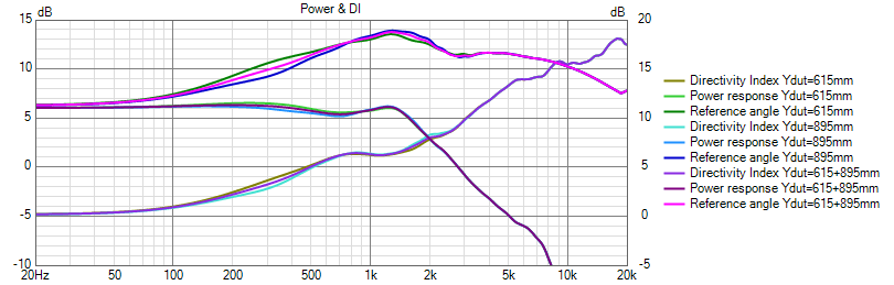

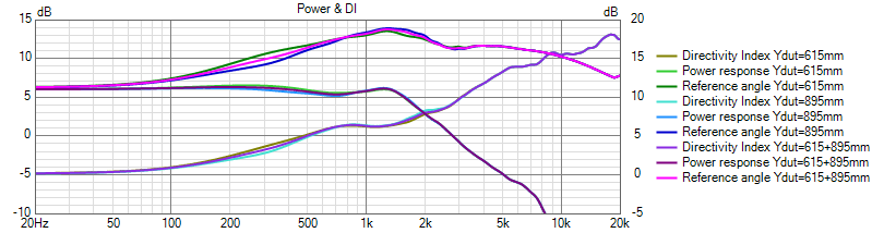

Three XO variants were simulated and fundamental Power&DI traces saved to overlays:
1) Both drivers use data of lower mid Y=615 mm
2) Both drivers use data of upper mid Y=895 mm
3) Drivers use their own data Y=615+895 mm
Result stays close to same also without data in vertical plane and negative angles. Deviation from full data is probably less than 1 dB with this kind of typical MTM also in real life. That is "promised" in measurement instructions for simulation of circular drivers/horns without data in vertical plane. Smaller deviation is expected with shorter cabinets which reduce effect of vertical (Y) location.
Every user have to make own decision how much measurement data is captured for XO simulation. For example I don't usually measure vertical plane, negative angles and more than one driver per model. Assumption is that box design is healthy; symmetrical over vertical center line and long rounding and/or bevels. This cheating saves huge amount of time for example with line array projects.
