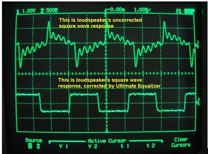

Is it just single driver with some cone resonance at ~3 kHz and lower SPL at LF than HF. Equalized and shown as 300 Hz square wave.Hello Kimmo, what do you make of this?

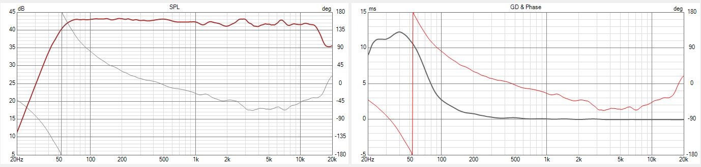

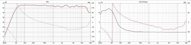

Attached is measured response and group delay of my diy, passive XO, two way.
Far field 300Hz+, near field bass and port added (minimum phase both), baffle compensated and merged at 300hz with far field. All done by Vituix tools.
Resulting file is then loaded in crossover simulator, one driver response. Is this correct procedure to get measured LF group delay?
If this procedure is correct, should I be satisfied with this numbers for group delay, considering passive X over?
Number is 2.7ms at 100Hz and 11ms at 50hz.
Simulated group delay in enclosure tools was 2ms at 100Hz and 10ms at 50hz.

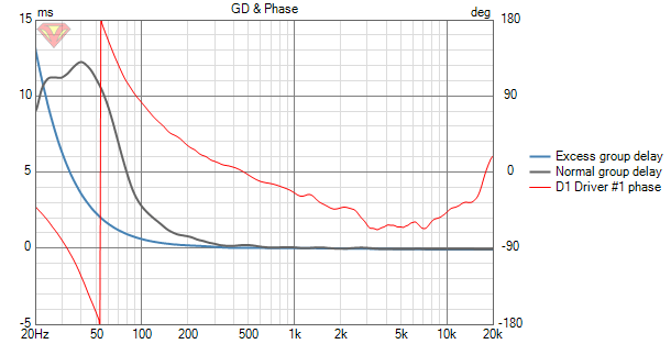

Looks normal. I would look excess group delay only because that's the one we can optimize. Normal group delay depends on HP slope and extension of LF radiatorand may have some small extra delays too.Is this correct procedure to get measured LF group delay?
If this procedure is correct, should I be satisfied with this numbers for group delay, considering passive X over?.
Single radiator with flat response close to 0 Hz can have 0 ms group delay down to 20 Hz. That fun ends when it's crossed to main speakers for example at 80 Hz with 4th order IIR. That action creates excess group delay of ca. 7 ms. 8th order XO ca. 15 ms and so on.FAST was first what I thinked about....
Here it is. Its 2.3ms at 50hz and 0.6ms at 100hz.Looks normal. I would look excess group delay only because that's the one we can optimize. Normal group delay depends on HP slope and extension of LF radiatorand may have some small extra delays too.
Its a bass reflex, passive speaker. How can we optimize excess group delay?

My comment about showing excess GD was generic. Your 2-way has already close to zero excess GD due to XO, and LF is typical for vented so all okay. Getting minimum phase i.e. flat zero excess GD down to 20 Hz would require FIR and quite much taps.Here it is. Its 2.3ms at 50hz and 0.6ms at 100hz.
You will lose debate by defending weakness proven by reliable studies. Target in my projects is not higher than typical audibility level of old studies. Excess GD <2 ms at 100 Hz is reasonable and achievable for 3-way with quite low XO so I don't have to make questionable decision by accepting e.g. three times longer, and I won't certainly recommend that for the others.you're free to believe and follow anything you want that's the thing I agree with.
