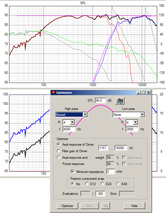

I've been trying to work out the targets. I'm uncertain what I should put in the frequency dialog. When I put in my crossover frequency the curves are way off. Examples attached. target 4th order bessel at 2.8Khz. If I put in 2.0Khz for low pass and 4.0Khz for high pass it appears to be about right.

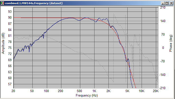

Third attachment is same crossover in speakerworkshop with 4th order bessel target at 2.8Khz.
Is the frequency to put in the corner frequency, rather than the crossover frequency? I'm not even sure how to calculate that! 🙂

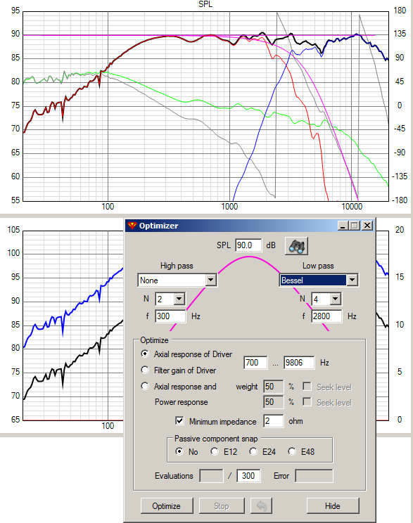

I just tried to run the optimizer, however it tells me I need to select parameters to optimize, I selected some of the components in the crossover but it didn't help.
Also if I click on a component to change value, the target response disapears from the spl window, it only comes back if I click on the driver. Could it be made to display the target all the time?
Unfortunately Bessel filters have (at least) two different designing standards in practice:
a) -3 dB at corner frequency
b) phase shift according filter order at corner frequency
You can select most suitable option for you and possible dsp device with "Bessel phase normalized" setting in Options window. Phase normalized (b) is quite common in dsp devices, though level normalized to -3 dB is more logical for user because level stays constant at corner frequency with any order.
Problem is that Optimizer must know what driver is selected for optimizing. If user clicks some other part, optimizer cannot be sure anymore what is the target. Of course we could agree that target driver is the last selected, but user should remember that. Might be difficult if 20 driver instances in the project.
Another implementation option would be listbox of all driver instances. Listbox would refresh automatically if user adds or removes drivers. That would be easiest for the user because target driver selection is maintained while user plays with the crossover. Challenge is that how drivers are identified if there is 20 instances of the same driver in the network. Only choice would Model name + part number which is visible also in the crossover schematic.
Turn Optimize bit On. Select components with multi-selection, right click and Optimize On from context menu. Optimize bit must be Off if you want to lock existing value. Optimizer screws up very easily and fast whole network if you forget to switch Optimize Off from all components which are not in the same network with selected target driver.
You can select components from multiple "ways" only for optimizing total axial response.
