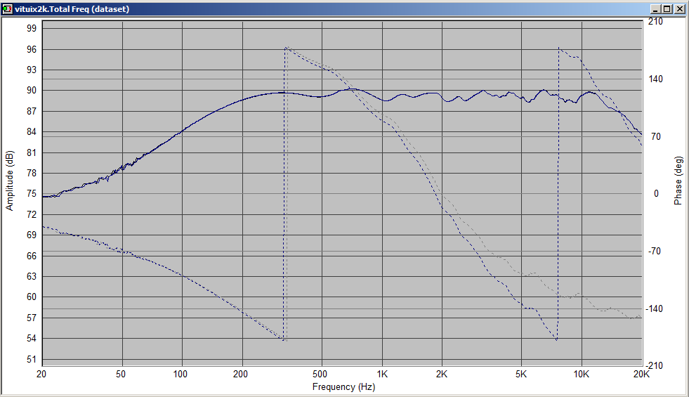

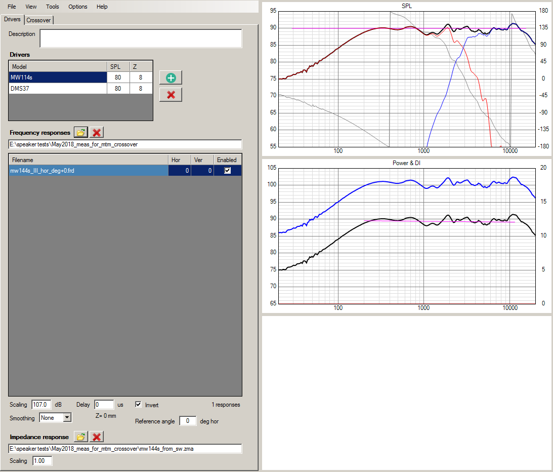

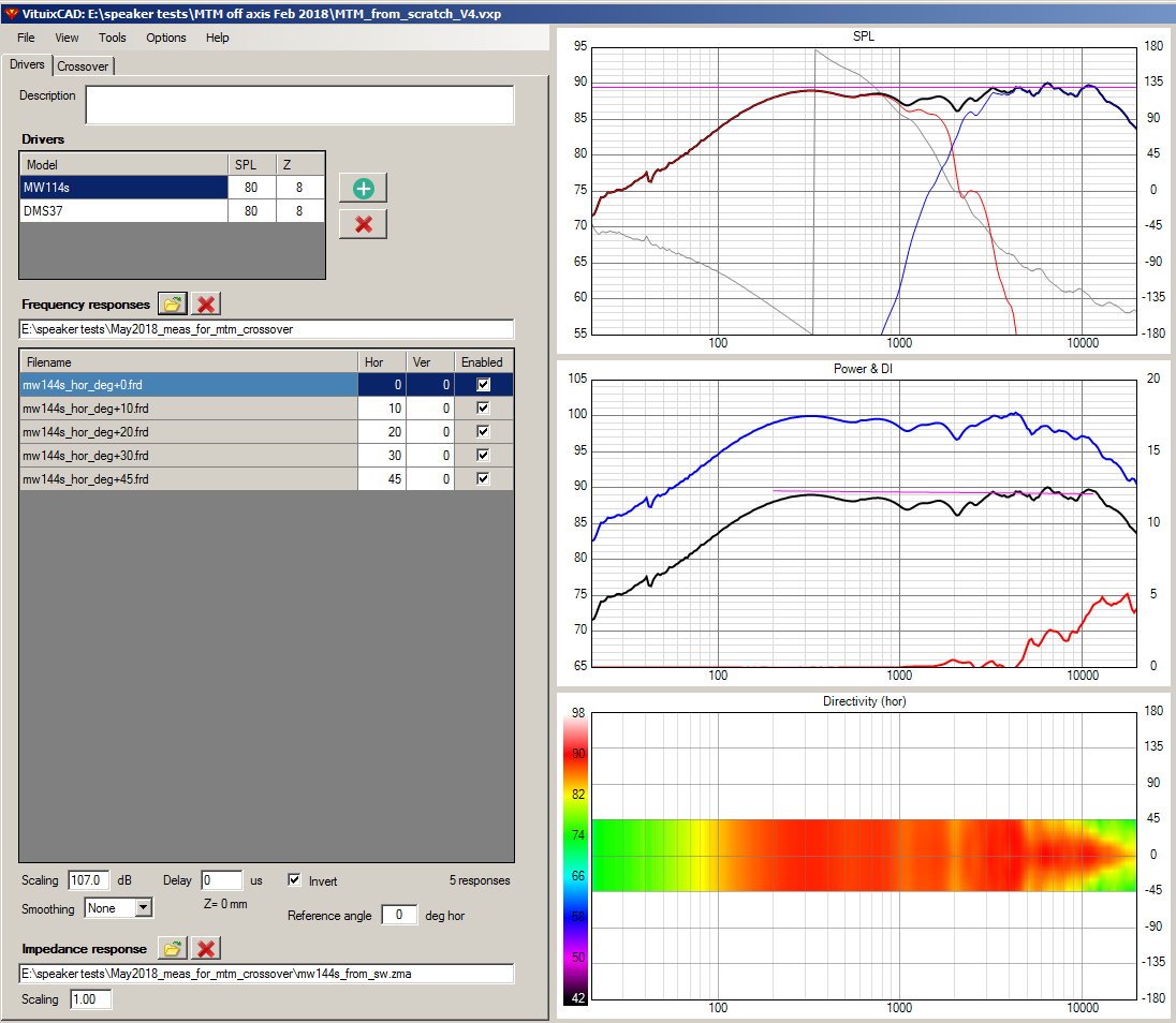

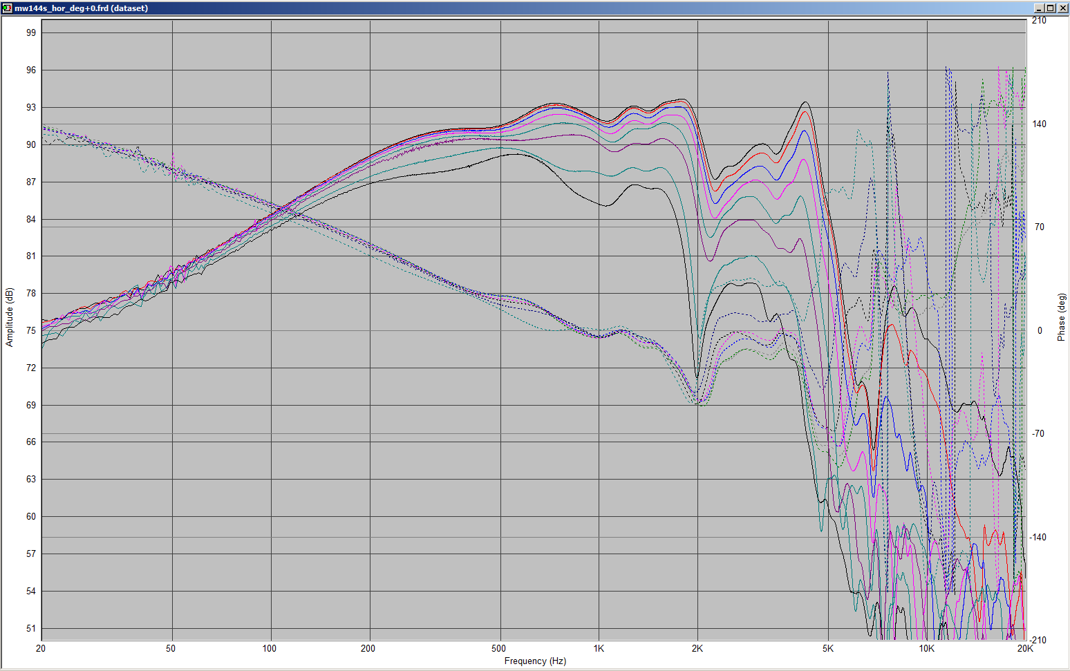

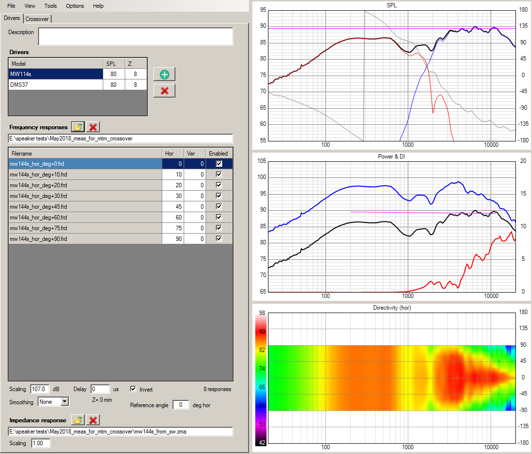

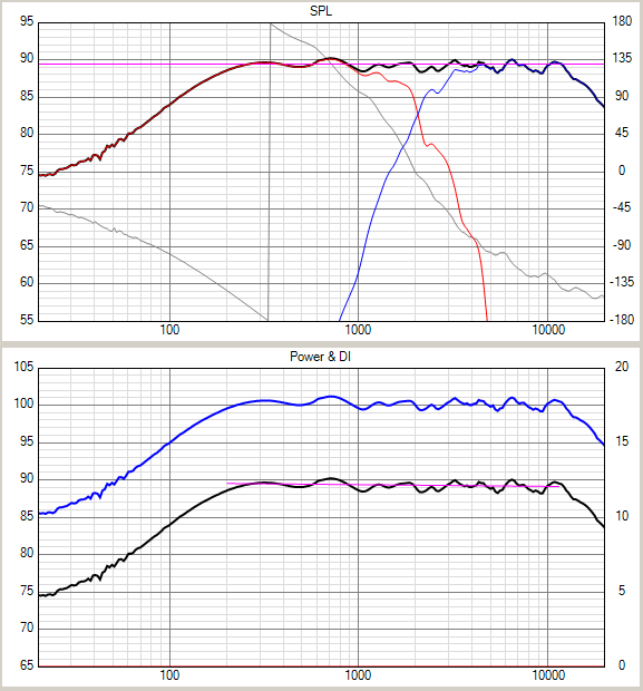

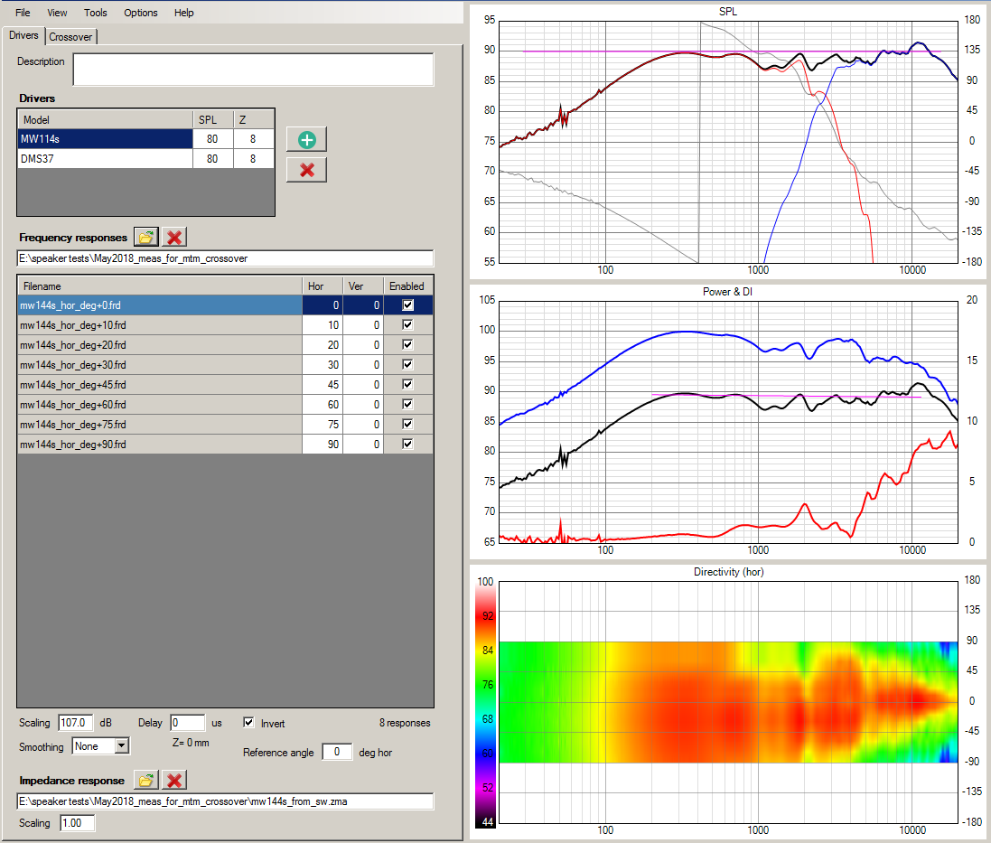

I've got a question regarding the off axis measurements as well. I took measurements to 90 deg at 10, 20, 30, 45, 60, 75, 90
When I put these in I get VERY different spl curve for my crossover, compared to just using the 0deg curves. The differences seem to start to get extreme when I add the 60deg and higher.
Do the measurements have to have a constant variation (ie all 10deg steps, or all 5 deg etc?)
Attached are comparisons of 0deg only and with the zero to 90 deg and with zero to 45 deg.
I'm not sure if there is something wrong with my higher angle measurements or not.
Additionally there seems to be a bug with turning different angles on or off. If I click on the tick box nothing happens. If I double click it, the curve changes, but the tickbox looks the same.

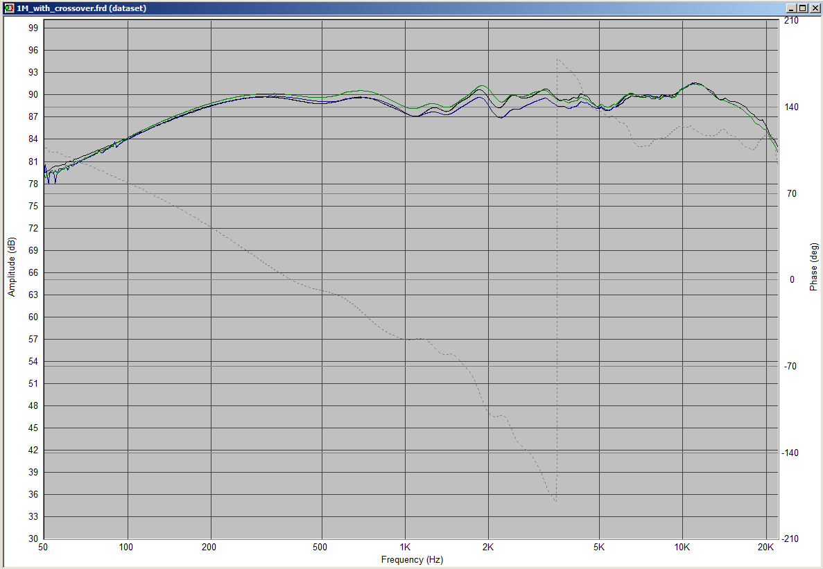

I also tried a sim using my current crossover with the same measurements and compared to actual zero deg measurement with that crossover. When using just the zero deg measurement in the sim, the results were quite close. When using the extra measurements It varies a fair bit (but no where near as extremely as the first three curves below.
I'd like to use the data but at the moment I'm either doing something wrong, or the difference in results is quite scary!! 🙂
edit: added the 4th and 5th graphs, which are the current implementation of the crossover, which I've compared against real measurement.
edit2: one additional graph. black actual measurement, green vituix sim with 0deg data. blue vituix sim with 0 through 90 deg data. I'm confused 😀

That looks quite funny though fully expected: blended set of partly automatically mirrored data from the other plane, and partly from response files from selected/shown plane.
Basic rules and recommendations:
1) Use integer angles. 7.5, 22.5 deg etc. are rounded to integer.
2) Use the same angle recipe for both hor and ver planes to avoid mixed mirroring. Angles (measured or mirrored) which are common for all drivers are accepted to simulation. 'Enabled' column in response list is not checked if angle is rejected.
3) Constant angle step e.g. 10 degrees is not must but makes life easier due to logical measurement procedure.
4) Measuring of horizontal plane to positive angles only gives quite okay result with circular drivers. Measure both planes if driver is not circular, or to get more accurate result because diffraction effects are not exactly equal to hor/ver. Also negative angles if driver is quite much off the center line.
5) Measure also rear sector 90-180 deg to get more accurate power & DI result. Especially with dipole, bipole and and other omnipolar due to probable asymmetry front to rear. 0-90 deg sector is minimum requirement for unidirectional speakers, but recommended only for wall speakers and very unidirective such as horns.
Few examples:
1) Taipuu 4-way is measured in horizontal plane to both positive (right) and negative (left) angles. Angle step is 10 deg, 36 measurements per driver.
2) Taipuu 3-way is measured in horizontal plane to positive (right) angles only. Angle step is 10 deg, 19 measurements per driver.
Enabled checkbox is read only, just information for user. See previous message.
Double-clicking of response list changes reference angle (axial direction). 'Reference angle' text box tells current axial direction.
Some response simulations looks strange indeed. Verify that:
* All driver instances in the crossover are associated to existing driver in Drivers tab; driver combobox (between schema and parameter list) has correct name.
* Response simulation might also be frozen if crossover network parsing is not successful. Check that all component terminals are connected to other treminals directly or with wire. You can force new parsing e.g. by disconnecting (moving) and reconnecting one ground symbol, or saving + reopening the project.

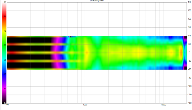

I'm sorry but I don't understand how this is fully expected.That looks quite funny though fully expected: blended set of partly automatically mirrored data from the other plane, and partly from response files from selected/shown plane.
To recap, the graph is taken from a project which has ;
- horizontal: -90 to +90 in 10 degree steps
- vertical: -60, -53, -45, -37, -30, -23, -15, -8, 0, 8, 15, 23, 30, 37, 45, 53, 60
- "Mirror missing angles" option is unchecked
All 3 drivers have the same dataset so 35 measurement files in each way. Every listed file is "enabled" according to the checkbox.
The behaviour seen is:
- horizontal behaves normally, 0-90 degree curves are visible
- vertical behaves abnormally (to my understanding), some measurement angles for the woofer only are simply ignored so the graph appears as those measurements do not exist at all
In fact I just reloaded the project and the visible woofer angles changed from
-60,-30,0,30,60 to -53,-23,23,53 with no change to the data.
Also note that the same measurement files are rendered normally if the H data is not present.

Thanks kimmosto. I probably should have stated that this is an MTM, but the M's have been measured together on the tweeter axis. I've only put in a single driver for the M's in the crossover.
The only change between the graphs above was replacing the driver response curves. first with just the zero deg files and then with the added off axis measurements. I'll do a sim in speakerworkshop, and another in PCD as a sanity check 🙂

Perhaps it was missing impedance scaling? You should scale Z response of single driver with 0.5 that crossover would see impedance of original two drivers in parallel.

No the impedance is actual measurement in cabinet with both drivers connected.
I ran the same sim in speakerworkshop and it matches almost exactly the 0deg only simulation from vituixcad. Black is the speaker workshop sim, blue is the exported vituixcad sim.
I'll check my off axis measurements, perhaps there is something screwy with the phase in some of them.
Tony.
Tony.
OK fair enough, I will remember to use the same angles in futureBut, if you have hor/ver asymmetrical planar tweeter in the same project, you must measure both horizontal and vertical planes. Horizontal and vertical angle recipe of planar tweeter must be equal to avoid wrong mirroring (from hor to ver or vice versa). No need to measure 0 and 180 deg vertically because they are already included in horizontal set (program skips these automatically too).

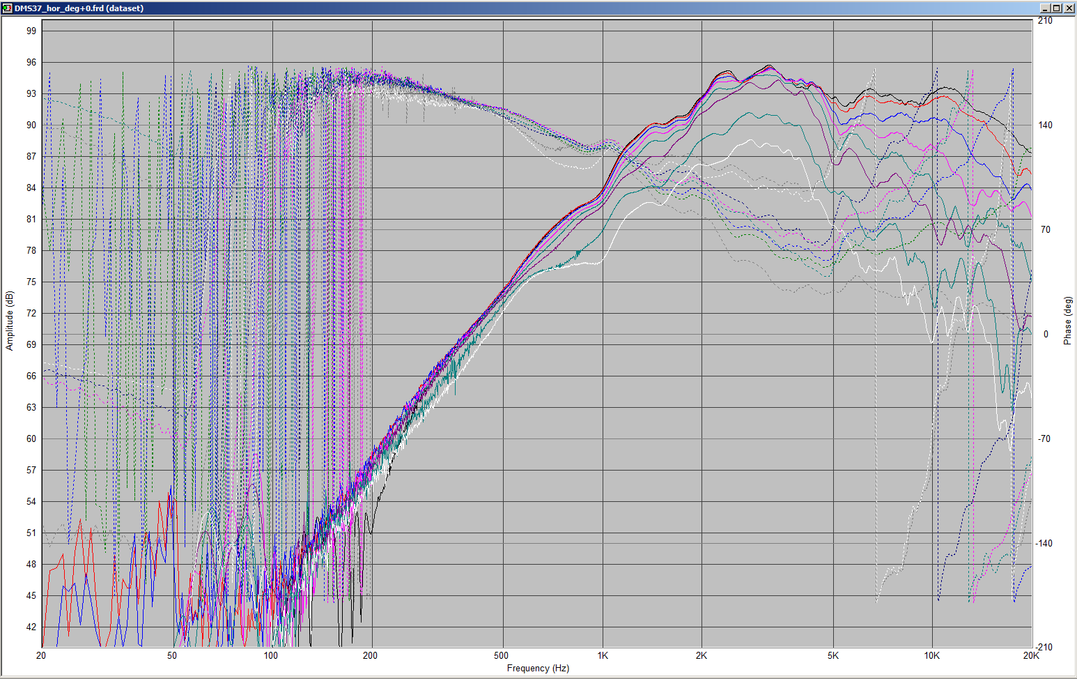

OK I've put all of the measurements on the same graph. Nothing really sticks out for me. One thing I did wonder about was the lowest frequencies being at a lower level at the more extreme angles. I wasn't sure whether they should all be starting from a similar origin there is 1.6db difference between the 90 deg measurement and on axis at 20 Hz (although gating was set at around 300Hz, so maybe that has an effect).

Wintermute, for the off axis angles, how did you measure them?
If you measured off axis angles by rotating the speaker, and keeping the mic at the same position, you most likely are not measuring the angle you think you are measuring.
This is a very subtle mistake that I've never seen mentioned anywhere, but it makes a fairly big difference. If you are simply rotating the speaker, you are most likely rotating at the wrong point of rotation. If you rotate the speaker like how a turntable would rotate the speaker, then the point of rotation is at the center of the speaker. This is wrong, because the center of rotation needs to be at the driver you're measuring. You can easily see why this is wrong. Place the speaker on axis, and have the mic point directly at one of the drivers, say the tweeter. Then rotate the speaker 45 degrees. Notice the mic is no longer directly pointing at the tweeter. In fact, it is probably not even pointing at the front baffle! The angle between the mic and the tweeter is not 45 degrees, but an angle greater than 45 degrees.
