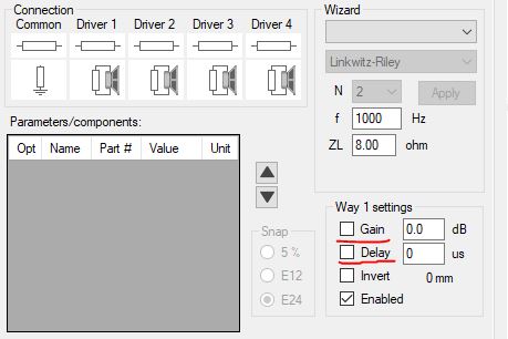

This may have been asked and answered but here it is: the "gain" and "delay" should, IMO, switch the respective functions (with some data entered) on and off when the boxes are checked/unchecked. However they seem to be on always? The two functions below them (invert and enabled) however do react to the box checking.
Thanks.
Thanks.
^This was answered last time 1st March 2018, 06:22 AM. Function of gain and delay checkboxes is explained in both tooltip and manual.
