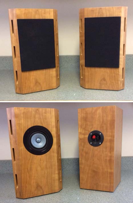

Add helper woofers with an XO below the quarter-wavelength of the XO frequency (ie drivers essentially coincident, much closer time-wise than a coax, no DSP needed). Releived of bass duties, used only as a midTweeter lets the FR perform to its best. Small compromise (low XO), for biig gain.
Caveat: the latter obviosuly costs much more than just the FR in a suitable box.
These are a bit more compromized than the above but fit my room better.
