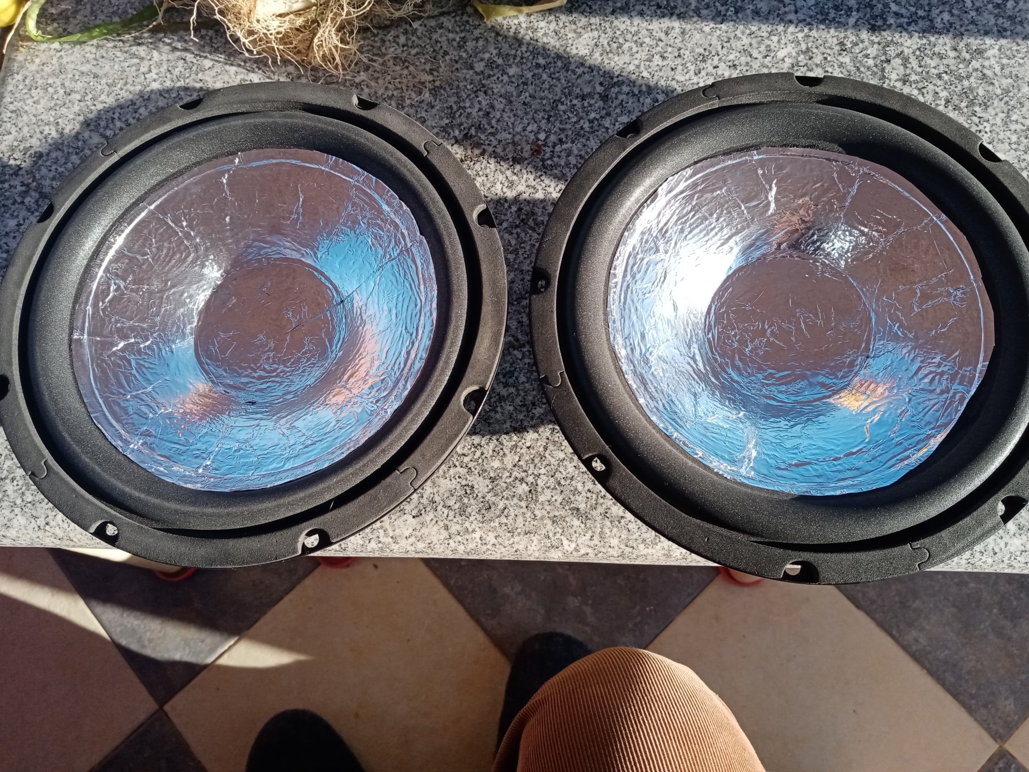

Here diy cone tweaking mod
https://www.diyaudio.com/community/...loudspeaker-sandwich-cone.402917/post-7443458
Also done on a Beyma 8agn

Been following your endeavors with aluminum foil closely and I'm really tempted to try it out.
Have you ever measured if the glue without the foil makes a difference?

@RadianBeen following your endeavors with aluminum foil closely and I'm really tempted to try it out.
I had great success with the Planet10 (Dave/Bud) approach of cone treatment.
With the Fostex 127 model it made a noticeable difference.
No I never measured only the glue.
Just tweak first one driver with foil and then make A / B comparison if you have a balance on the preamp.
I always enjoyed the better transient response. With only damping same result is not achievable.
You get the sound high tech drivers usually offer - for "free" as this DIY mod makes simple paper being something completely different.
