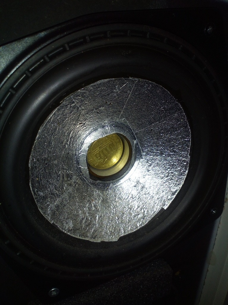

But you can do it on your own :
"50 cent trick"

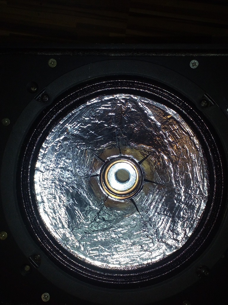

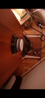

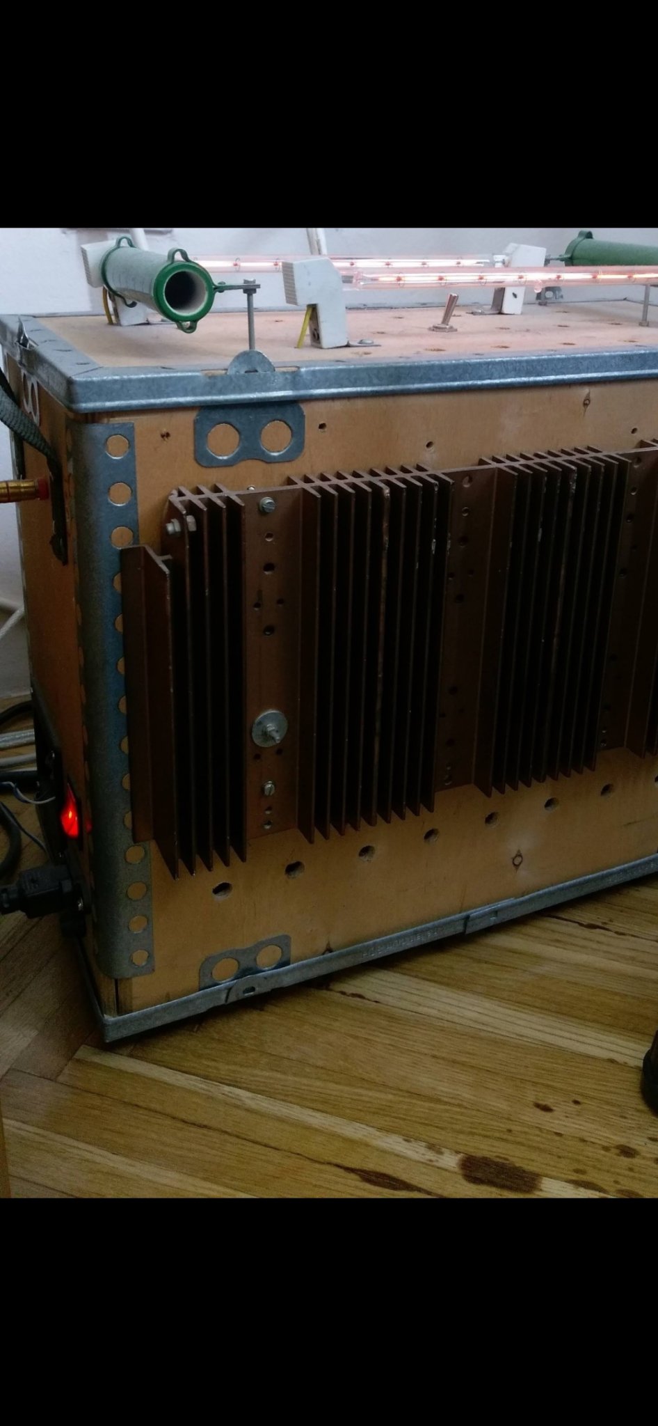

So, to be (almost) on topic:

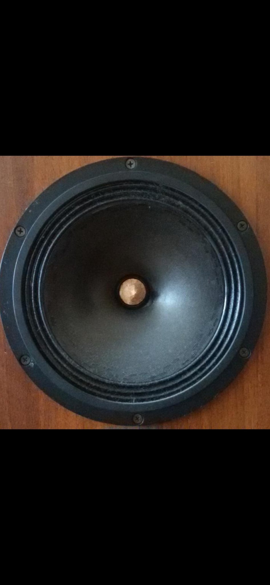

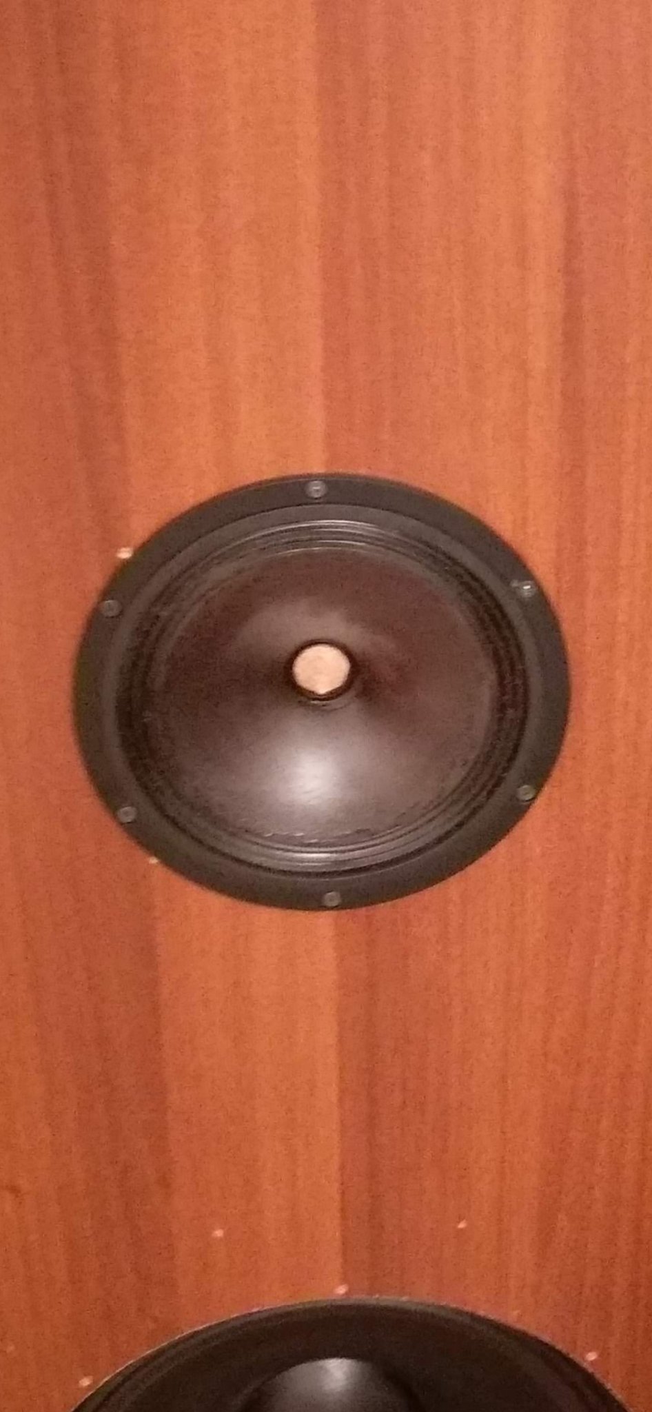

Here is the photo of my modded B200 (sorry for a poor quality)
I did all the mods as sugested by Dave (Phase plugs + Enabl). And, the transconductance amp. Then it was singing 🙂
I guess the same can be applied to B20 (and even more).

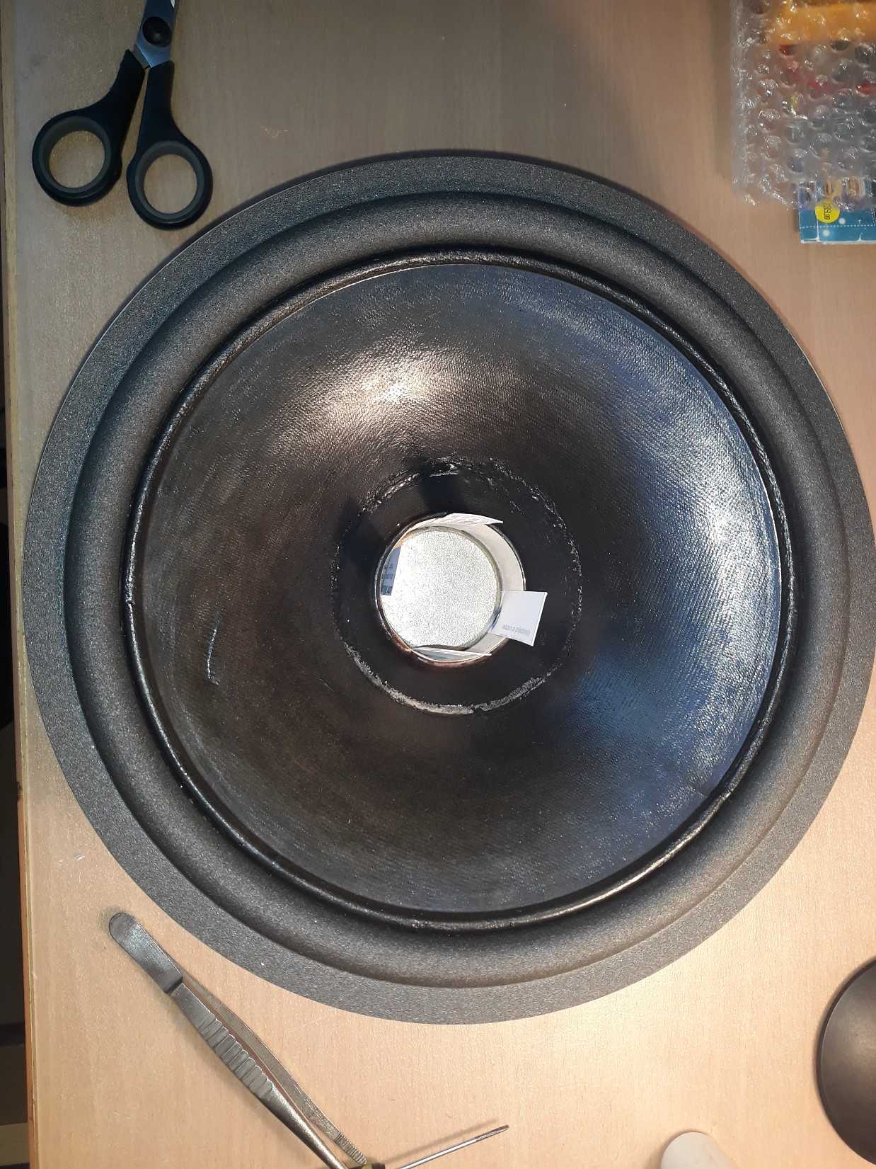

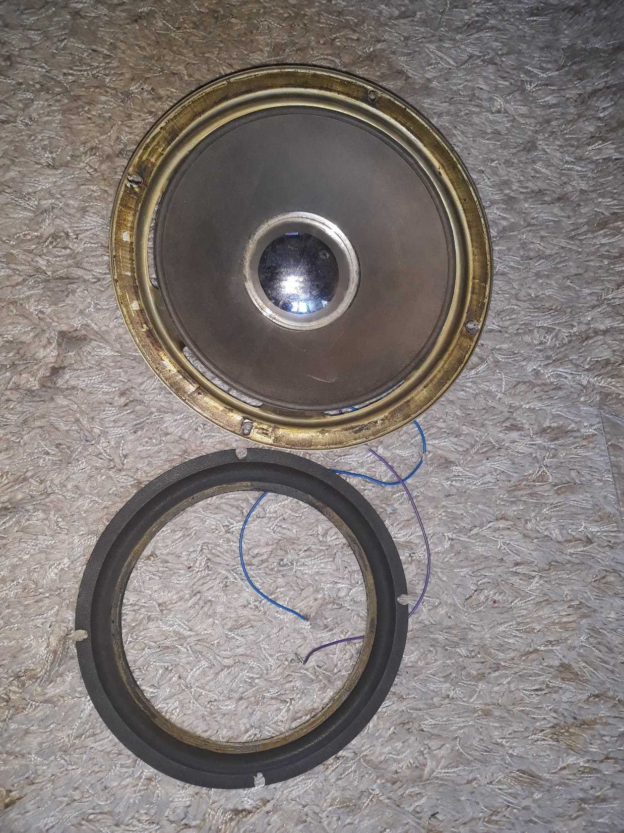

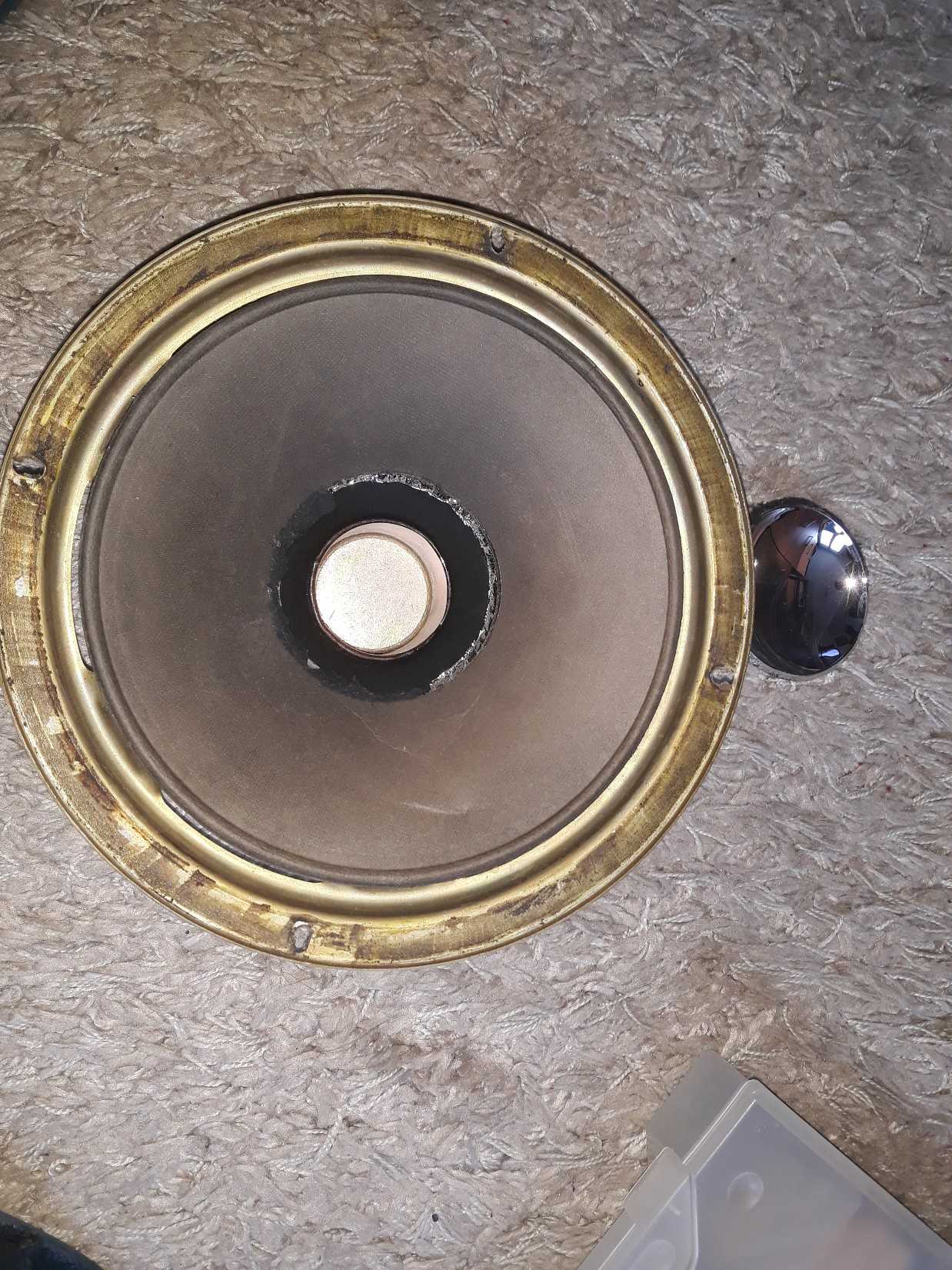

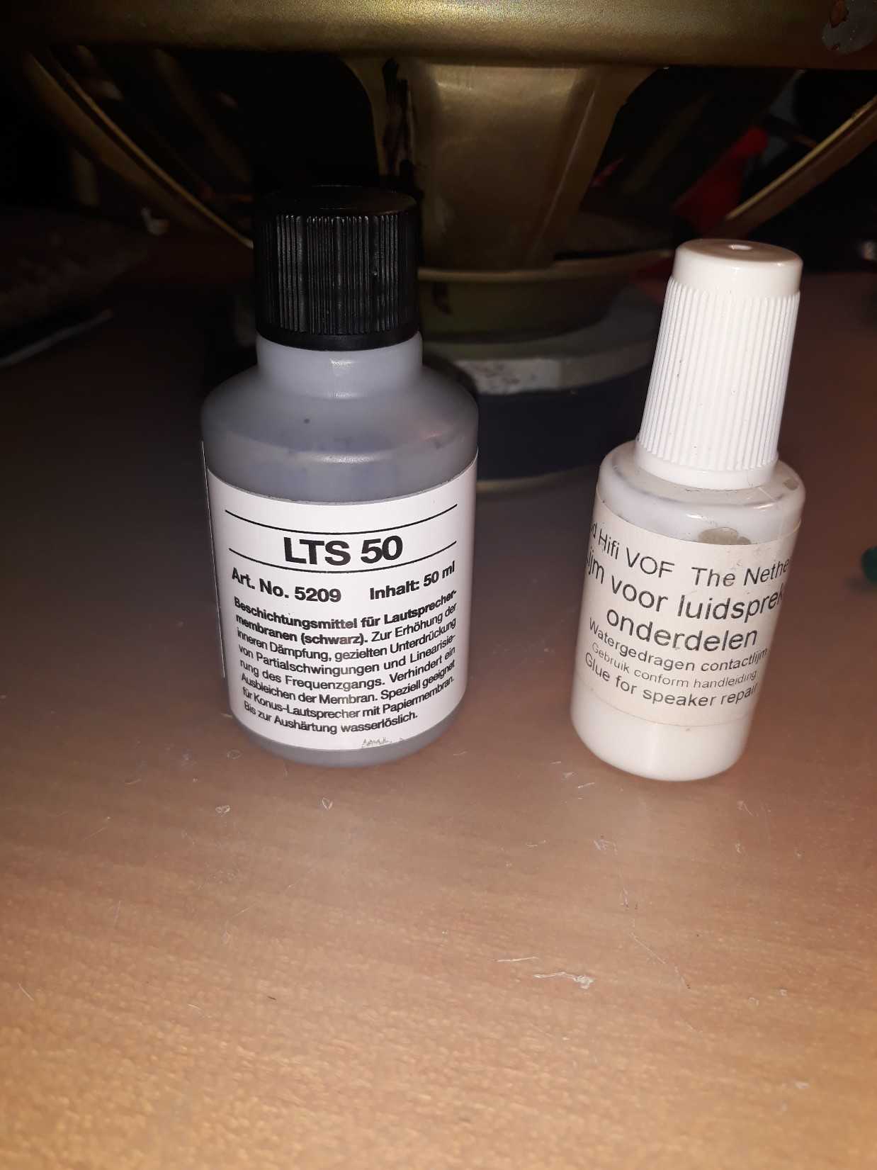

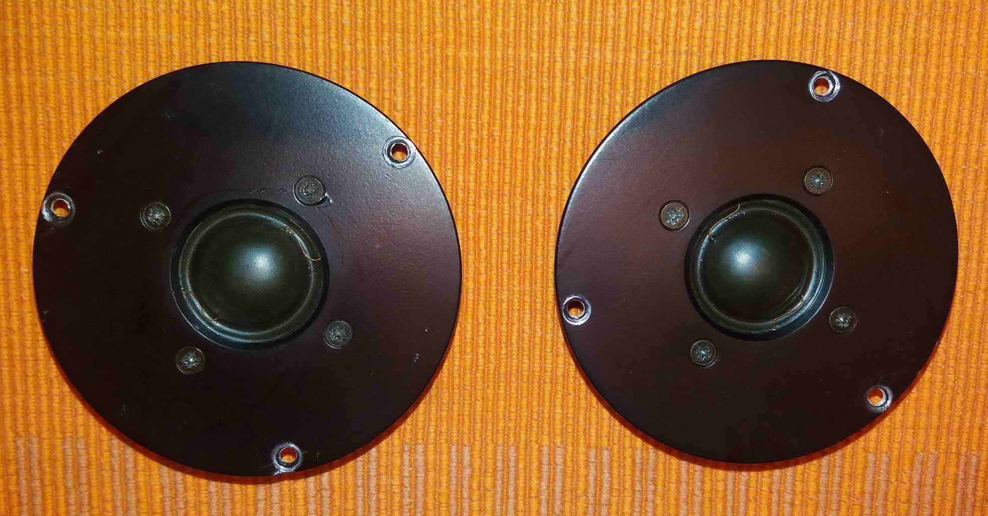

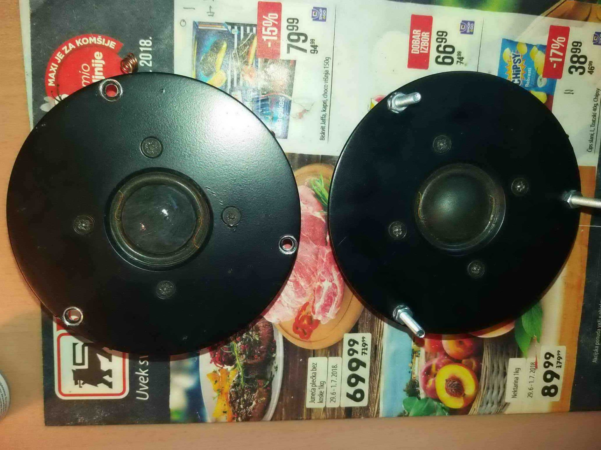

I bought Visaton LTS50 and coated some old paper membrane drivers with it to save them (two coats). I even coated a pair of Dynaudio D28 AFs (just one coat) and they worked nice after treatment. The original damping dried out due to age, and the ferrofluid was also replaced earlier. What is your opinion on that LTS50 membrane coating?

Some sort of glue, but this particular one is not findable on their website. What are its characteristics?
I use various “adhesives” to tweak drivers. Puzzlekoat/ModPodge (PVA), and ZIG 2-way glue (sort of like sticky noite glue). The first is used to coat paper cones, the second on the surround/cone interface on the back of thge Fostex and on the backside edge of whizzer cones (in general).
EnABLing takes things a bit further.
Yes EnABLing was very noticeable.
Puzzlekoat/ModPodge was exactly what I used. Thanks for not making it a secret.

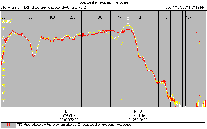

Coatings that stiffen the cone can have positive affects, but too much can kil the driver. Damar and C37 are examples of those. I will say that how C37n applies to the paper on a Visaton B200 or CSS FR25 is kinda surreal.
Just a matter of adding more or additional coating of what is normally
used.
Add too much, you tend to wipe out the highs. I have used that to advantage with woofers. On the CSS SDX7 it was a bit unexpected, turning the whoop at roll-off into a nice smooth roll-off extending the usualble respons eup to ≈1.7 kHz.
