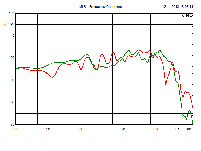

Not proof, but scientific evidence:
Green = Sica 8D1,5CS
Red = Visaton B200
Visaton B200 measured in custom-made OB loudspeaker with two 15" woofers for the low-end.
Sica measured in a cheap plastic PA loudspeaker enclosure, with raised edges and a ton of diffraction above 2 kHz. In spite of that handicap, Sica is better and with more extended frequencies above 10 kHz.

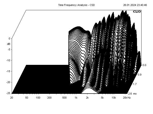

Waterfall diagram of Visaton B200. Ugly, long-lasting resonances, in spite of carefully designed OB loudspeaker.

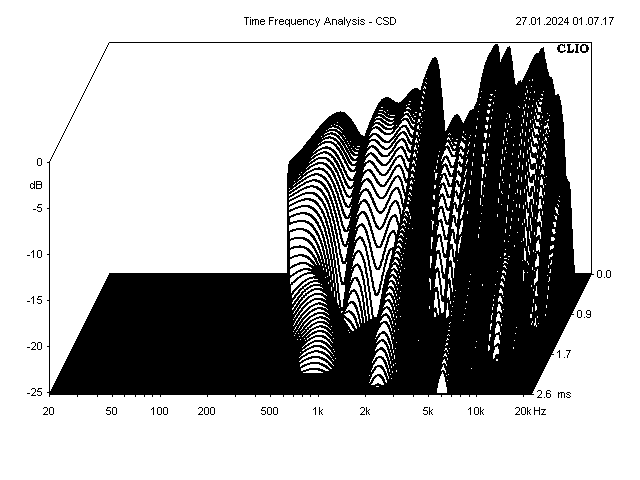

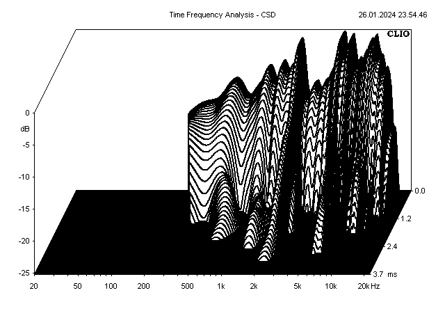

Waterfall diagram of Sica 8D1,5CS mounted in cheap plastic PA enclosure - much better than Visaton B200, with less resonances and shorter settling time.

A note on your graph:
visaton-red_sica-green-png.1265149
Besides being only an on-axis is shown: 500>1k>2k>4k>8000>16k. About the 5 top octaves. Most of the range of crucial fundementals not shown, and the “problem” areas only the top 2 octaves.

My graphs show what is the most important - multiple resonances and slow impulse decay of Visaton B200 at 1380 Hz, 2300, 3180, 4000, 5600, 7160, 8700 Hz and 14400 Hz, and dip at 1100 Hz and 12500 Hz. Enough evidence for a bad loudspeaker.
Frequency response below 500 Hz is not shown because there are no problems there.
