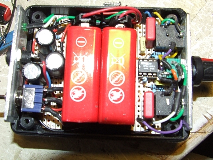

I finally managed to assemble and test the H.phone amp. The TLE 2426 blew up on the initial power up since the DC socket was wired incorrectly as shown in post 59! After rewiring the DC socket correctly and with a new TLE chip it worked very nicely with the +/- voltages at 12.03/12.04 respectively. There was hardly any dc offset on the ic outputs either!
It was surprisingly very quiet and worked well with both the batteries and the smps, albeit a little less bass. The head phones may have also played a part in this due to their fairly high impedance(s)
I wonder if I could either add another TLE2426 across v.e supply to increase the current capacity or use a BUF634 at the output?
The op amp i'm using is an OPA2132.

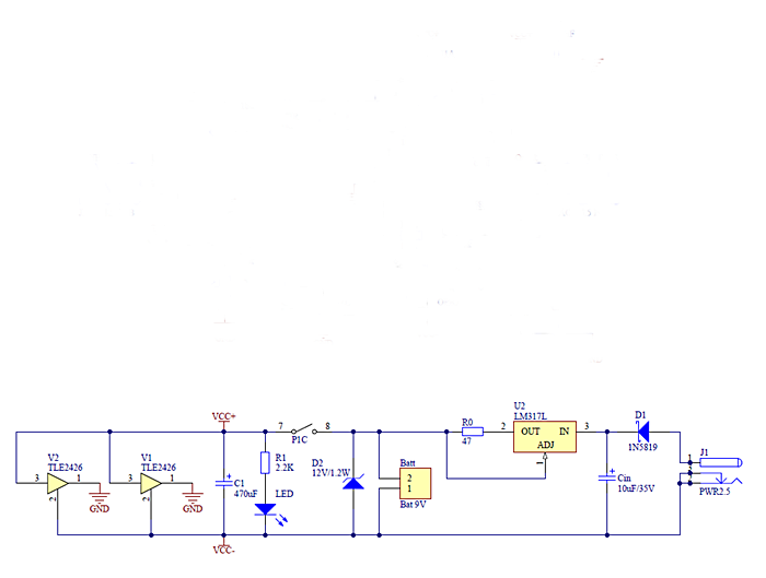

The attachment below is for a v.earth/charger circuit for another Cmoy h.phone amp, which prompted me to explore the possibility of connecting 2 x TLE2426!
Well, this unit isn't meant to drive h.phones over 16-32 ohms given the constrains of it's design.

No doubt it would 'work' although both devices would need to be identically matched.

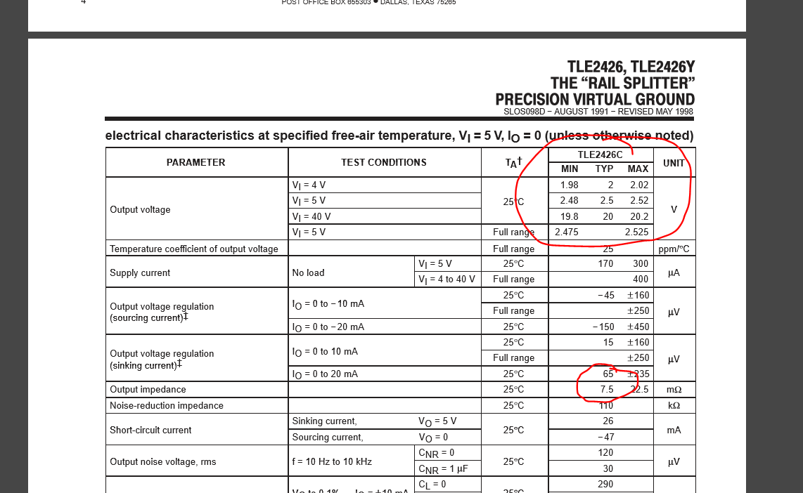

If you measure the voltage from -Vcc to gnd you should find it approximately equal to one of the supply voltage. If each device has a slightly different output voltage, and each device has a low output impedance (which I assume it has as that is the whole point of the thing), then the devices will 'fight' each other with one trying to force current into or out of the other.
Lets put some numbers in.
The data sheets shows typical values for output voltage. Worst case you could have 0.4 volts difference between two devices at 40 volts. On 18 volts lets be generous and say they are within 100 mv of each other.
The output impedance is given as being 7.5 milliohms.
How much current would try and flow between the two devices ? I=V/R = 0.1/0.0075 which is 13 amps. So the devices would just current limit and devour your batteries by fighting amongst themselves.

From your last post...."How much current would try and flow between the two devices ? I=V/R = 0.1/0.0075 which is 13 amps. So the devices would just current limit and devour your batteries by fighting amongst themselves. post
Thank you for pointing these as I didn't realize this w.r.t connecting 2 TLE 2426 in parallel! I'm not sure how this circuit was implemented in that Cmoy design! As for draining the batteries, I intend using a SPDT switch to select between these two voltage sources, so I hope this scenario doesn't arise!
