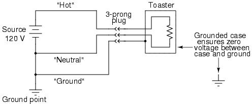

Actually wait a minute, there might be something here worth saying.
In the illustration, notice that neutral and ground are connected together. This occurs inside the breaker/fuse panel, it's not normally visible.
Since they're connected together, it's possible to have the impression that the neutral and ground are electrically the same, so either-which doesn't matter.
But no, it very much matters because of the hot feed. Notice that the hot wire feeds the neutral (so to speak), but has no connection to the ground wire.
The result is that neutral (white in the USA) is termed current-carrying, and can be a lethal hazard. Speaking only in the context of electronics, current flows in other devices can create noise and distortion.
In contrast, the ground conductor (green/bare) never carries current--or something's broken if it does--and is the universal zero.
While as before, any connection to the zero-voltage, zero-current ground conductor is correctly termed a "bond," he added in a resigned sort of way.

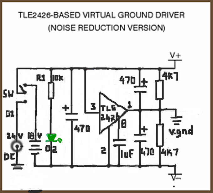

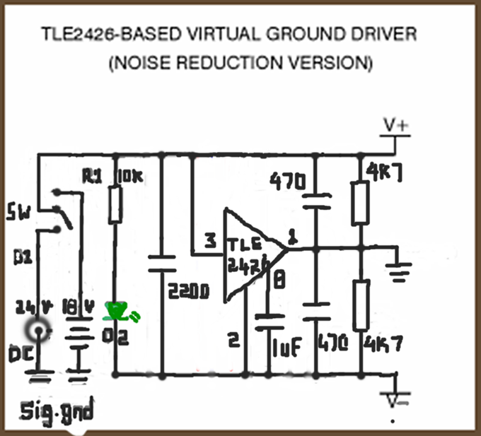

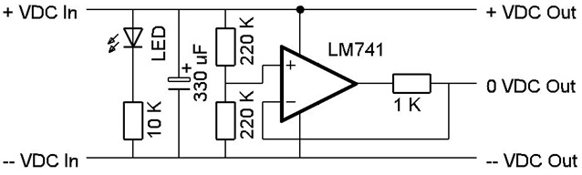

I've redrawn this from "Tangent Soft's" TLE2426 based virtual earth supply to take both 2 x 9v batteries in series and a 24v dc supply. I've incorporated a SPDT on-off-on switch to do this, thus avoiding using diodes in it's path.
I may have overlooked something! Can anyone spot anything missing or not right with this? Would this work?
Basically OK.
Theoretical rather than real practical issues might be the LED having obviously different brightness levels on the two voltages (use a current source or sink to eliminate that). Depending on the switch used it might be worth adding a limiter resistor to the supply exiting the switch to prevent arcing from abruptly trying to change the voltage across a 2200uf + 2 series 470uf caps.
Mooly, thanks for the tip. I don't really mind different brightness, since the battery/dc voltages too are different at 18v & 24v respectively. I'm a bit lost on your suggestion, how do I connect it and what value should that be?
Thank you AndrewT for pointing this out, an oversight on my part!
I wonder if the 2200uF cap is an overkill? Can I use, say a 220uF/470uF cap instead? What's the significance of using very high value caps on charging & discharging?
Is there any way of increasing the current capability on this yet avoiding another TLE 2426?
Thanks guys.
Thanks guys.
2200uf probably is overkill, certainly for battery use anyway. On mains and a lot depends on how clean the incoming supply is. The CMOY draws so little current that a series resistor of say 22 ohms might be beneficial. You could add that to the incoming 24 volt feed.
Modern LED's are very bright on currents of only a few hundred microamps so I would suggest first seeing what current suits the brightness you are after. Use your resistor initially to find out.

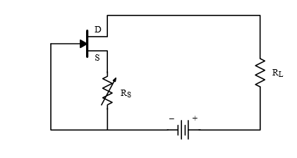

A constant current source (or sink) can be just a single FET wired like this. RL would be replaced by the LED. The resistor RS would be determined experimentally to set the current (brightness) and that would then be essentially unchanging with supply voltage. Something like a J111 or J112 FET should be suitable.

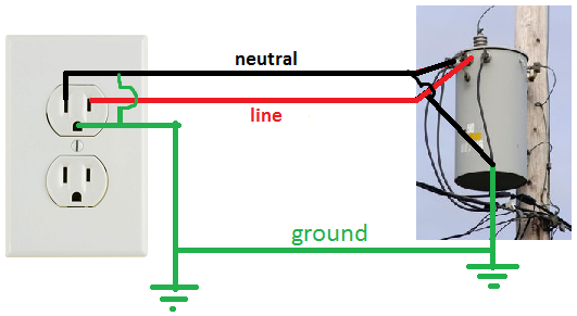

Old question, but important to understand.
The ground is only for conducting a ground fault current. Without it, a fault current could be conducted to ground through a user of the device. In the old days, sometimes you would get a shock from the refrigerator. With a three wire (grounded) plug, this is much less likely. If all loads are operating correctly, there will be zero current through the ground wire.
The neutral is known as the designated conductor and conducts all currents to ground under normal operating conditions. Although nominally at zero volts reference, there can be a voltage on the neutral conductor and it can be a dangerous/fatal voltage if there is a high resistance junction or wiring fault. This is just one reason why you shouldn't play around with the house wiring unless you know exactly what you're doing. Just turning off the circuit you're working on can be very dangerous if there's another circuit using that neutral, because if you start disconnecting the neutral there can be full voltage on one of the neutral wires in the box. This was the very first hard knocks lesson I learned working as an electrician. I thought I was so smart and then ZAP from the neutral wire. Also, the neutral wire is not protected by a fuse, so if you wire the circuits wrong you can overload it. An open neutral is far more dangerous than an open hot.
The ground and neutral are bonded together inside the service panel. This is the only place they should be connected together.
Moral of the story: Don't mess with the house wiring unless you know exactly what you're doing. It is deceptively simple and many, many "electricians" really screw it up. I have a callous on my forehead from facepalming when I open the service panel and see the creative (dangerous) wiring inside. Just because it works doesn't mean it's safe. Keep your hands out of there! Leave it to a pro.
I have scars from burns, damage to my retinas from a flashover arc in my face, and damage to my corneas from white hot shrapnel exploding out of a service box. Be smarter than me.
