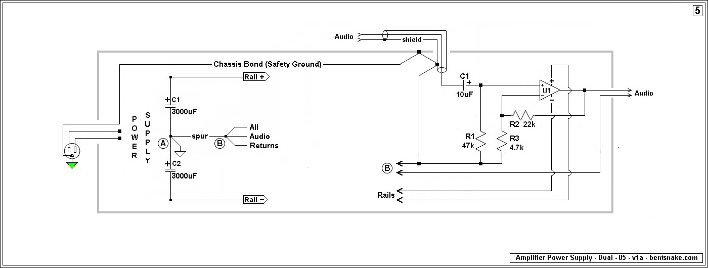

Does point 'A' also connect to the chassis? If yes, doesn't that create a ground loop? If no, what does the ground symbol refer to?
My bad, that illustration is part of a series (hence the 5), so it doesn't give all the information all by itself. The shown method is intended specifically to prevent ground loops.

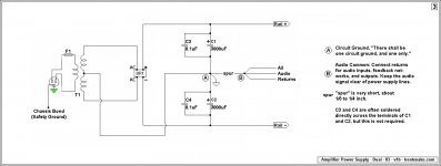

Point A is circuit ground, complying with the rule, "There shall be one circuit ground point, and one only." It does not connect to the chassis.
The "spur" is very short, perhaps 1/8 to 1/4 inch, approximately.
Point B is the audio common, to which all audio returns connect. It does connect to the chassis as shown, and is the bond for the circuit ground..
Make a distinction between grounding, which is the audio circuit, and bonding, which is the connection between the audio circuit and the rest of a building's electrical system, specifically the building's grounding system.
The small green triangle is the third prong of the power plug that goes to the wall. It's the audio circuit's single connection to the building's grounding system.
Why do we want this connection? Because...
All electrical devices having this third prong are thereby connected to the building's grounding system. In the case of audio equipment this means the chassis and cable shields of all are connected to the same grounding system (the building's), making them electrically the same point (at least in theory, and close enough in fact).
This prevents ground loops because ground loops are unwanted current flow in ground conductors. By making all ground conductors electrically the same point, current has no reason to flow (zero volts between points) and ground loops are prevented.
The chassis bond point is near the input connector because the incoming audio signal is the smallest voltage present (usually), and in any case obviously needs the most protection.

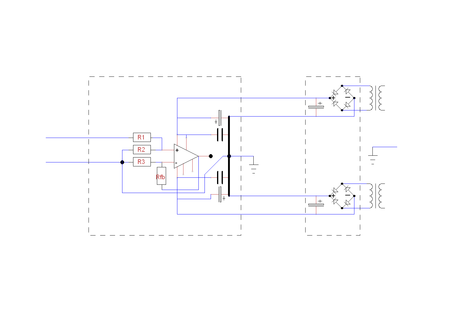

You can connect the ground on the underside of the board at the output ground (see Audiosector build guide) or split the ground lead into two and connect to both of the power grounds.
That was for a single channel. For two channels create a star ground between the boards, here you can connect short leads to the +/-power grounds or output grounds.
Just skip all that A and B stuff. Chipamp.com have done that for you already, its on the board.

This is my fault for not respecting what you didn't know. For the benefit of future Google generations.

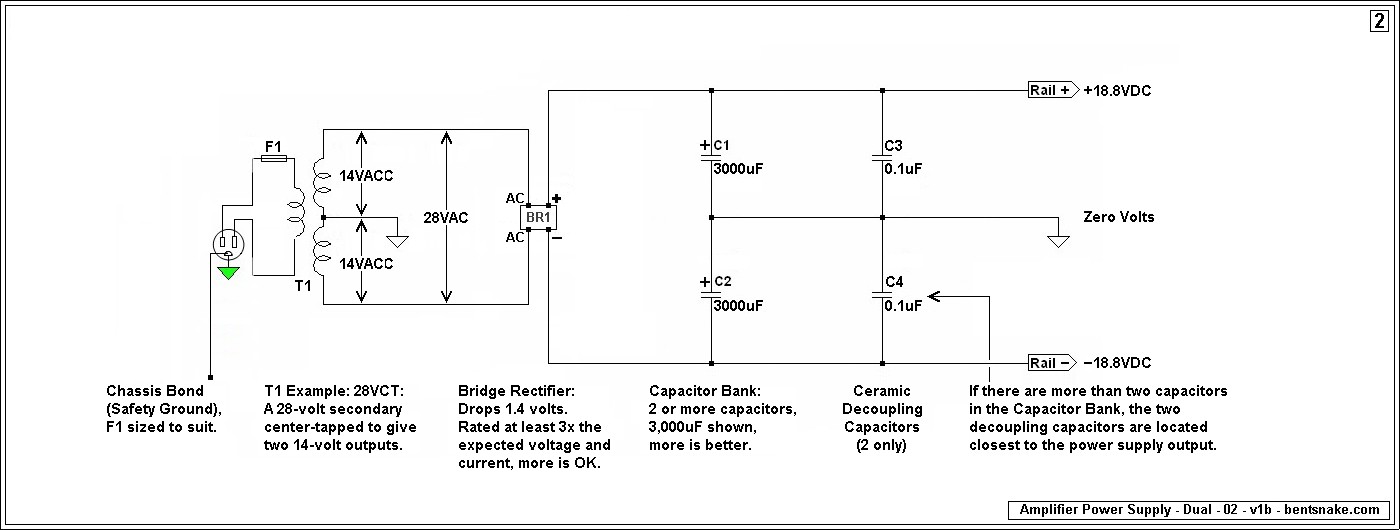

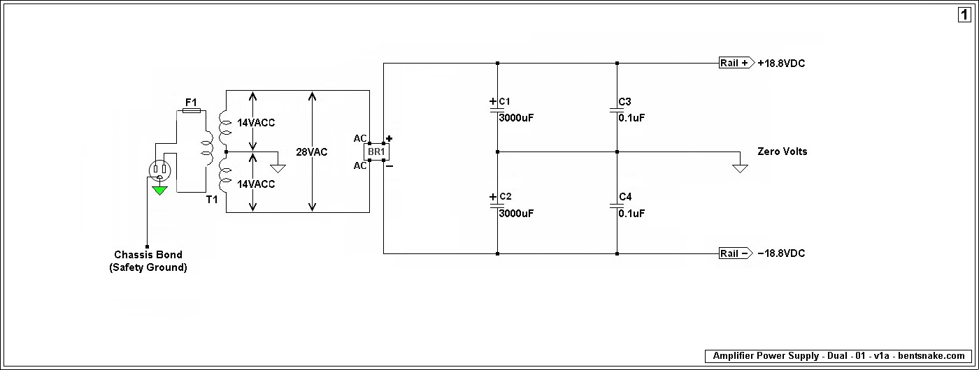

Figure 1 is simply the usual schematic for a power supply. You're supposed to look at it and admire the simplicity of the concept.
Figure 2 is the same (literally) schematic, but with notes added that I hope are self-explanatory.

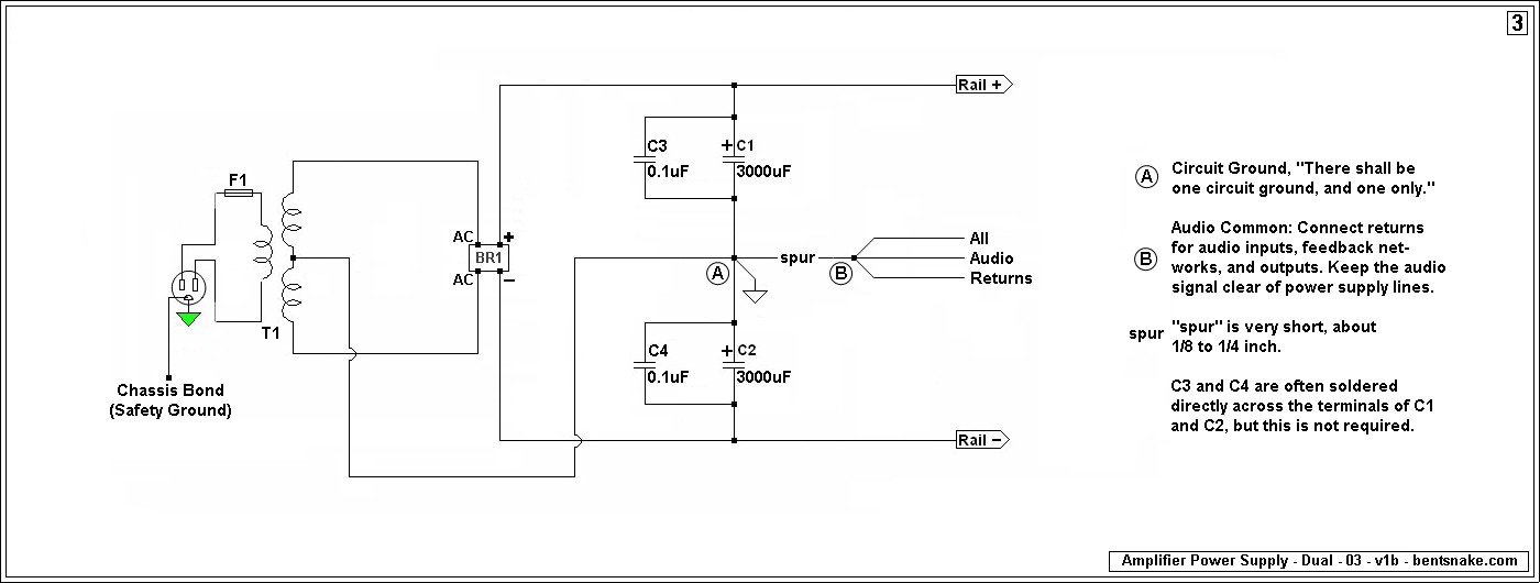

Figure 3 is electrically identical to the first two, but mechanically different because real-world wiring connections are shown.
Figure 3 is where the various this-grounds and that-grounds come in. All these different "grounds" seem to--and do--violate the rule of "one ground point, and one only." I resolve this conflict by referring to everything except the shown Point A as "commons."

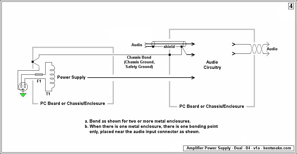

Figure 4 shows the chassis bond. This is also called chassis ground, safety ground, and probably a dozen other names.

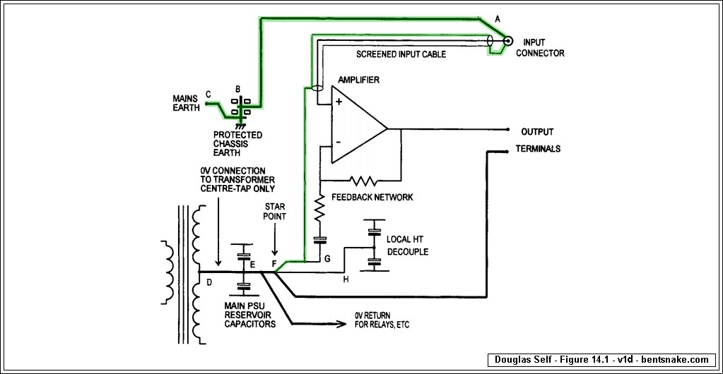

Figure 5 brings everything together--I hope--showing how the audio circuit connects to the power supply.

Perspective
One bonding wire, one chassis, one connection. Are we done making it complicated yet?
You're building, for crying out loud, a Cmoy. Chu Moy knocked out a li'l bog-simple circuit that's as bulletproof as such a thing can be. Jillions have been successfully built. The fact that you're building a grownup version of the thing doesn't change its basic simplicity.
Your original question that I replied to was, "...all the 'grounds' are accounted for, but NOTHING is connected to the chassis or EARTH. Where/how do I do that?" So in post #15 of this thread I posted an illustration of how the chasis bonding requirement might be dealt with.
I was answering that question, and only that question. And frankly, if you'd run the chassis bond as illustrated you'd have been long since done and happy. But no, you had to go and think.
Well, it was my li'l illustration that started all this thinking, and confused matters. So I guess it behooves me--still behooves me--to try to set matters right.
BUT be aware that your present circuit ground setup is fine. You said you had the circuit ground situation under control, and you do. This is partly because you took care, and partly because you cannot wire up a Cmoy the wrong way, because there is no wrong way. Some experts are going to want to argue about that, I hope they'll forgive me when I don't argue back.
So your circuit ground is fine, it's only the chassis bond that remains is question. So.

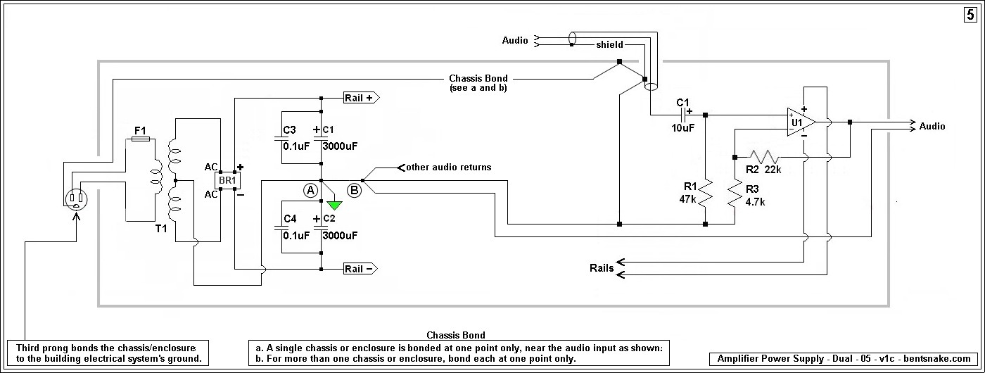

Possibly a Root Cause
Now I am more confused than ever. To be sure I have the right terminology,
A= Power Supply Ground
B= Signal Ground
Green triangle = Earth Ground and chassis connection to Earth
From there, I see that B is connected to chassis at the input socket. If A is NOT connected to the chassis at all, doesn't it mean that the 'default' ground path for A has to go through B to the chassis?...
...Not what I would think you want. I would have assumed that you would want the power supply ground to be connected to chassis (earth) and - perhaps - have the signal ground 'lifted' with a resistor/diode "loop breaker". (Note that this is not possible for me as the PCB joins Signal and Power gnds on the board.)...
...My knowledge is certainly rudimentary, but it is my understanding that in these things - perhaps particulaly for chipamps - you cannot ignore the resistance of the wires and assume that things connected are "electrically equal."
<< If A is NOT connected to the chassis at all, doesn't it mean that the 'default' ground path for A has to go through B to the chassis? >>
This might be a root cause of confusion. Fact: any current flow from the audio circuit to the chassis is exactly what you don't want. That is to say, if current is flowing from A (circuit ground) to the chassis, then something is broken.
The chassis bond is for shielding, and for safety. It has nothing to do with the audio circuit--or it's not supposed to.
<< perhaps...have the signal ground 'lifted' with a resistor/diode "loop breaker" >>
In my opinion ground lifts, loop breakers, and all their variations are sloppy workarounds that are dangerous (they undo the chassis bond), and probably illegal where you live.
For A and B reference I'm again posting my illustration 5 below. This illustration has been heavily revised based on your questions, so thanks for asking!

Douglas Self's by-now-infamous figure 14.1 is is not exactly self-explanatory, so I'm posting it again, this time with Mr. Self's comments. The figure and quote are from his "Audio Power Amplifier Design Handbook," pages 402 and 405.
If you're not familiar with Mr. Self, he's an audio guru of international reputation. Books, articles, lectures, the whole 9 yards. He says:
"...put the audio-chassis ground connection at the input connector, so in Figure 14.1, ground-loop currents must flow through A–B to the Protected Earth at B, and then to mains ground via B–C. They cannot flow through the audio path E–F...
...This topology is very resistant to ground-loops, even with an unbalanced input; the limitation on system performance in the presence of a ground-loop is now determined by the voltage-drop in the input cable ground, which is outside the control of the amplifier designer."
Mr. Self's point E is essentially my point A. His point F is essentially my point B.

The primary reason for grounding the amp circuit is safety. Connecting the mains ground/earth to a virtual ground is not going to accomplish that.

Maybe there's a third alternative. Maybe you just want to find some stuff out, but nobody has answered your questions yet.
<< It would seem to me that this breaks the rule... >>>
Er...maybe I should have emphasized. Any "rule" I give you is a rule of thumb, sometimes created by me, sometimes that I got from somebody else. The purpose of rules of thumb is to bypass the math and get on with it. I don't give out any rules any that I don't have confidence in. That is, personally have confidence in, for what that's worth to anybody.
<< I have never seen a "star ground" (point F) that was not connected to chassis as well. >>
Mr. Self's point F, and my point B, are essentially identical, and both are bonded to the chassis. I don't know what you mean by "as well." You speak of a star ground, as well as something else. As well as what?
It might be worth adding that "star ground" is high on anybody's list of misused terms. It's become nearly meaningless, any ol' jumble of wires might be called a star ground.
<< It would seem to me that this breaks the rule "one and only one connection..." >>
I don't know whose rule you're referring to, or what connection. Do you mean the chassis bond? Both myself and Mr. Self comply with the "one chassis bonding point" rule. This is indicated in both his circuit and mine.
After that, have you noticed how much conflicting advice you get around here? You've even been told that in this highly technical field you should follow no rules. So does it really surprise you that self-appointed experts scream you're-wrong back and forth at each other?
I counsel as follows: connect the bare--or third--wire to the chassis. Hook whatever you call ground to the chassis. It's a Cmoy, it will be fine.
Or if you want to listen to somebody, then pick an expert, any expert. Close your eyes and point. Then consult only with that person, listen only to that person. Otherwise your head will be swimming--as it is now--filled with conflicting theories. Any plan may be better than no plan, but you can't follow a dozen plans at once.
