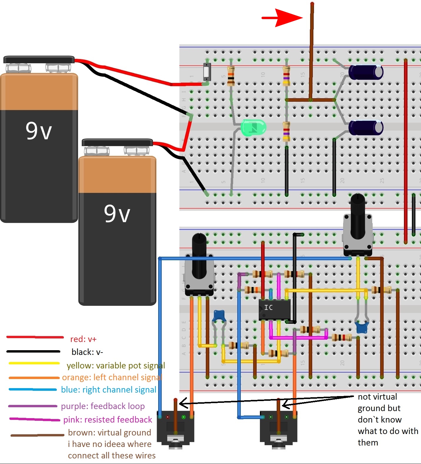

Hello guys, i`m trying to put together a headphone amp by using Tangentsoft`s approach ( http://tangentsoft.net/audio/cmoy-tutorial/misc/cmoy-tangent-sch.pdf ) but i fail to understand how to wire the virtual ground. I just can`t figure out where to connect the wires. I made a Fritzing design of where i am now. If anyone could tell me what to do with the wires hanging around in the picture( https://dl.dropboxusercontent.com/u/45794359/amp_bb.jpg ) i would really appreciate it. If someone finds any other mistakes please feel free to point them out.
I am also using a virtual ground, but on a much larger scale in an effort to 'rehab' a dynaco ST-120. (I also did one using 'updatemy dynaco' circuits, but for this one, I want to use chipamp.com's LM3886 boards, thus the need for bipolar ps.) So, I created a simple regulated PS using a virtual ground created off the diode bridge with two big resistors followed by two big capacitors followed by a simple regulator using IR240/9240. (I am traveling and do not have the ability to scan and post a schmatic, sorry.)
Anyway, my question is: how to manage the grounds? The ST-120 does not have a third wire power cord, but I'm not sure that makes a difference and I may add one. The chipamp board connects Input gnd, Output gnd, and Power gnd (+ and -) to the same fairly large ground plane. My plan would be to run twisted pairs for power +/gnd, powr -/gnd, input +/gnd, and output +/gnd, all isolated from chassis. The question then becomes WHAT/WHERE do I connect to chassis? My thought would be to use a heavy wire from the virtual ground on the PS board to chassis with no 'loop breaker'. Since signal and power gnds are connected on the chipamp board, I cannot 'lift' the signal gnd from the chassis unless I 'lift' the PS as well which strikes me as a bad idea. Of course in its present form, the chassis is not, itself "grounded" since it only has a two wire power cord.
Coments/advice welcomed!!

What is wrong with using the centre point of the batteries as ground?
In case you were asking a real--not rhetorical--question, nothing's wrong with it, it is ground.
To the electricians who wired your house, "ground" is literally that, it's the planet earth. There's a ten-foot rod driven into the earth outside and that's ground.
But in electronics "ground" is arbitrary. It's a point you define as zero volts, and then all voltage measurements are relative to that point.

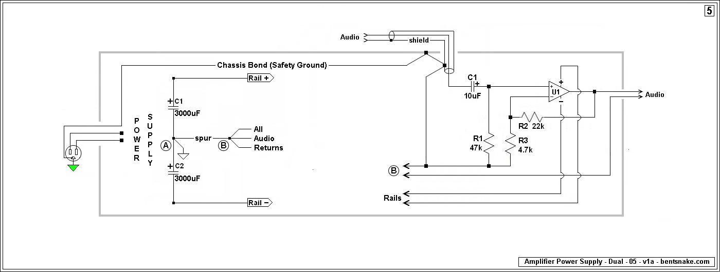

I won't claim to have read EVERY article on virtual grounds, but I have certainly read a lot. I have come up with a virtual ground that I am comfortable with (again, sorry, but I do not currently have acces to a scanner. I will post schematic when I can.) Anyway, the question I asked was NOT how to design a virtual ground or which design to use, but HOW/WHERE to connect it both to the chassis and to the specific chipamp.com board. On the chipamp board, there are attachment points for FOUR grounds (V+/G, V-/G, Sig In/G, Sig Out/G) all of which are joined in a large ground plane. My plan is to use ALL FOUR , using twisted pairs. Now at this point all the "grounds" are accounted for, but NOTHING is connected to the chassis or EARTH. Where/how do I do that?
...all the "grounds" are accounted for, but NOTHING is connected to the chassis or EARTH. Where/how do I do that?
Here ya go. Note that the correct term for a connection made to a building's grounding system is "bond," so that's the term I use here.
All bonds ultimately connect to the building's grounding rod driven into the earth that I mentioned before. Quite distinct from the "ground" used in electronic circuits.
In the illustration, the chassis bond point (one and one only) is shown as being very near the audio input, and connected to the input shield. This is correct.

Does point 'A' also connect to the chassis? If yes, doesn't that create a ground loop? If no, what does the ground symbol refer to?Here ya go. Note that the correct term for a connection made to a building's grounding system is "bond," so that's the term I use here.
The green triangle symbol is a mechanical and permanent connection to Chassis.Does point 'A' also connect to the chassis? If yes, doesn't that create a ground loop? If no, what does the ground symbol refer to?
The triangle symbol next to point A is a mechanical connection to Chassis.
The first is to comply with:
the Protective Earth must be permanently connected to Chassis.
The second is to comply with:
All exposed conductive parts must be connected to the (protected) Chassis.
Note that this diagram makes the same mistake as described in post36
http://www.diyaudio.com/forums/chip...-grounding-methods-designs-2.html#post4242368
The screen if also acting as Signal Return MUST stay close coupled to the Signal Flow over the whole route of the two wire connection.
If a screened twisted pair was used as the signal input then the two twisted wires carry the signal into and out of the amplifier. The screen is then correctly tied to Chassis at the entry aperture.
Bent's diag omits the necessary Close Coupled Return wire.
