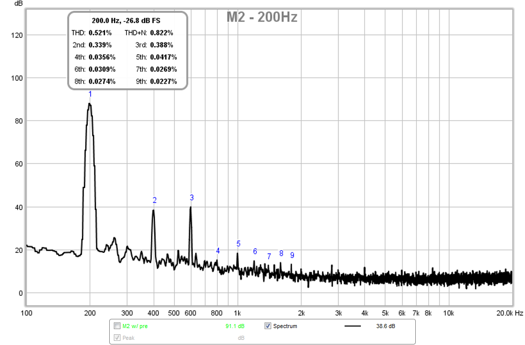

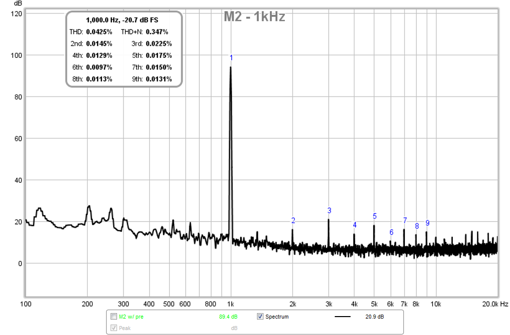

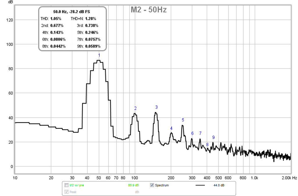

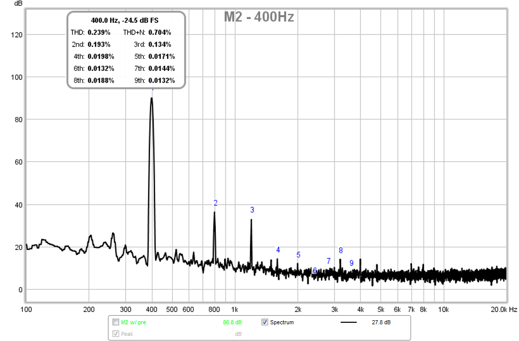

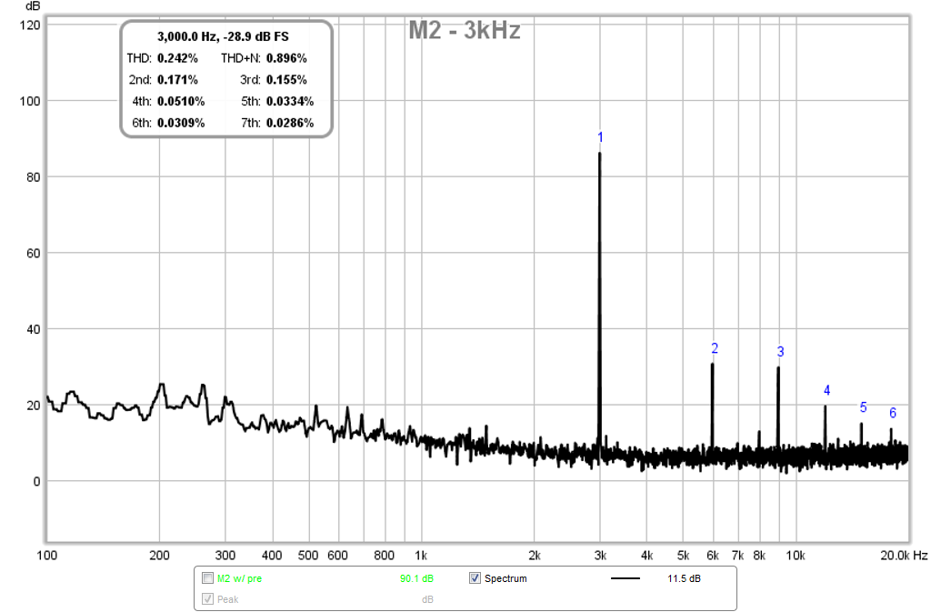

Let's take a look at the harmonic structure of the M2 at 50Hz, 200Hz, 400Hz, 1kHz, and 3kHz. The H3 is rather prominent.
50Hz:
200Hz:
400Hz:
1kHz:
3kHz:

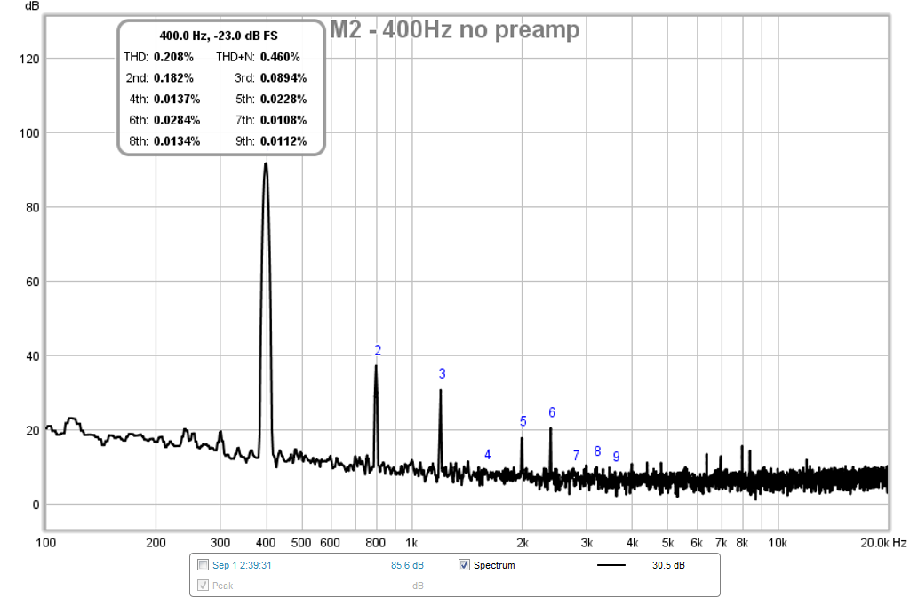

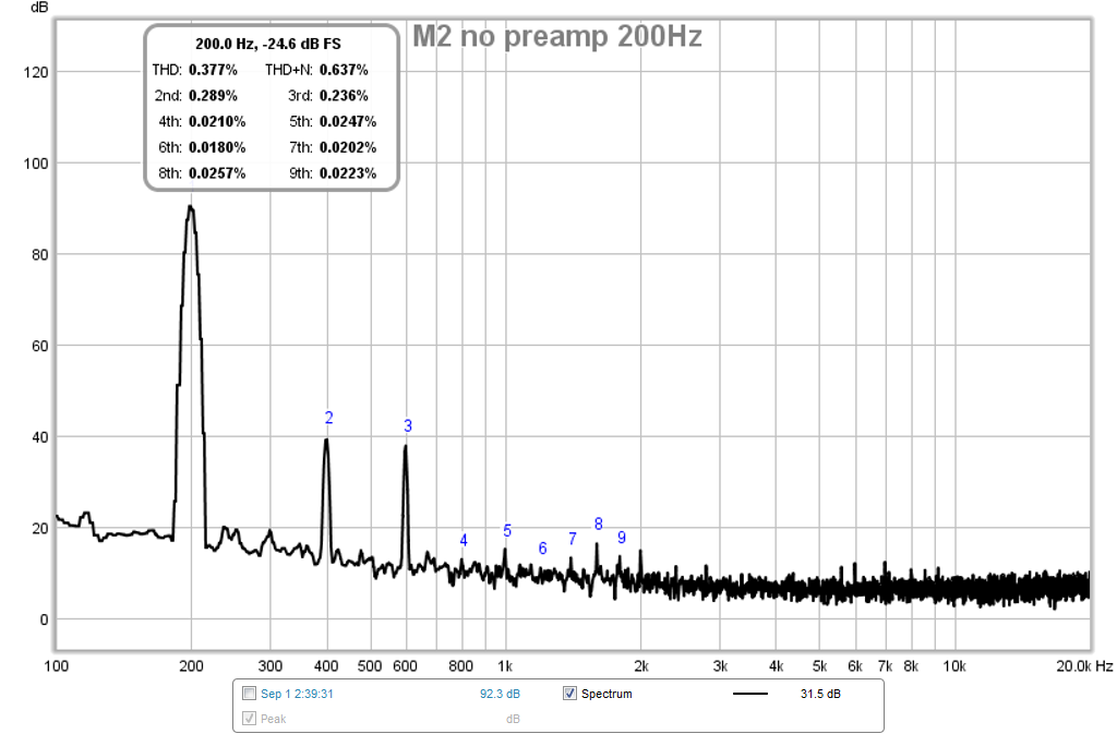

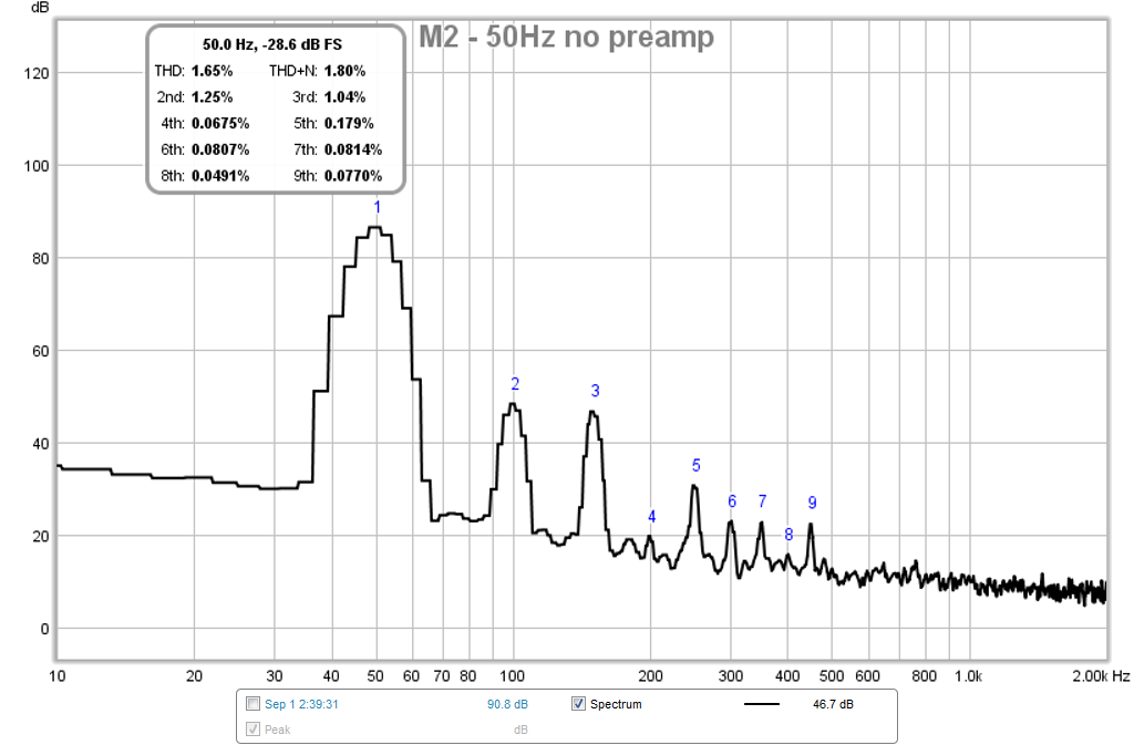

I removed the preamp and looked at the RTA and get about the same thing. Here is 50Hz, 200Hz, 400Hz:
50Hz:
567556d1472712916-virtual-audition-very-simple-quasi-mosfet-amp-m2-rta-50hz-no-preamp.png
200Hz:
567557d1472712916-virtual-audition-very-simple-quasi-mosfet-amp-m2-rta-200hz-no-preamp.png
400Hz:
567558d1472712916-virtual-audition-very-simple-quasi-mosfet-amp-m2-rta-400hz-no-preamp.png
And here is clip 3 re-recorded without the preamp at max volume. Then I really had to apply gain in Audacity to produce a -3dB below full scale sound file. You will hear hiss but see if the fatigue goes away?

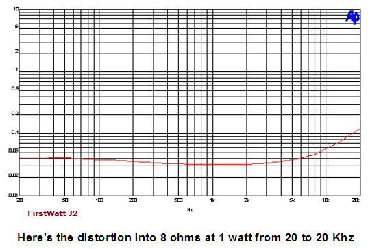

When you say it's extraordinary, does that mean it is high or low or a special siganture?
I was talking about First Watt's J2 Power JFET amplifier. The JFET version is a lot better than the IRFP240 version, but my version of using another HEXFET was good. But now I remember that J2 has actually LTP input (so no wonder the distortion is lower than M2)
Still fatiguing, same signature.

I'm really trying here to give the M2 a fair shake but H3 is not improving down in the bass and mid bass region. I only measure 50mV ripple on PSU at amp. Not sure if big 33mF caps are going to improve this much. I do hear the distortion in listening sessions. It's about 1.5% THD at 50Hz and 90dB at 0.5m. Will report back once I get new caps for PSU.
Uhmmm... sorry (for not following carefully), this distortion, is it measured at amplifier output or at speaker output?
At speaker but the H3 hump with M2 is not there on other speakers. Look back at same distortion plot of CFH7 for example. I am still trying to build an amp measurement rig. Right now it's all audio from a mic. If perceived at the mic it's pretty much huge at the amp.
Over in the M2 thread there are many folks who say it sounds like a tube amp and they don't mind the H3 distortion. It depends on what sounds you are after. I am now seeing how many of the very simple class AB designs can pretty much compete head to head, and even beat a much hotter running pure class A design.
