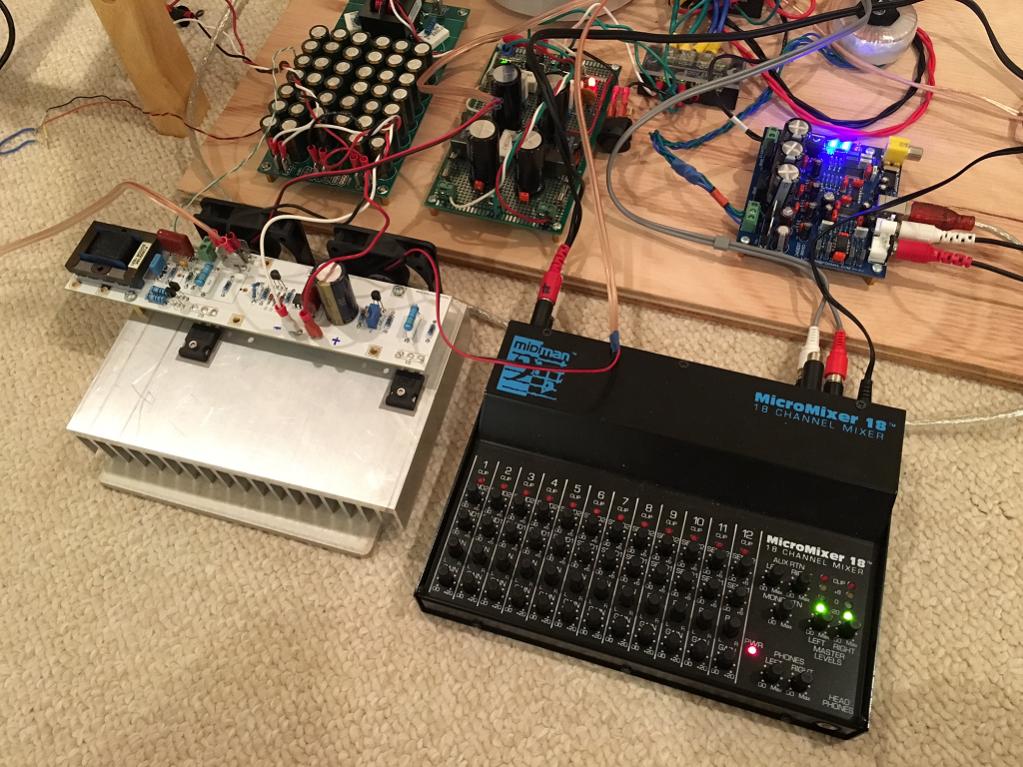

I got the DC offset problem sorted out with change of R7 to 53.5k + 3.3k for 56.8k and range works well so pot can go positive or negative around 0vdc. I also changed the main 10uF DC blocking cap that sits between the autoformer and the output stage to be the same as what I use on the other amps: a no name 10uF 50v MLCC and a CBB 1uF 450v MKT bypass. I did not want a difference in coupling caps to be a cause of sonic differences. However, I could not keep the signal chain identical as Pass amps are typically 14dB gain. This one is no different and my DAC simply cannot drive a volume greater than about 85dB. I added a fairly transparent pro-grade preamp (midiman micromixer 18) via an 18 channel mixing console with gain. Now I am getting some nice appreciable volume and bass that can be felt. In anycase, you will hear sound clips that are not of an identical signal chain as previous clips. Maybe I have to re-record at least one other amp so you can get a sense what sonic impact this has. Measurements show it is transparent with no real added HD or change in frequency response.
Here is a photo of the setup:
I won't show measurements yet as to not bias your listening impressions.
![567400d1472626763-virtual-audition-very-simple-quasi-mosfet-amp-m2-build-03-pre-amp-test.jpg](https://www.diyaudio.com/forums/attachments/solid-state/567400d1472626763-virtual-audition-very-simple-quasi-mosfet-amp-m2-build-03-pre-amp-test.jpg)

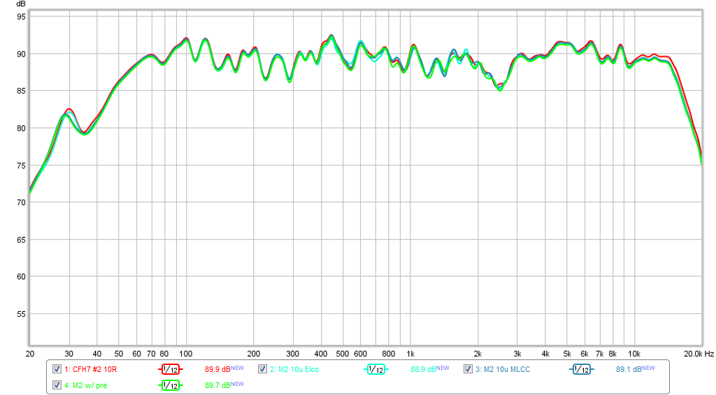

Here is measured response vs CFH7 with and without pre-amp:
![567416d1472633316-virtual-audition-very-simple-quasi-mosfet-amp-m2-meas-fr-compare.png](https://www.diyaudio.com/forums/attachments/solid-state/567416d1472633316-virtual-audition-very-simple-quasi-mosfet-amp-m2-meas-fr-compare.png)

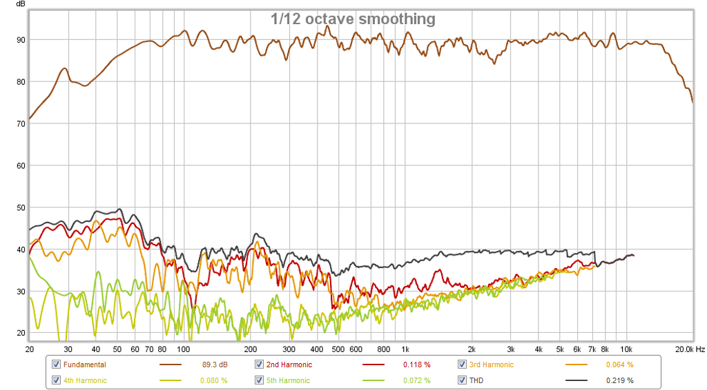

Here is measured harmonic distortion, note increased level of HD in bass region vs previous amps and also a bit more 3rd harmonic bumps:
![567417d1472633316-virtual-audition-very-simple-quasi-mosfet-amp-m2-meas-hd.png](https://www.diyaudio.com/forums/attachments/solid-state/567417d1472633316-virtual-audition-very-simple-quasi-mosfet-amp-m2-meas-hd.png)

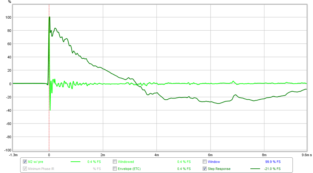

Here is measured impulse and step:
![567418d1472633316-virtual-audition-very-simple-quasi-mosfet-amp-m2-meas-ir.png](https://www.diyaudio.com/forums/attachments/solid-state/567418d1472633316-virtual-audition-very-simple-quasi-mosfet-amp-m2-meas-ir.png)

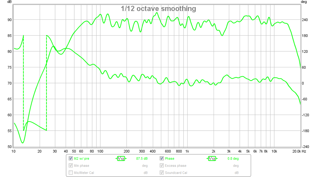

Here is measured frequency response and phase:
![567419d1472633316-virtual-audition-very-simple-quasi-mosfet-amp-m2-meas-phase.png](https://www.diyaudio.com/forums/attachments/solid-state/567419d1472633316-virtual-audition-very-simple-quasi-mosfet-amp-m2-meas-phase.png)
