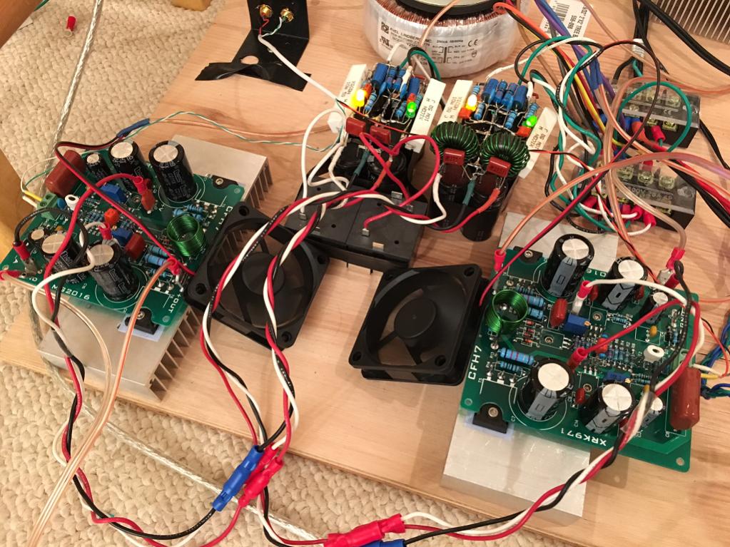

My new amp finally works after spending a couple of days troubleshooting. Turns out I made an error on one resistor that is now fixed. This amp sounds real nice - I really am liking it so far. More info on this amp here:
http://www.diyaudio.com/forums/solid-state/294834-cfh7-amp.html
Playing in stereo:

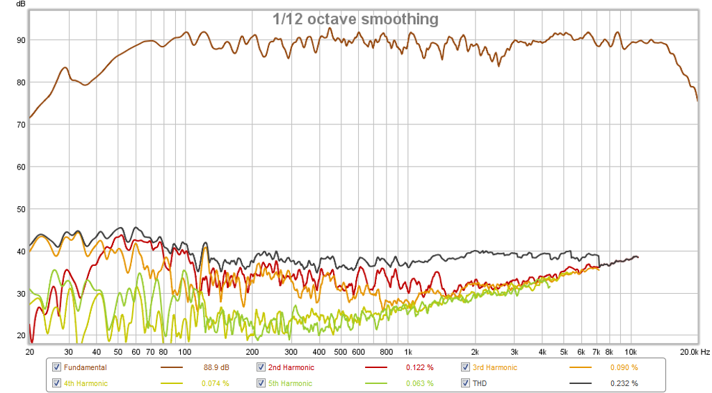

Measures very flat and with low distortion at the speaker:
Attached are the usual 3 sound clips. As usual, change the .asc extension to .mp3 to listen. Playing with 170mA bias current.

Jay,
So what do you think of the CFH7?
Jay,
Alright, so I have compared some clips (at home) with cheap speakers with no bass (I started with the laptop's internal speaker and then a Nokia earplug).
Played the CFH7, and my initial impression was that the distortion is high. I didn't like the sound coming from the shouting ("honey child...") and the background piano. The laptop's internal speaker can show distortion difference, but not the earplug. There is a possibility that one of the clip is louder so it triggers the small speaker to reach clipping or cone breakup... If there is no problem with level difference, then CFH7 has high distortion, but this is all below my usual acceptable threshold.
Compared CFH7 with VSSA (because they are CFAs) and I couldn't decide because each has plus and minus. Then I found out that this VSSA is not the latest version! When I made a comment few days ago that VSSA had a WEIRD sound, that was with the first version of VSSA. Indeed, today I found it weird...
Compared CFH7 with VSSAb (the latest version). It is obvious that CFH7 is too "soft", having less "resolution", as if having small dynamic, i.e. the contrast between the softest note and the hardest note is low. (N.B. At this point I know where VSSA was "weird" and VSSAb is not). Due to the better resolution, my preference goes for VSSA.
The CFH7 has neutral sound/vocal (better than circlophone), good rhythm (like circlophone). The distortion was not perceived with my earplug (may depends on the speaker used). The issue is only with it's "soft/thin" sound, which is not preferable.
Jay,
Thanks for the comments and careful analysis of the sound. Listening with cheap laptop speakers probably not the best way to judge. But based on my measurements, the CFH7 is one of the lowest distortion amps (as measured by effect on speaker distortion) that I have with only the JK VSSA having lower distortion. Interesting how you say it sounds soft. I will have to listen to the clips as only having listened to it live playing so far.

I'm familiar with the basic VSSA. If the distortion is lower than the FX8, I suspect there has been a "mis-design". We cannot lower the THD without giving up other quality parameter such as transconductance.
