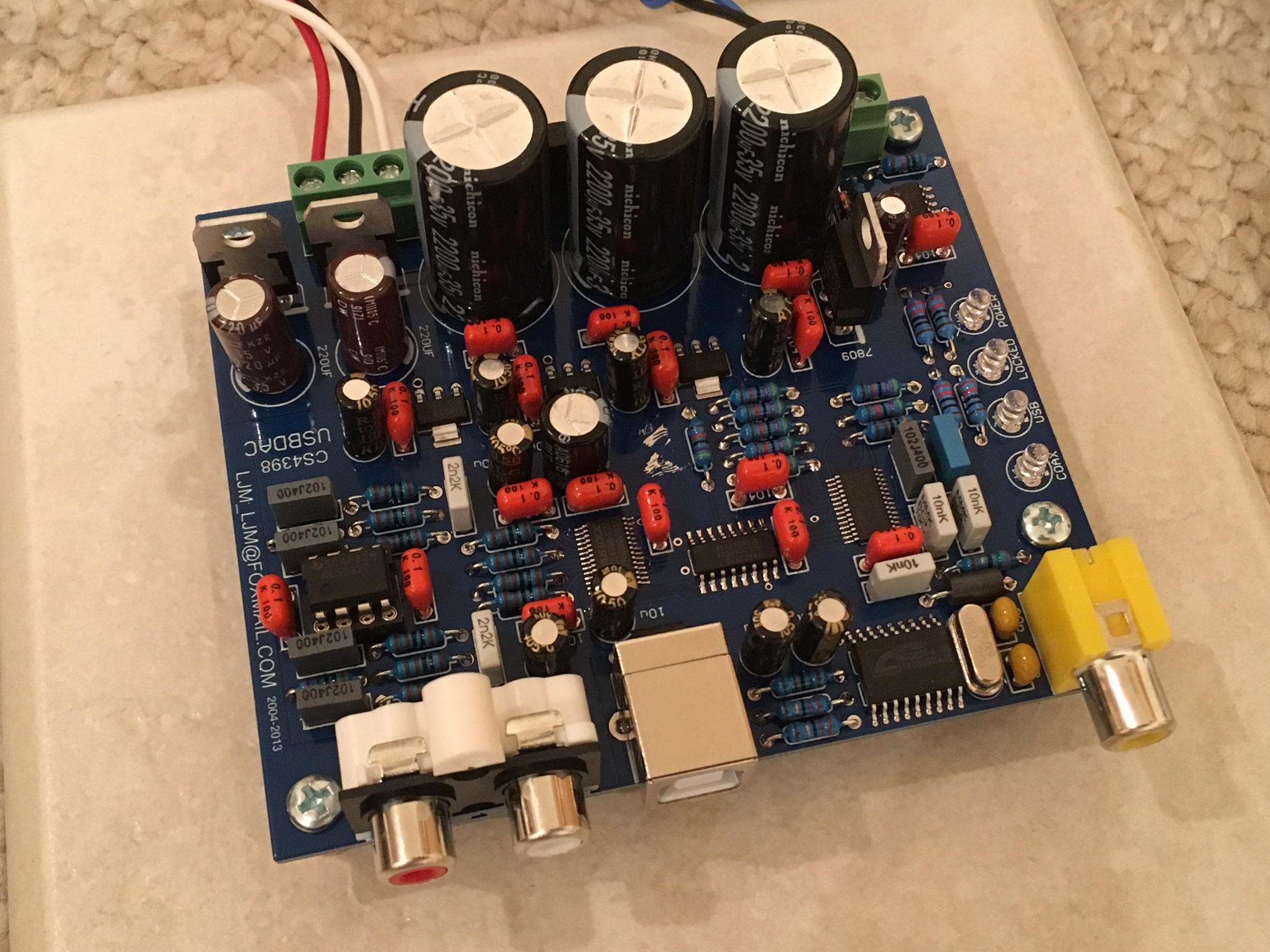

Suggest if your pre (CS4398 DAC) has AC coupling capacitor at output then for all these power amps bypass their input coupling capacitors. That would take out the difference sound signature that seems to be build into capacitor technology : )
Haha,
Now I need to look at the coupling cap used in the DAC output!
If it's what I suspect it is, those two little 10uF electrolytics near the right side of the RCA out jacks may be what is standing in the way of my audio grade cap Nirvana. 😀

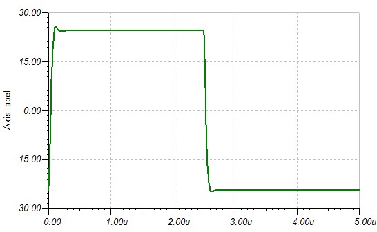

I think a combination of the step response plot and waterfall plot may prove more interesting there. I think an amp's ability to get a square wave right up to a higher frequency will impact dynamics because slew rate will give better attack reproduction.
I think so... This is my frustration 🙂 Difficult to analyze the frequency curve
And what I don't understand is the following thing: as far I remember (I am too busy now) REW does not play a random sample: it is rising gradually from lower frequency to upper frequency. So if my understanding is correct, it should be easy for an amplifier and a speaker to follow this line. But what is the response if the frequency suddenly jump from 100hz to 1khz? Is it possible measure that with REW?
I think you need a square wave generator and an O-scope to see if amp is capable of high slew rate. REW will give you derived impulse and step response from FFT which is worth something but not same as seeing a 100 nsec risetime on a 200kHz squarewave.
Here is predicted CFH7 response into purely resistive load on O-scope with 200kHz square wave.
