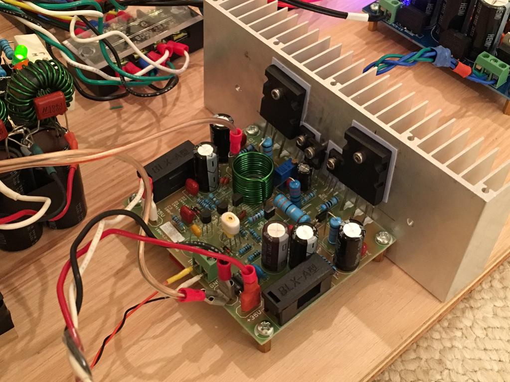

I'm adding another amp into the sound clip library. The Apex Audio AX11 Bimo mod, with layout by Prasi. I am runnung 100mA quiescent bias current with same 35v PSU used by the other amps.
Classic differential LTP input stage and complementary Toshiba 2SA1943/2SC5200 output stage.
Photo of unit 2:

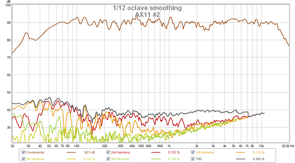

Measured harmonic distortion:
565698d1471675775-virtual-audition-very-simple-quasi-mosfet-amp-amp-comparison-all-freq-response-hd-ax11-bimo.png
I have not listened to it myself on headphones. However, I just put the Quasi back in for a test of some new IRFP240's that arrived in the mail (yes, the Quasi is my cheap Chinese MOSFET tester 🙂 ). The MOSFETs are good and furthermore - the amp immediately sounded better to my ears than previously installed AX11. Will have to listen on headphones next. But interesting comments so far.
i did gave a listen too for the three amps, AX-11, FX-8 and the Quasi.
quasi is slightly smoother through the entire range, FX-8 bimo mod is neutral and more "hi-fi".
AX-11 bimo mod sounds similar to FX-8, but has slightly pronounced drum beats.
**I havent read through the thread, just downloaded the clips where they are and gave a listen atleast 10-12 times, initially i felt there was no difference, but repeat listening gave the above observation summary. Does this correlate with your findings ? as you are the first hand direct listener to all the amps. We are the mercy of differences in head phones, laptop DACs, recording instrument etc, etc. Also some room acoustic effects might also get added to recording, unless you you have taken care of that **
** Just opinions, no preferential treatment to any amp, as I think XRK's three amps PCB have my layout design.😀.
