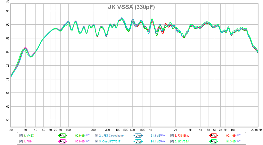

My choices of input filter may be a little more aggressive than some. Others seem to set the input filter fairly high, 1MHz+, where I set mine a little over 200kHz.
You mean C2? I just double checked and I have an incorrect value there, I misread 4.5nF for 450pF (actually qnty 3 x 152 caps). That would explain it.
Ok, I will install maybe a 330pF and redo the sound clips.

Well, being an order of magnitude off would explain the discrepancy for sure! You had the -3dB set at about 22kHz. If you thought the amp lacked anything on the high end then you definitely need to correct the input filter and retry. Even going down to 100pF would be fine, just not larger than the 470pF. Wouldn't want anyone getting the idea that those little amps weren't any good 😉.
JK VSSA Sound Clips (330pF filter)
Ok, my bad. That's the nice thing about the measurement - it turns up stuff like that we would probably not catch from a listening test. I removed the offending incorrect caps and replaced with the usual 330pF 1kV blue ceramic caps that are the staple here for RF suppression.
So here is the new frequency response, more in line with the other amps, but appears to have a little more bite in the higher registers - some would call "highly resolving"?

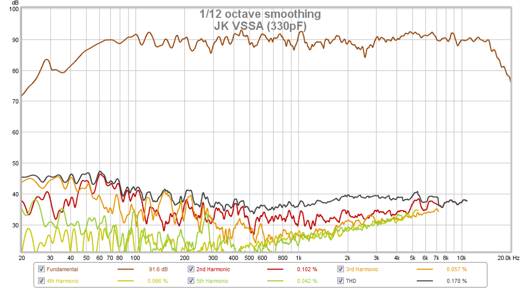

Here is the corresponding measured harmonic distortion:

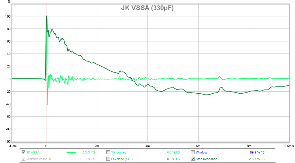

Here is the corresponding measured impulse and step response:
