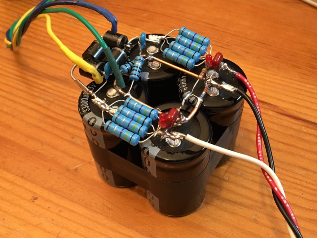

I built the recommended 4x33000uF CRC PSU for the M2. It did not change the distortion measured at the speaker but the soundstage is subjectively better. Wider better imaging.

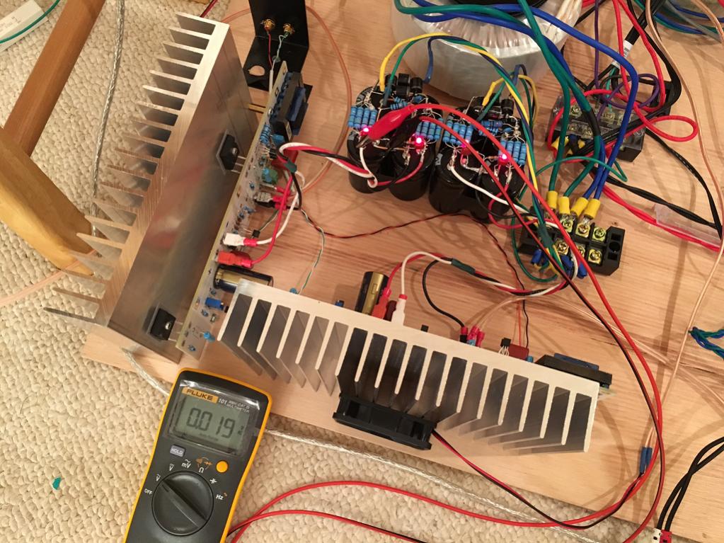

Here is closeup of the PSU made with P2P.
I guess it works pretty well as I get 19mV ripple when running at full class A mode with 1.3amp bias current.

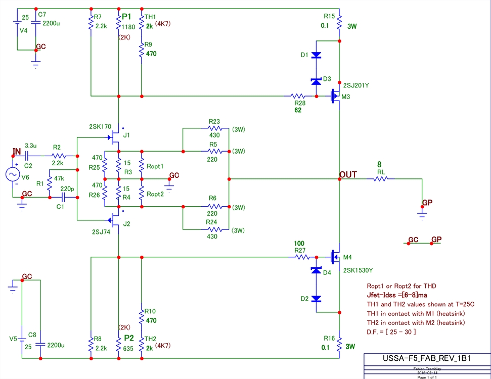

This one here (F5-USSA) is more similar to F5 but different sound signature (mainly use of output transistor designed for audio, different open loop gain, different close loop gain and more important a lower amplifier damping than stock F5). Find the complete schematics here: http://www.quebecdiy.net/t768-f5-avec-la-recette-ussa
For USSA-1 I wanted first to have good feedback on a small scale before releasing for large audience and control the build quality....So far, 4 out of 5 builders (excluding me ) are now using the USSA1- or -2 as their main amplifier in their system and report feedback even better than I had anticipated🙂
Since it uses an existing F5 pcb with important addition/modifications I had to create and provide a detailed build manual to ensure good implementation and obtain same results as I did ....
Of course it is just a different sounding amplifier and is class A so maybe not for all everybody 's need...Maybe it is time to share the complete schematics now..

No problem with that at all. I know 2 very good source for genuine parts and one of them is actually selling big quantity on this forum just Check the vendors bazaar thread....Good luck with finding the Toshiba output devices for your "F5-USSA".
I know that the other source have a few hundred transitors available..
Note that for the schematics , feedback resistors should be all the same value but I had not them stocked when I decided to build the amplifier...
Also R25/R26 were added to fit my standard gain of class A amp.
Fab
Are you having a board made just for this F5 variation or cutting traces/modifying existing Pass F5 boards?
Transconductance is too low, the overall open loop gain too low thus too low damping...bass too slow....How well can it work with the usual 2sk1058 and 2sj162?
Also, even in a follower type of output stage the indicated Toshiba one has its own sound signature which is more in-between the lateral one and usually used IRFP240/9240..
