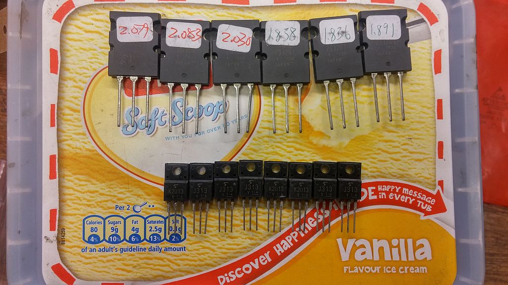

I hope it will be helpfull. Couple of years back I have bought a bunch of 2sk2013/2sj313 transistors on ebay, on the auction there was picture of the oryginal Toshiba packing box (hope it was ORI).
I allways dreamed to build sony 777es amp but I never did. I have checked Vgs voltage and it was approx 2,2V so seems to be OK. So on the pic bellow should be the ORI trannies.

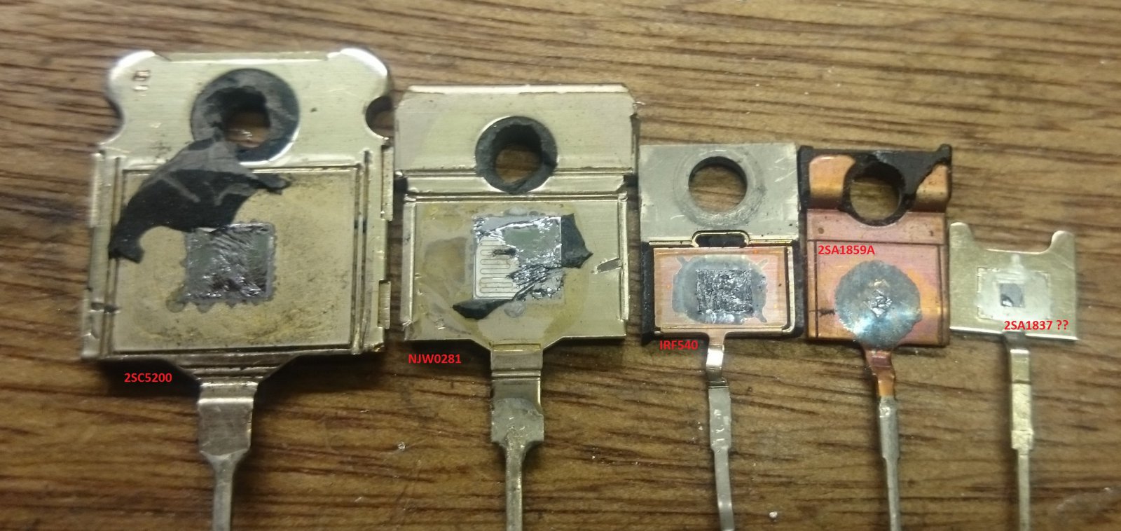

I have bought also a lot of IRF540/9540 transistors on ebay because they were cheap, and they are 100% fake, Vgs is approx 2,5V and after breaking the plastic off the silicon structure is very, very small. So it is a bit of a gamble to get good parts from ebay/alliexpres/dhgate etc.
I have opened a lot of transistors, maybe I will take a better foto someday and post all of them just for reference.

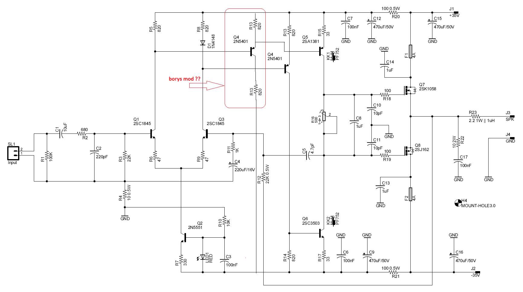

I have a small mod for FX8 for checking for you, the lower part of the VAS is already well buffered, by adding a few components you can buffer better the top side of the VAS too.
What would you think ??

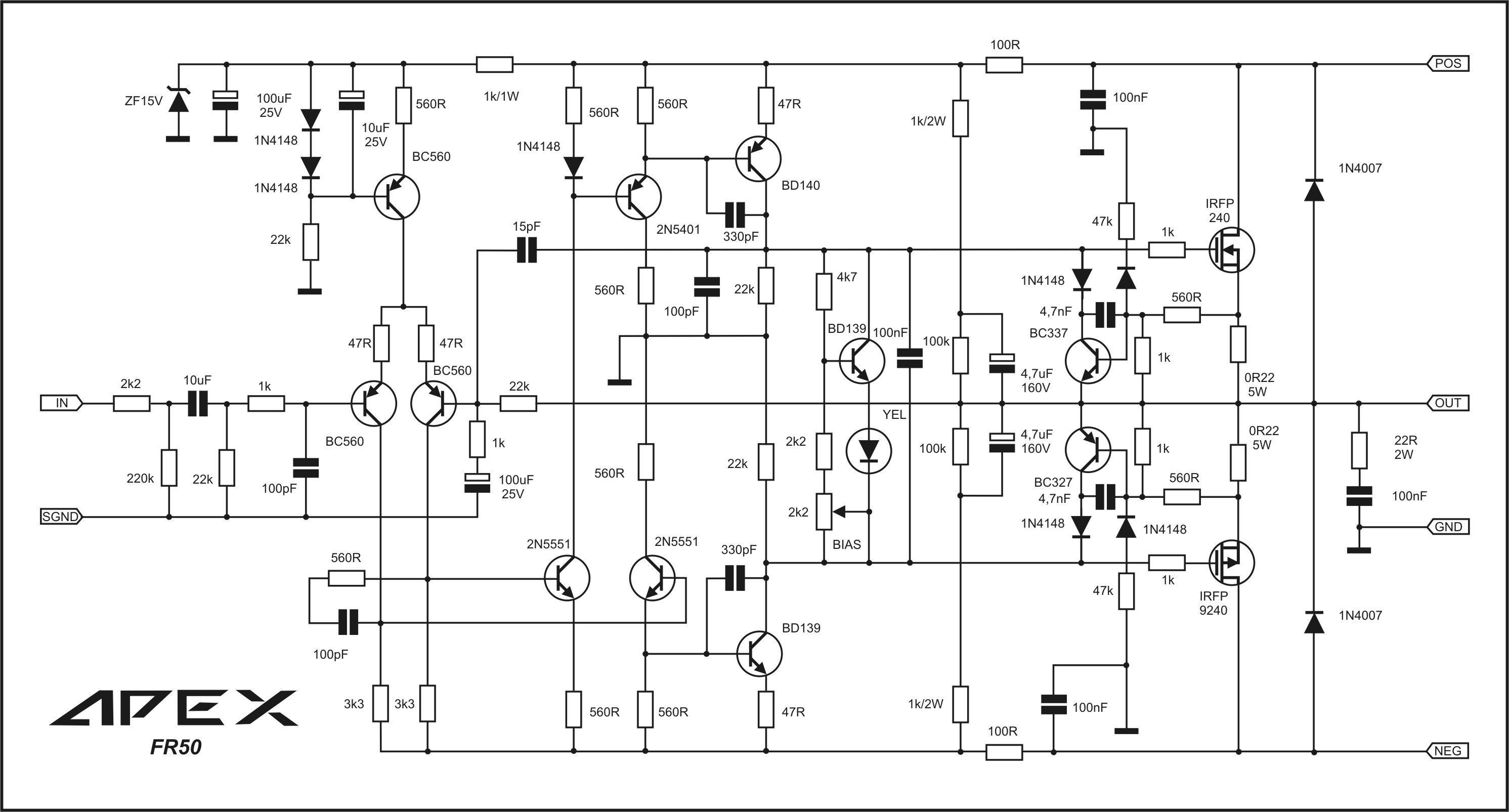

Current miror with 1N4148 must be remove to the negative side... like on FR50

Yes FR50 is new http://www.diyaudio.com/forums/solid-state/173462-studio-reference-amplifier-216.html
Ok. Nice design - but what does the BC327/337 at the outputs do?
Over current limit
