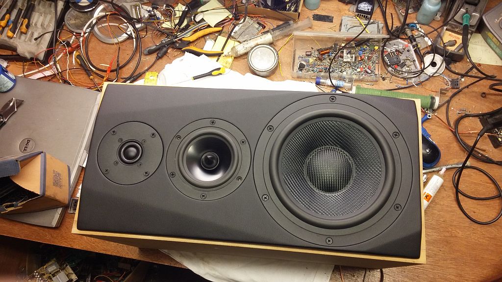

These are quite excellent drivers, still being value oriented but performance is generally accepted as one of the best at a reasonable price.
RS180P-8 about $52 ea. Dayton Audio RS180P-8 7" Reference Paper Woofer 8 Ohm
RS28F-4 about $55 ea. Dayton Audio RS28F-4 1-1/8" Silk Dome Tweeter
B80 about 54 Euro ea. Visatonshop | Fullrange Systems
The 3-way passive crossover will be about $40 ea (maybe a little less) in parts using no-name brand parts - basic Chinese CBB film caps, no-name inductors, no name metal oxide non-inductive power resistors.
Cabinet is whatever wood you make it with. I bought pre-cut MDF flatpacks for $80 a pair. Denovo Audio Knock-Down MDF 0.56 cu. ft. Bookshelf Speaker Cabinet
About $360 in pieces and parts. You can imagine how much a commercial speaker with parts of this level of quality and design would cost. Maybe $5k?

Very tasty looking speakres. IMHO good You are going for 3way !! I have made several 2way monitors and there was allways something missing there. With 3 way there is way more flexibylity in design. RS drivers are very good (rs125 is my favorite one). Visaton B80 can work easy with a smaller TW too.
Post the results please when You will finish it up.

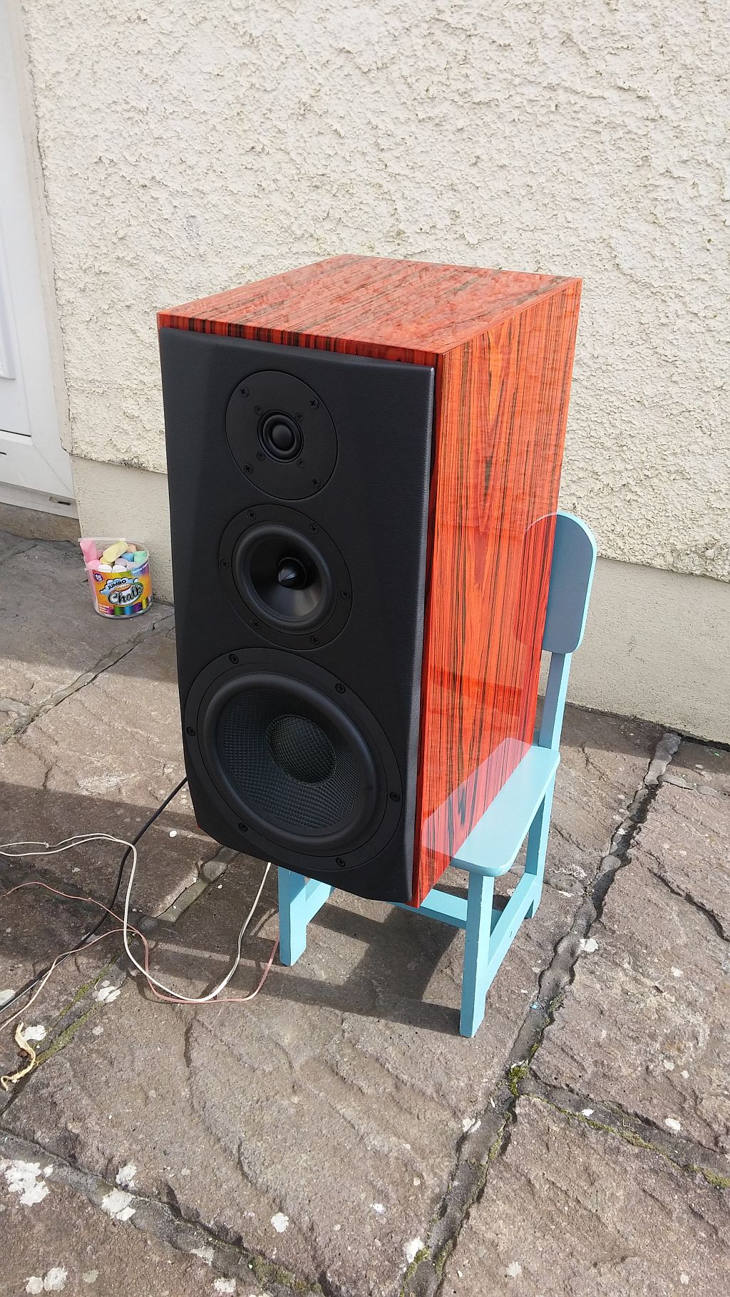

too good a build borys,
would give my left arm to have those for me.....
