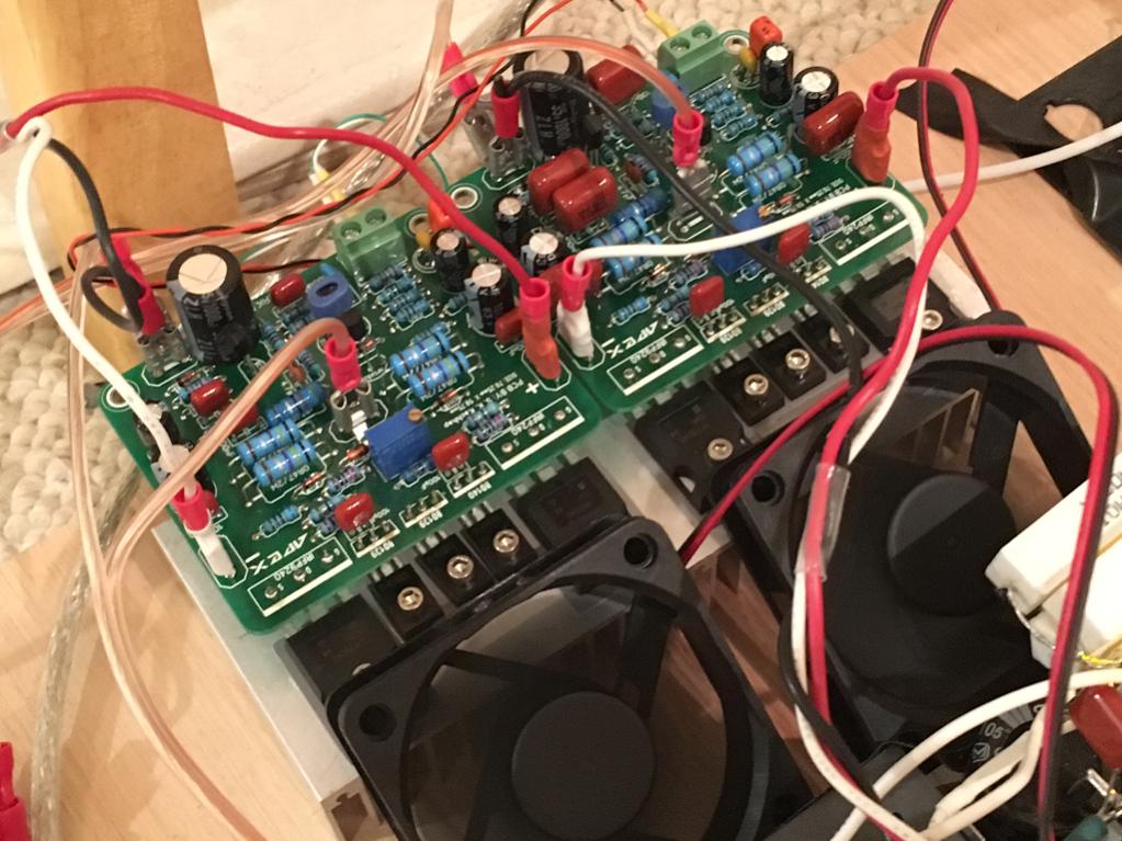

After hearing from another member who just built some FH9HV's and he said that they sound so good. I had a thought that maybe they might actually sound different (better) than the FH9 as they use KSA1381/KSC3503's which are higher performing than BD139/140's. So out went the M2's and in went the FH9HV's with the 300VA 32v trafo for 44v rails. PSU ripple with amps connected (140mA bias current) is 20mV.
Here is the amp - runs way cool with the two fans:
They immediately sound better than the M2's to my ears. Lower distortion, more snap on transients, more clear mid bass (less muddy) and beautifully resolved mids and vocals. I really like this amp - I think it is one of the best actually that I have tested.

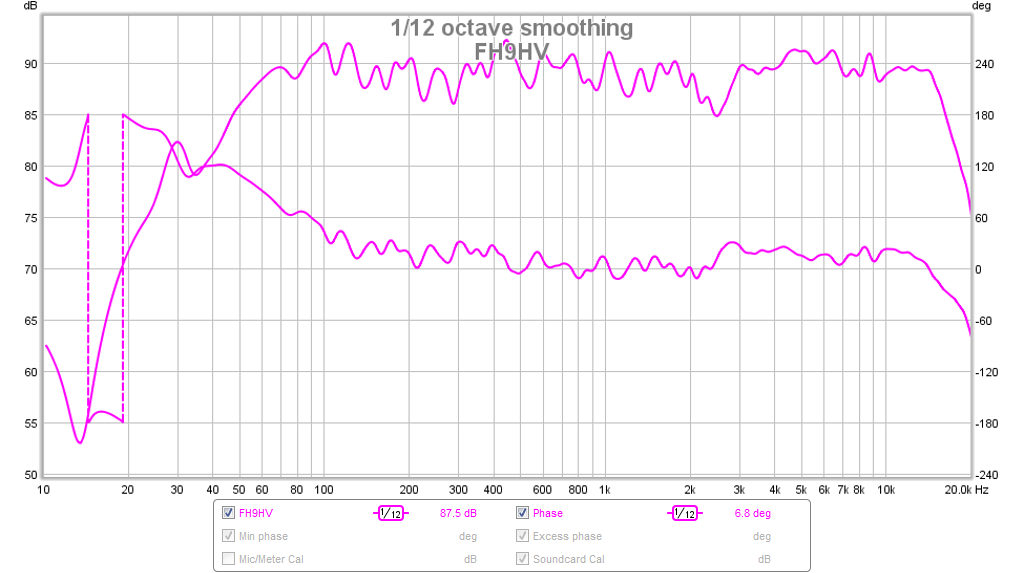

Measurements reveal half the distortion of the M2 in the bass region and lower distortion at 1kHz even. The class A did not buy much for me in this case (except a lot of extra heat in the room):

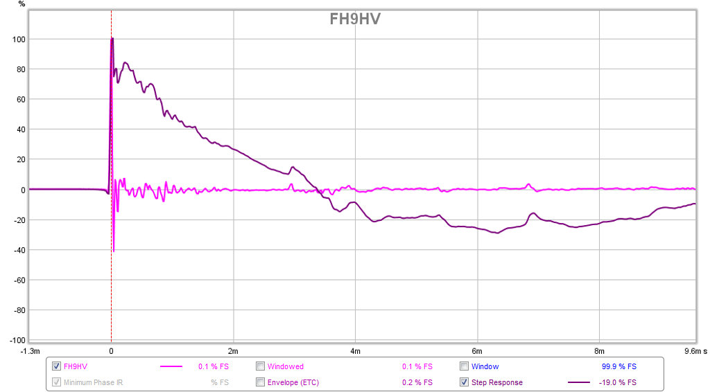

Here is measured Impulse and Step Response:
Here is measurered Phase and Freq Response:

Do
xrk971,
I see you're putting small caps on the collector and base of the KSA1381/KSC3503 pair, is it due to some oscillation? Do we need them? If yes, what's the value and type?
Do
Those were recommended by Apex Audio (Mile Slakovic) in the design and value is shown on PCB as 100pF. Best would be NP0/C0G ceramic/silver mica/film caps. I am currently using CBB 100pF (5%) 100v MKT film there. I have not tried running without it so can't say if it will suffer oscillations or not - I believe not as Andrew Lebon built and ran a version before it was recommended. Probably good idea to keep stability over wide range of loads.

Thanks for the feedback Do. I am certain that this amp deserves a real box now - that's a clear sign it's a keeper and one of the best in my collection. 🙂
Ah... Sorry I have those in place... It was just the photo perspective seemed like they were soldered directly on the pins of the KSA1381/KSC3503 but it is just because you didn't yet cut the leads.
