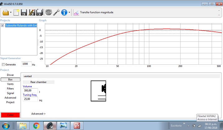

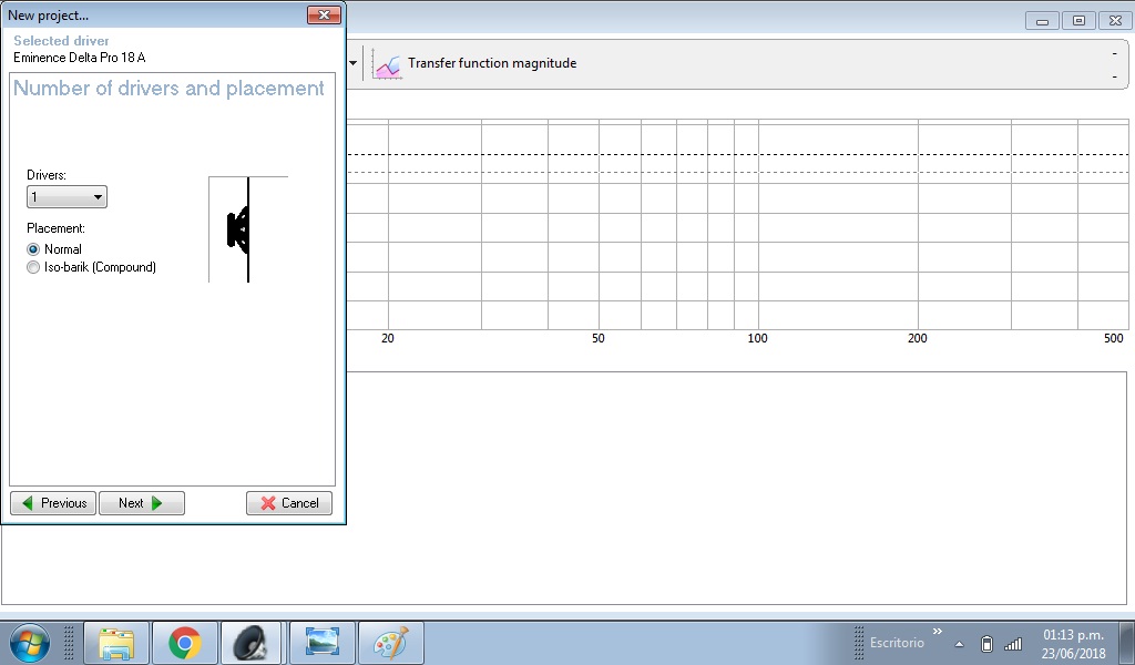

...............I have begun to simulate using WIN ISD.
I think 25 hertz will be fine..................
First steps with WIN ISD ....
300 liters
FS 25 Hz
This is very interesting .....
Now should you simulate the ports to achieve this response ?

Hi GM
For this same reason, my simulation looks good but it's very bad ! 😡
The controller to use has a Fs of 28 hertz and I am simulating at 25 Hz ..... But it seems that this error went unnoticed, I take for granted that my thread should not arouse much interest in most of the readers ... .and less with that statement: "vintage speaker JBL for subwofer" ....
Yes, you're right, I did not say anywhere that I wanted a big box. Maybe I took it for granted when I uploaded the photos indicating the place where I will put the cursed artifact. (see the red cross) Waf has no problems, and in that corner a large box enters without problems, - in a vertical sense even more - although it did not resolve yet whether it will be in the form of a prism or rectangular.
I will continue then with my construction, according to the original design of Eminence with two speakers and in 300 liters. ( 10.7 ft)
The experience of simulation has helped me to corroborate something that I believe had already raised here.
Two speakers in a box of the same liters can not be tuned as low as one ! 🙁
(See the first and last example of PDF boxes of Eminence)
One speaker 36.01 hertz F3 / 36.01 Hz /10.45 Ft
Two speakers 48.75 hertz F3 /48.75 Hz / 10.7 Ft

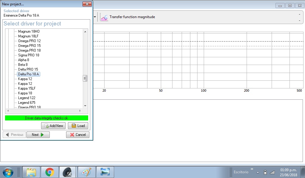

I'm correcting the driver database in WinISD, the version I used did not have the Delta Pro 18 A, and a locker alerted me about badly loaded data. Now everything is in order, although I do not see big differences in the results.
It's early morning here, I promise to upload my graphics soon.
Thanks again for taking the trouble to model my project, which will be very useful for other owners of this driver or with the intention of buying it.
This driver looks very robust and imposing, I think it will be a glory to hear those basses once finished ! 🙂
PS: I can not guarantee eternity, it was just a witty phrase, but I really thank you sincerely 😉

Yes, the same.

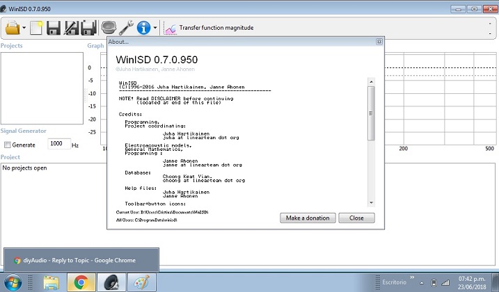

It seems much simpler than previous versions or have many hidden functions that I have not yet found. .
The online help is an interface of the previous versions ..
The Delta Pro 18 T / S of the database were not, if Delta Pro 15.
But they are already loaded correctly, the software says that, when there is bad data, it warns with a box in red, when they are OK, in green ....
I think it's based on the international convention of the operation of traffic lights ...😀🙂 I sorry .....,I can not with my genius....😱
Let me tell you that I am simulating 208 liters (36x60x96 cm) or 216 liters (48x60x75 cm) to maintain the golden proportions, although I think WINIsd also has this function when calculating the dimensions of the box.
