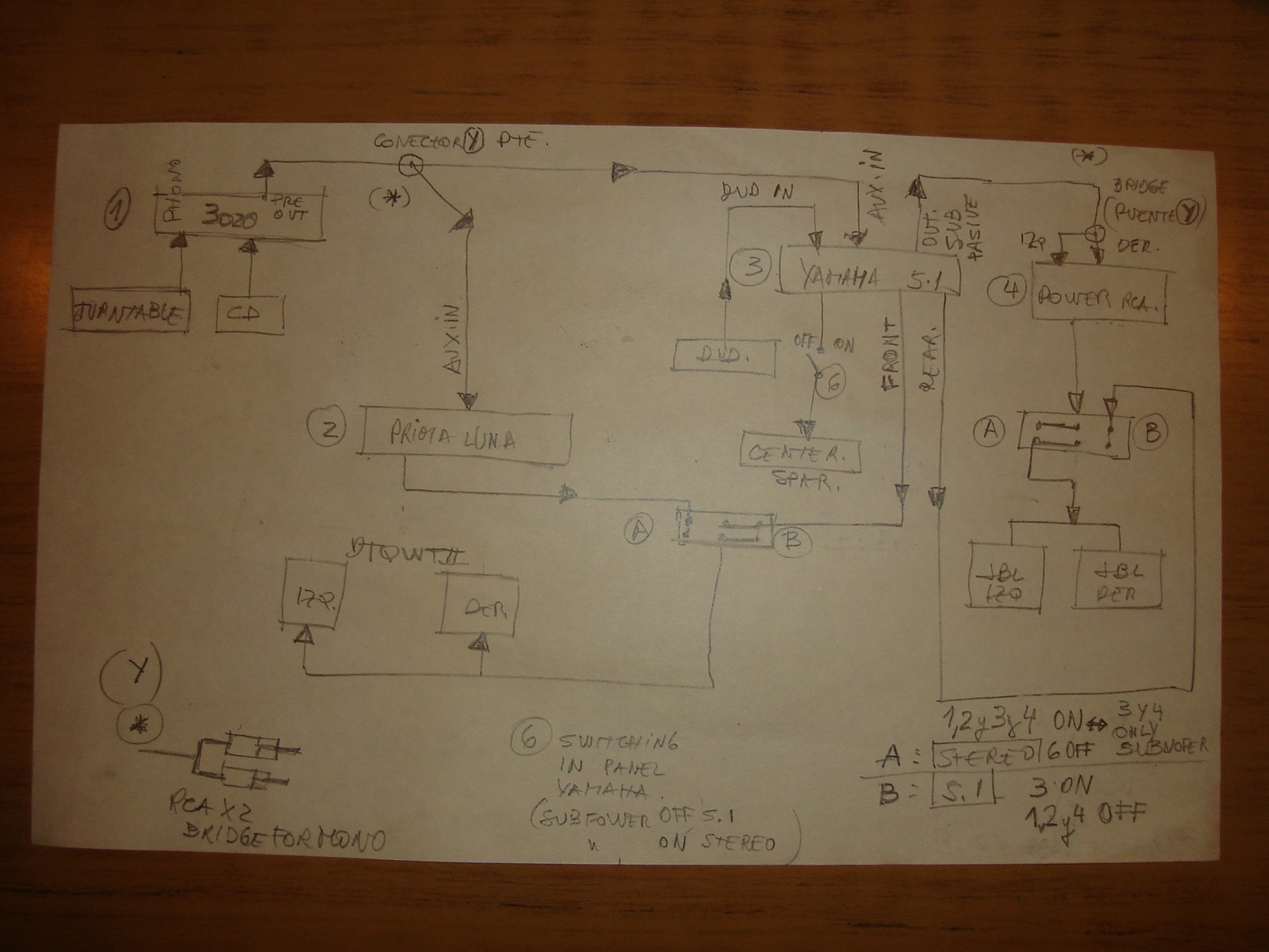

Just a doubt, and I ask again all those who can explain this to me:
The higher the load in class AB, the lower power.
Is it the same in class D?
Or put another way, can I connect my vintage JBL 8 ohms nominally without problems? Can I even increase the load with high heat dissipation resistors to reduce the risk of damaging the speakers? (This increases the distortion, but at these frequencies I do not think they are audible)
I am going to consult the seller (they are not usually very technically informed) so I would like to clarify the point with people of this forum, thanks again !

You don't want to add a resistor in the cirquit of a sub. A subwoofer in its frequency band will have an impedance that can vary from 4 ohms to 120 ohms, so a resistor will create a highly unlinear voltage divider.
You generally want the sub to be connected directly to the amp for maximum damping factor and control.
The iNuke has level controls, so turn down the senitivity so you can reach you max listening level and then some. That'll keep the damage potential down.

Maybe you can use somthing like the Harrison FMOD inline crossovers?

Thanks, but ferrite core causes saturations and oscillations in the frequency, I will not use that ......🙄
Not the Parts express brand filters, but it's the FMOD filters on the same page you want. These are line-level ones, that you put on the amp input...

Ohhh, Line level could be interesting ....🙂
But that model has the cut-off frequency at 80 Hz (OK) and only 12 dB of slope (-) ....
I'm going to browse other options in Parts Express, thanks

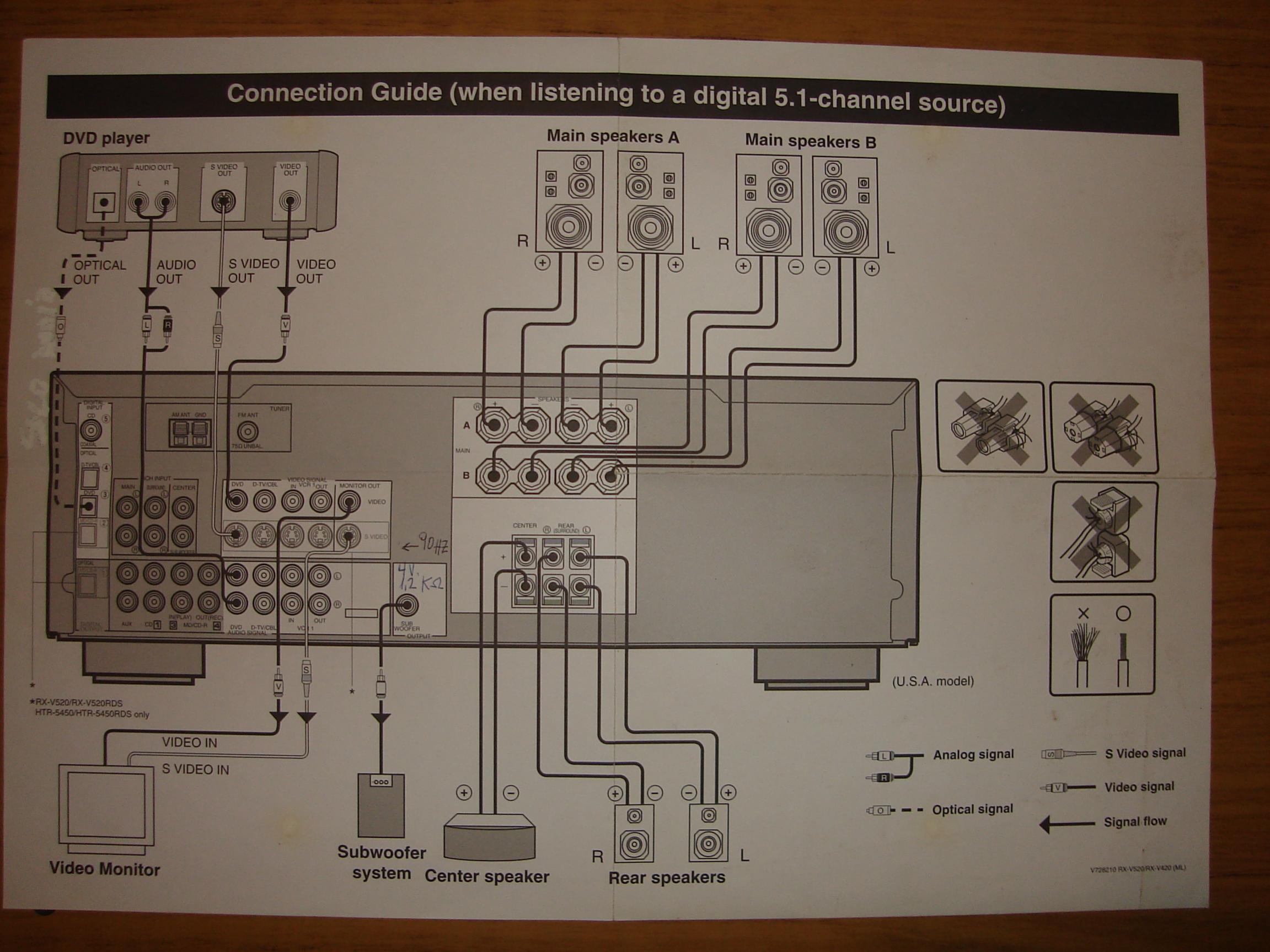

Someone has seen my diagram-solution using the Yamaha 5.1
I can not find more information about subwofer output, only its cutoff frequency is 90 Hz, 4 volt output voltage and have 1.2 kohms of impedance.
Being to feed an external amplifier, what type of filter / slope is used in these cases?
Anyone know?
I do not want to make all these connections and find me that there is very little, first order 6 / oct db, or something like that.

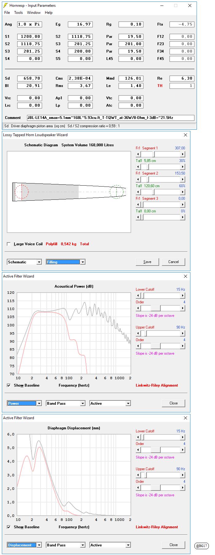

25 HZ Fs, 70 Watts RMS power handling, 80 DB / 1W / 4.6 mts. They are not used to reproduce 30/40 hertz at home listening levels ?
Why so complicated?
Yes, helped understand what you propose.
I'm also planning a sub project, but only due to picking up a large sub enclosure cheap [probably don't need it at all and will prove to be problematic with use due to neighbors annoyance at SPL and vibration through the building issues] but I realised the output of Amp for sub-woofer connection was via selectable crossover... so, less complications in design.
What I don't understand is why you want to do such complex speaker switching [A - B] and Y connections of line level inputs [L + R] and multiple Amplifiers [aside of the sub-amp that is needed unless you use an Active sub-]
You must realise this given your questions relating to; is it safe or, prone to magic blue smoke emission.
Alternative is:
Chances are you could sell all Amps there and buy a better Yamaha Amp where you can select speakers used [2ch or 7 ch Stereo] in the case of 2ch input source, as well as Bass crossover in the case of selecting 'small' for speaker setup that directs LF signals to the sub-woffer output [dedicating more headroom of L & R ch amps].
What you get is;
Safer,
Less OCD fiddling about,
Looks nicer at less cost,
More space for other stuff in the listing room,
....and... Mrs academia50 would be happier because less to look at and easier to use when your not around to pilot the system.
Remember, "LESS is MORE" and, "Happy wife, Happy life" ideology ?
The only addition I recommend is a cooling fan above Amp [mine seems to run hot after high output 5ch use.... Star Wars type material]

80Hz is the default setting.
What model Yamaha 5.1 do you have there?
Doesn't it have phono input?
My use of phono is very limited now - limited to mono 78rpm type discs.... fully 'over' LP use years ago. In this case RIAA eq isn't really appropriate, rather selectable eq curve suits the huge variation in discs .... so 'line in' levels are used rather than 'phono level'.

Specifications page of the RX-V1700 cite:
L.P.F. (Subwoffer) - 24dB/oct.
Does your 'Owners Manual' for Yamaha Amp have a 'specifications' page with this data?
- Rated Output Voltage/Output Impedance:
- Filter characteristics (fc=40/60/80/90/100/110/120/160/200Hz) :
Well, the main reason and explain, I can not spend more money on buying new gadgets, I must solve my concern with what I have, not buy an active subwoofer at this time. Things are very difficult here
Alternative is:
The answer is the same. I would not need to change miscellaneous components, just buy an active subwoofer .... but ...

Well, I do not know if I'm lucky here, the lady academia50 lets me do what I want, but do not put my hand in the wallet for audio expenses anymore. She does not care much about music, she prefers to watch movies on Netflix
The blue smoke will not come out, I know everything is feasible electronically. The only counter would be a phantom charge for the front speakers when DTQWTII are used only in stereo. Remember that these are used with the Prima Luna valvular amplifier, but it would be much easier everything .....
Does not bring phone input, are the specs in an earlier link that I indicate to the Yamaha website
I prefer the clean sound and no clicks and pops of the digital recordings, I do not understand people who prefer to listen to noises outside the music because the analog sound is warmer ... I prefer the coldness of the bits
But if I want to continue enjoying my vinyls with all its tones, like the lowest organ pipes.
Subwoffer - 2.0v/1.2kOhm
H.P.F. (Front, Center, Surround, Surround back) - 12dB/oct.
Thanks for the specs, I already found those of my receiver Yamaha 5.1
I do not know where I imagined 4 volts in output of subwofer .... it is 2 volts standart as the output of CD player, etc.
But only 12 db per octave, this makes the project unviable, we have already clarified in this post that it would be necessary minimum of 24 DB / oct so that there are no components of frequencies beyond the area that I wish to sub bass ... .
Wait for WAF to be in a better mood .... or buy a good gift, and then buy crossover Beringher or Hipex.
At the end of the day, there was no free lunch, not even shared, you have to pay me all.😀
Thank you all for your patience and good humor.🙂
The 12dB/oct is the highpass of the satellites. It means you'll get an extra little hump in spl just below the crossover frequency. If you run the filter at 100Hz or lower, it's no big desø. It's something you can use while you gather funds to bribe the missus... ;-)
