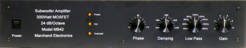

Marchand MB42 300W subwoofer power amplifier
The output of the RCA connector sends a filtered signal at 90 Hz only when operating movies or sound sources with digital processing ....
I think this could work ....

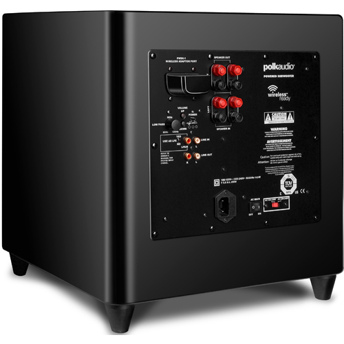

So I will have to buy something that is available in my country, for example :
Polk Audio DSW-PRO 660 Wireless Subwoofer - $19.039,99 : AVI Sistemas!, Audio, Video, Home theatre, TV LED, LCD y mas
https://www1.crutchfield.com/p_107DSWP660/Polk-Audio-DSW-PRO-660wi.html
My budget comes up here, maybe a little more if it's really justified...
But I listen to this and I think if I'm not throwing my money, or is this man forcing the subwofer just to show that he moves a lot of air?
Should I trust this review ?
That awful distortion puzzles me! Is that something desirable?
Minute .35 onwards ... what is this ?
My polk dsw 660 1000 watts dinamicos - YouTube
My noble and vintage AKG K-141 Studio headphones work perfectly!
This is what I should expect from the subwofers for HT?
Can I use this subwoof to listen to clean basses of normal music? I do not want kicks or blows of air on my face ....
