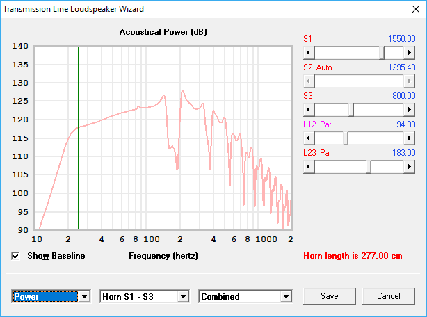

here's a quick sim for Delta Pro 18a based on a Russian site's scoop model for Cubo18 - there's probably a better TH hornresp model (?) Maybe Cubo will see your post
It also seems to do similar in a Karlson box about the bulk of the original 1951 Karlson cabinet. (~136l airspace)
a tapped pipe cabinet might be one way to make it closer to a subwoofer in function

here's that simple tapped pipe. Delta Pro 18a has a fair amount of inductance. With tuning around 22Hz, power handling isn't very high in the 40Hz region
The aperture could be a round hole, rectangle- having it a bit larger would raise tuning a bit.
OOPS -Here's proper drawing for the sim above = "this" and about 240 liter internal volume - much more manageable . Nieleaves' thread was a bit messy

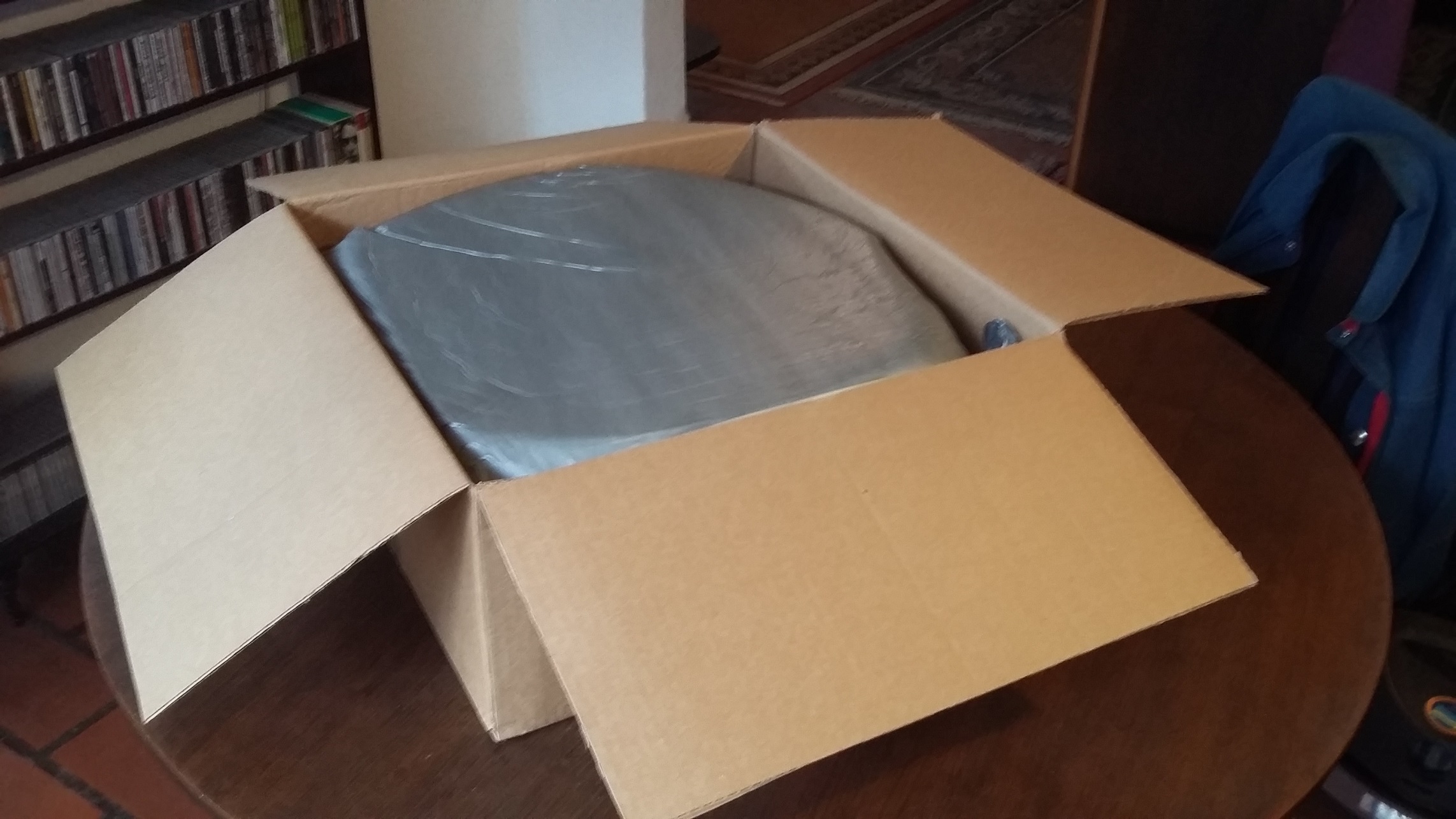

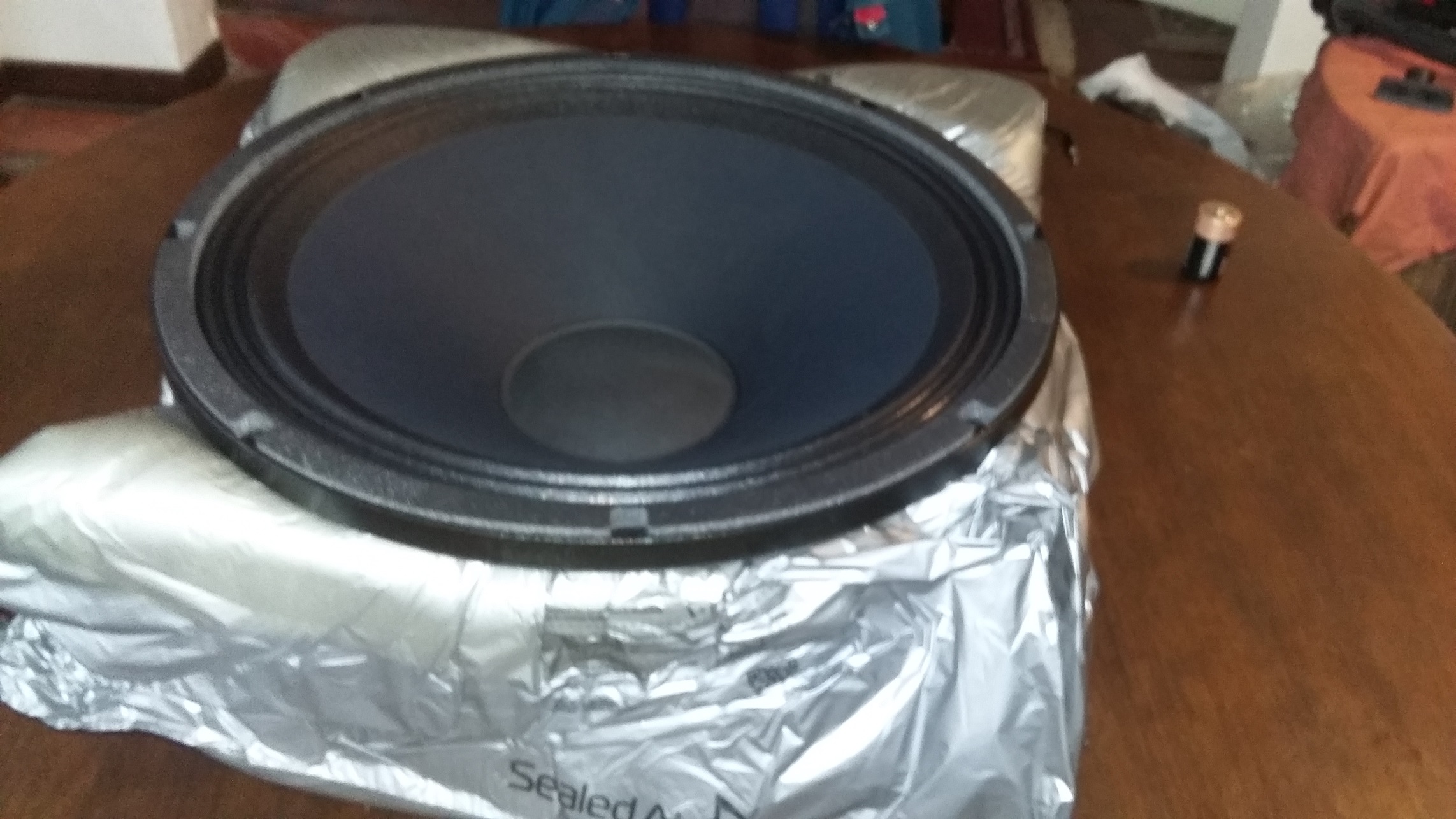

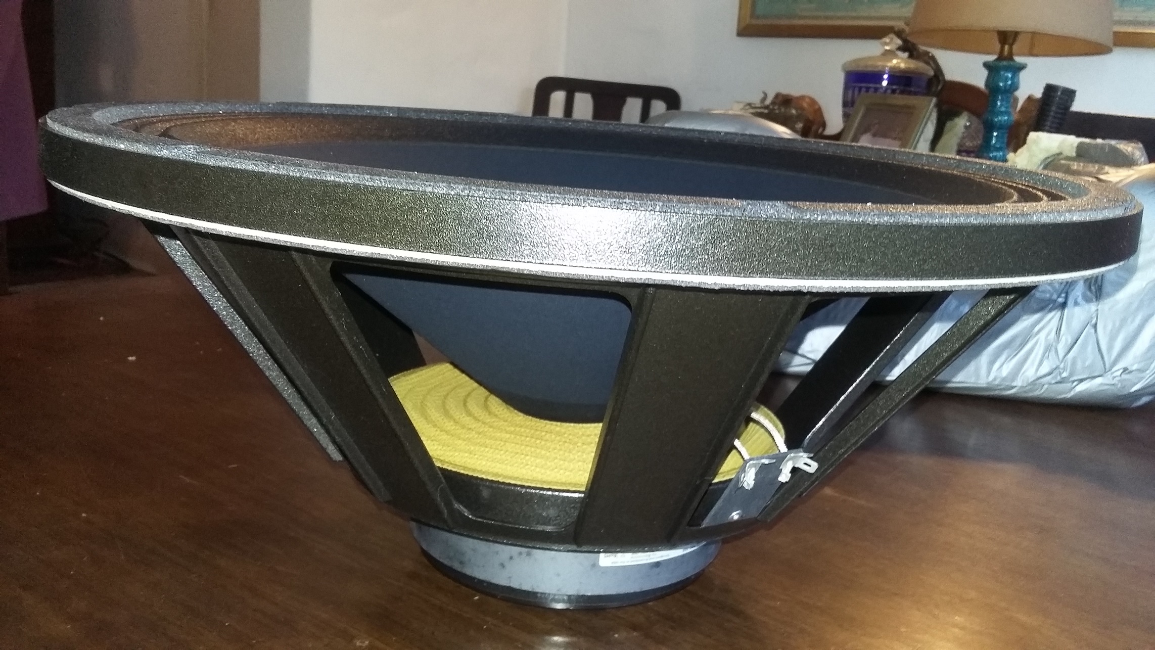

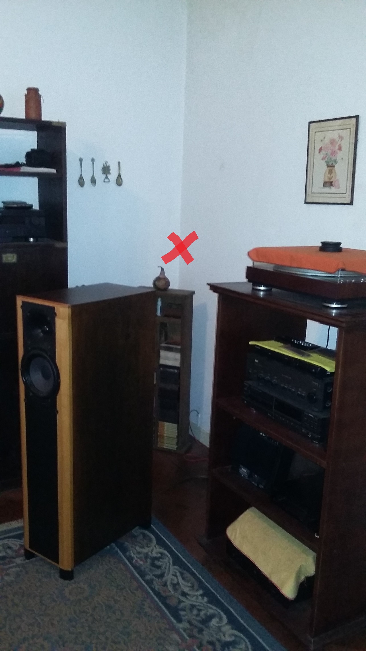

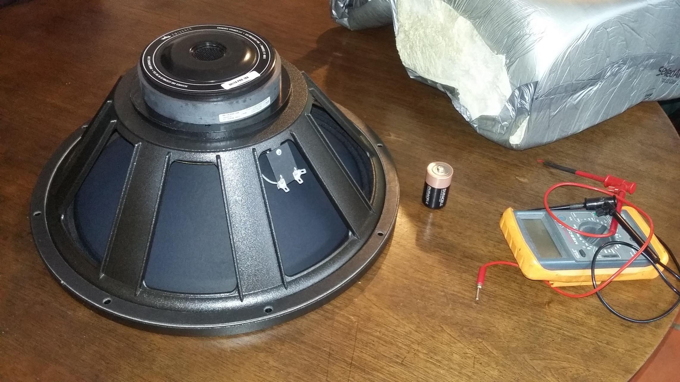

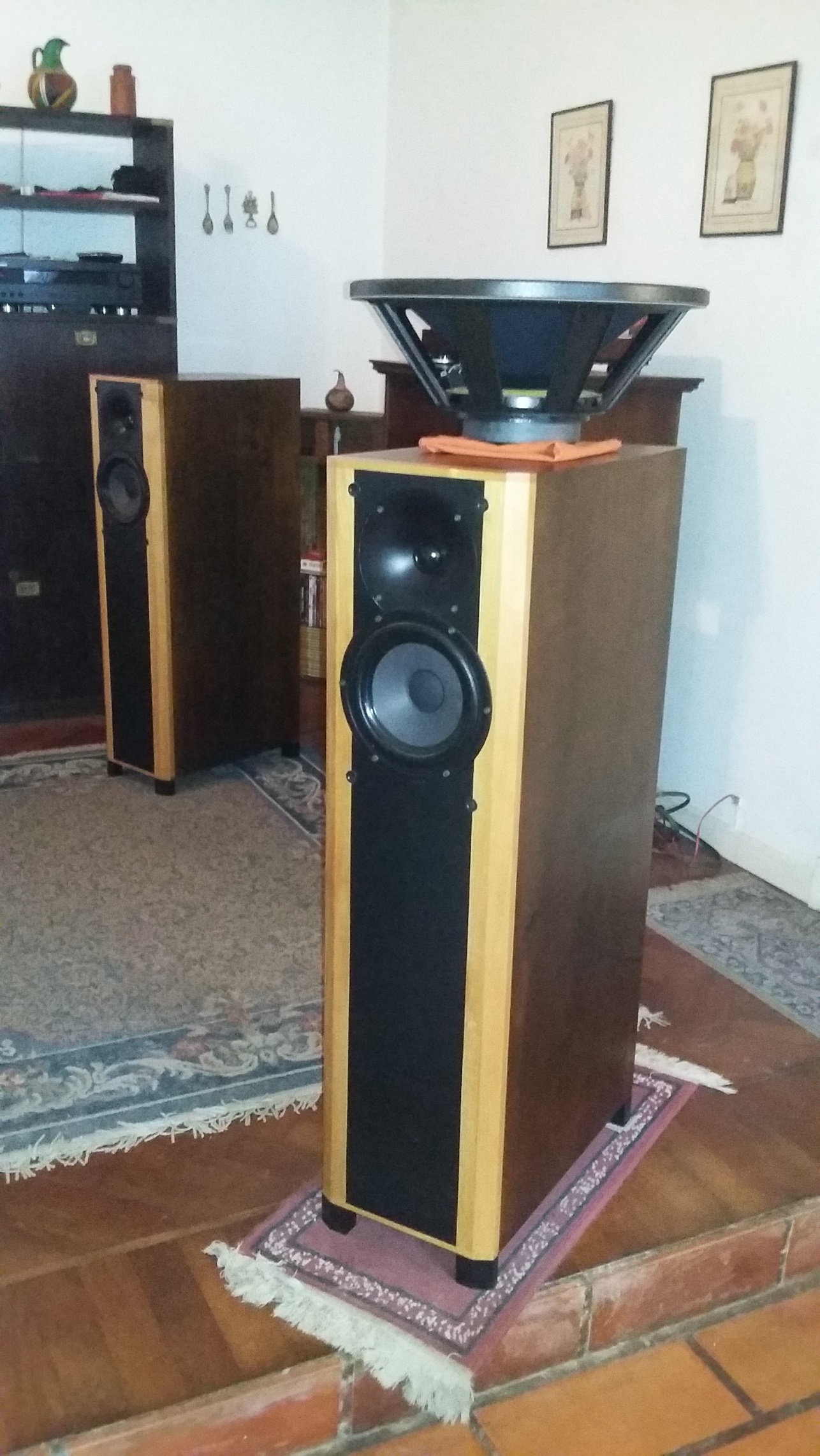

Today I removed the speakers of the trade, I proceeded to control them and they are ok, as it should be for being new, but better not to find surprises when I install them, there are still a few months left. .
wow, they are really big!

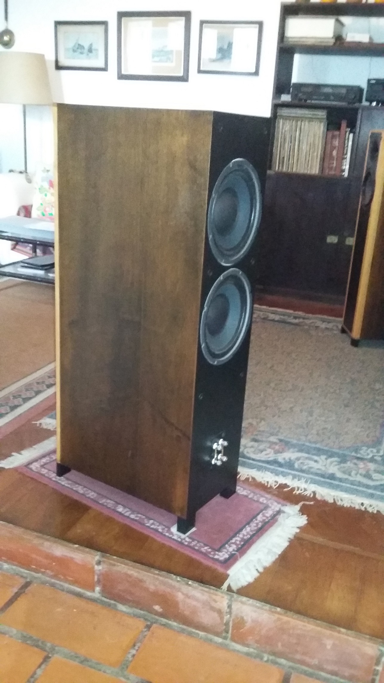

You can see the corner where I have thought and almost decided to place a single cabinet subwofer. From 40 hertz down I think the stereo bass does not make much sense, DTQWTII also take care of it. This subwofer is only to give that "body" and "volume" to the music by playing the lower octaves, as I have already mentioned. I do not need to feel explosions or earthquakes (effects of HT movies), but I would like to feel in the body the artillery of the 1812 Overture or the lower notes of Bach's Tocatta and Fuga.
I'm thinking almost exclusively about choosing some vertical design to locate in that corner. The construction of Eminence with two drivers attracts me, it is easy to build and could even make a prism to take better advantage of the corner.
But ..... if I could go down to 20 kz without so much slope, ~ -15 db falls in 20 hertz ... it seems too much to me, it's almost losing the first octave or I'll have to use EQ, something that for now is not foreseen and sincerely, I would prefer not to have to resort to DSP. I hope this step is the last in the search for my musical nirvana .... (never say never, haha)
Will it be possible to simulate something like that? If Brian or someone else of you who masters the use of simulation programs to perfection did it for me, I will thank you here for eternity!

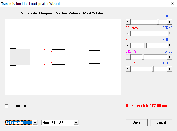

guess you could just make a dual 18 corner reflex with 200+ liters per Delta Pro18a and tuning around 20Hz
here's a sim for one Delta Pro18a
Hi freddi
I like that ! Thank you ! 🙂
~ -9 dB of slope from 40 hertz to 20 hertz is much better than the graphics I've seen before of Eminence !
I suppose that the slope (bold) plus abruptly by the inductance that the VC presents will not be audible in the practice.

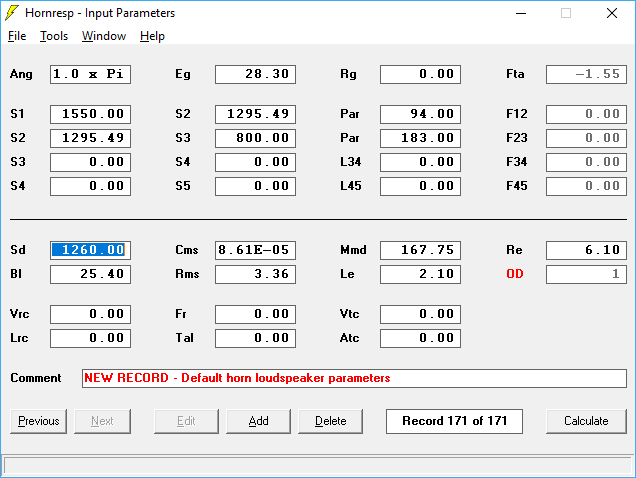

I am learning about HornResp, to assimilate new concepts and thus understand many things about graphics, but I admit that it is not easy, there are many variables .....
Horn resp for beginners - Page 2 - Free Speaker Plans
The doubts that are presented to me are:
This sim that you have done is for the two speakers in a single cabinet as I wish?
Is it a cabinet with a horn ? (I think the HR program is for that kind of boxes ) or is it a BR cabinet?
If so, you should find a box with port dimensions, right ?
