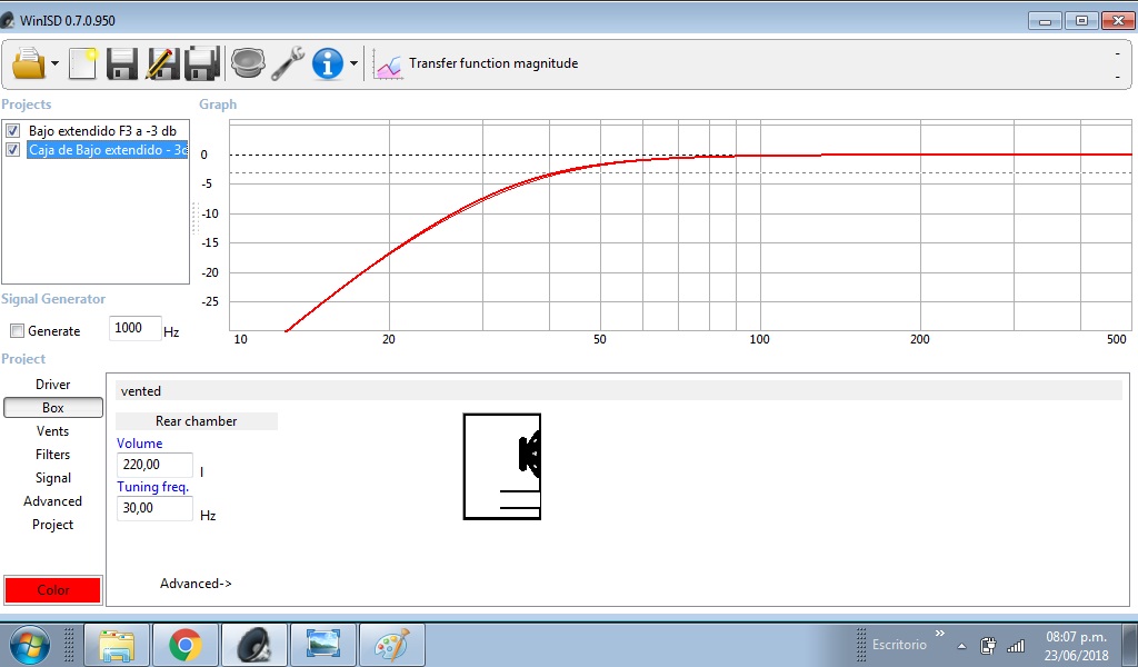

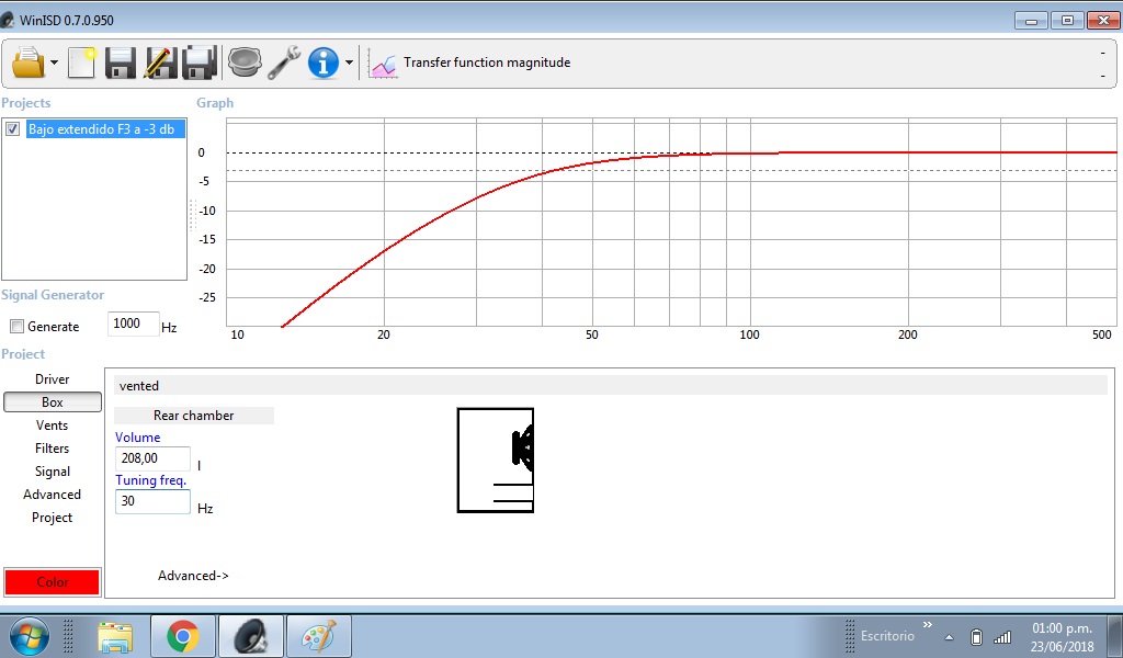

Finally sim. of 208 and 220 liters, there is no greater difference in the graph, but the golden proportions in 216 liters (75 cm is the height, 60 the width, and 48 cm the depth) The 48 cm are more appropriate to house the tube tuning, in 36 cm corresponding to the box of 208 liters, it would be drowned breathing it ...

I think that what you want to say ...🙁
With so many liters do we need to extend low ? 😕
Why ?

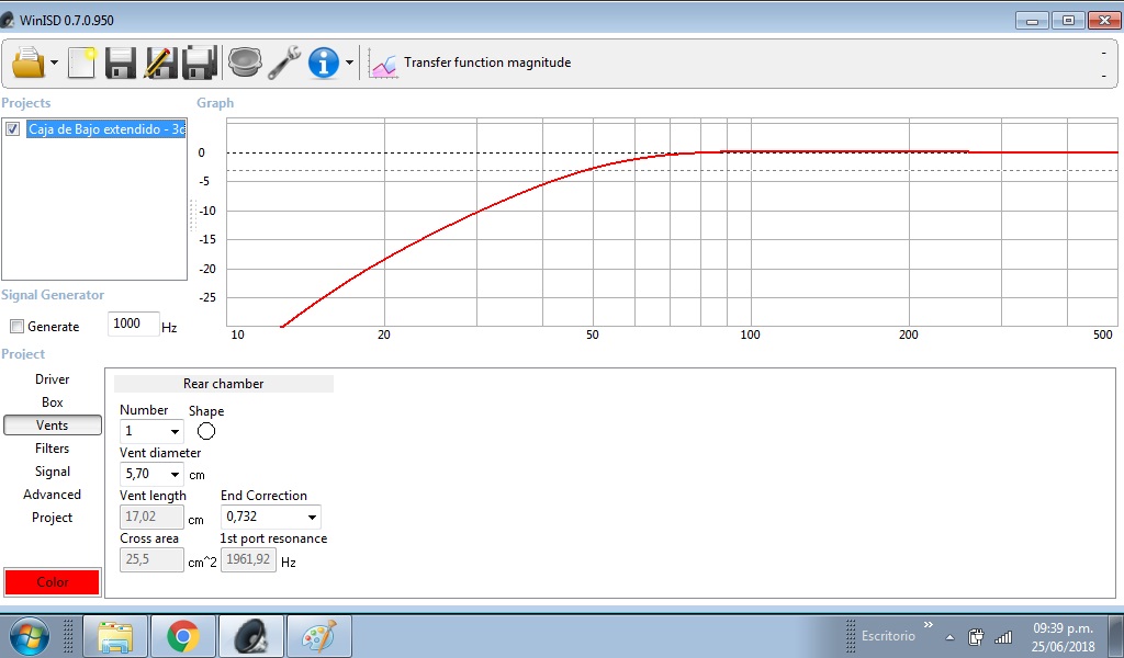

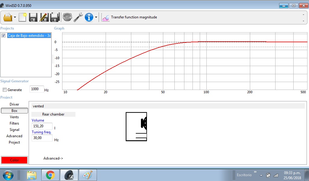

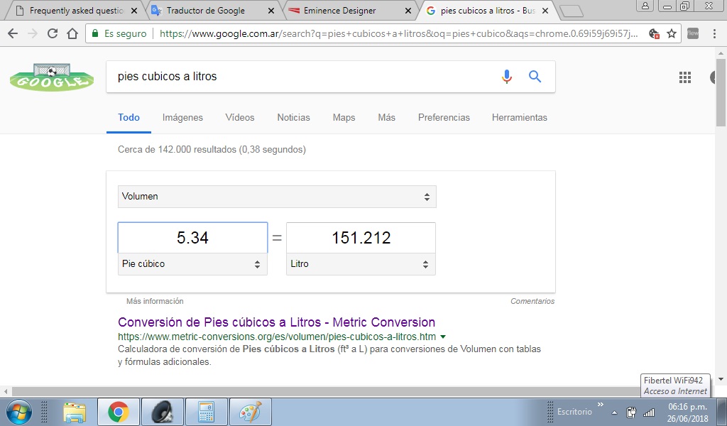

The dimensions for a golden ratio parallelism are :
High 75 cm
Width 60 cm
Depth 33.60 cm
Which gives us a volume of 151.2 liters.
Experimenting with the tuning tube, and using PVC pipes of 5.70 cm of internal diameter (they are the local dimensions, in my country) the length of it will be of 17.02 cm. and applying the correction that indicates Win ISD (0.732 for tubes without flange) gives us a long cash of 12.45 cm.
The internal air volume for this tube is 0.317 m3

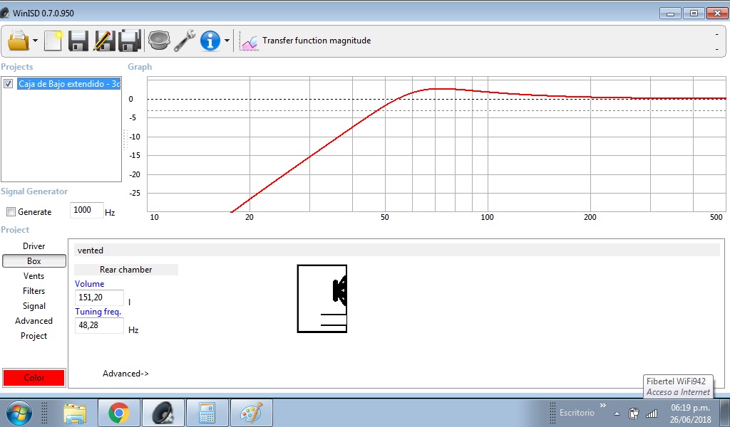

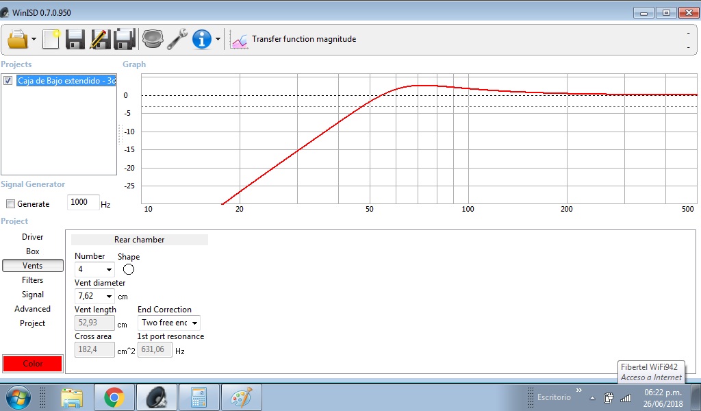

I'm a little surprised by this, the tuning that I use is 30 hertz against a tuning of 48.28 hertz the Eminence , but the design of Eminence of 150 liters employs 4 tubes of 0.041 M3 each, which is equivalent to a total of 0.166 m3 ......
I think it has to be an approximate value or higher, never smaller, because a smaller surface of vent, smaller F3 ....😕
Is this correct or is something wrong ? 😱
Can someone throw a little light here ?

Maybe this helps ....
Linearteam WinISD Pro
Port terminology: Physical/acoustical length, end correction
If you have read articles on port design on the Internet, you have probably stumbled on various terms involving ports. This document is to explain some of those terms.
Effective radius/diameter
If your port has some other shaped cross-section than circular, then we'll need to calculate effective radius or diameter. Effective radius is radius of the circle, which has same cross-section area than non-circular object. For ports, only inside area contributes to port area, not it's walls. For calculating effective port radius/diameter, use following formulas:
effective radius = sqrt(S/pi) and
effective diameter = sqrt(4·S/pi),
where sqrt means square root.
For example, you have square port which has 100 square inches of cross-section area, what is effective diameter and radius?
Now, just plugging the values to above formula we get:
radius = sqrt(100/pi) = 5.642 inches
diameter = sqrt(4·100/pi) = 11.284 inches.
Of course, diameter could have been easily obtained from radius by just multiplying radius by two.
Acoustical length
First, we need to discuss what is the idea behind port, and how it works. Basically, port forms a mass-spring resonance circuit with enclosure volume compliance. Helmholtz was first to discover such a resonator, hence it was named after him. Mass in port resonates with compliance of box air. By tuning the enclosure, we chose mass in port, so that resonates at desired frequency. As our port will have some area, we can calculate, how long this "tube" should be to have desired mass. This length is so called "acoustical length" of our port.
Physical length
Unfortunately, effect of the port doesn't stop at the end of our port. Moving mass extends somewhat beyond of the port. Researchers of acoustics say that radiation impedance has reactive component, mass. So if we make our port length equal to calculated acoustical length, we'll find out that tuning frequency is lower than what was expected. We can make good approximation to this extra mass by adding this radiation load mass from desired port mass and then calculating required port length.
By default, WinISD assumes that you are going to mount your port above way. And therefore gives you physical length of your port assuming mounting like in above figures. See also FAQ 3.1.
End correction
End correction factor is analytically or empirically determined factor, how much port extends beyond its physical ends. For free end, end correction is 0.30665 times port effective diameter. For flanged end, more analytical expression is available, 4/(3·pi) ~= 0.42441 times port effective diameter. Flanged end is calculated assuming that tube terminates to infinite baffle. Which is not exactly true, but.. Following table summarizes various port configuration types and their total end correction factors (refer to above picture to various end types):
Summary of end correction values
Port configuration end correction 1 end correction 2 Total end correction
Two free ends 0.30665 0.30665 0.6133
One flanged and one free end 0.42441 0.30665 0.7311
Two flanged ends 0.42441 0.42441 0.8488
Physical port length is obtained by subtracting port effective diameter multiplied by suitable end correction value from port's acoustical length.
PS: You may believe that Google Translator translates VD as "disease venerea" ? 😱
I provided it, this will be a nightmare ....😀
" Two free ends " is equivalent to rush ?
That is, without a flange, flat ? 😕

I have found that the Golden proportions that I have calculated are correct ! 🙂
151.20 liters of the Eminence cabinet (5.34 cubic feet) match exactly these!
Something is something, worse is nothing ......🙄
But four round ports of 3 inches (7.62 cm) in diameter do not coincide in the length with the calculation of WinIsd.
I did not expect such a big difference, something is wrong, really ....
Vent lenght 52,93 cm each ? 😡

G.L. Augspurger's old DOS routine "ventwrk" says four 7.6cm diameter tubes need to be 27.5cm long to tune 151.2 liters to 30.3Hz. If a vent is close to a wall then may tune lower. Its good to have some way of measuring impedance if possible.
hornresp thinks 21cm length is about right and shows very little change in frequency response betwen 21cm and 27.5cm length for the port lengths
Hmm, FWIW when I did the 150 L/6th order sim in HR earlier in this thread it took a 234.45 cm^2 x 49 cm long vent to get the vent mach below 17 m/s @ 250 W, so whatever size tube closest to it seems the minimum unless a lower power limit is acceptable.

I think the important point here is:
Can some simulation program be perfect?
Obviously NO, it is just an instant calculator of formulas, which saves us a lot of time in making calculations.
It is fundamental to introduce the correct T / s parameters, of course, but all the simulation software use the same resolution criteria of the different variables? Obviously NOT
Having said that, is it normal that there is so much difference between them?
Again, I think NO
So, if I want to download F3 from the 150 liter ( 10.45 ft) of Eminence cabinet from 48.28 Hz (?) to 30 hertz, should I do so with the software used by them?
It's hard to believe this!
Hmm, I meant what I said 😉; an EBS for this driver is ~346 L tuned to Fs; at 150 L it's just rolled off ~ the same as an over-damped sealed alignment.
The extra liters adds significantly more bass in the ~24-35 Hz BW plus whatever extra the room will likely add whereas the 6th order 150 L cab will have a similar gain to ~match the much larger EBS, but will require 4x the power, which of course costs more in amp power, sound SQ or for a given power, the peak available higher up in the mid-bass will be limited to 1/4 if the signal is flat down to tuning [not likely], but there could be situations where the amp will clip, so all things considered seems like the EBS is a better overall choice in a HF/HT app to me.
All that said, if you're not interested in modern movie soundtracks, pipe organ symphonies or similar with significant output below ~32 Hz, then a >150 L tuned to Fs should suffice with a decent quality 250-300 W amp, preferably with at least an adjustable high pass filter, though a bass equalizer would be a better overall choice.
