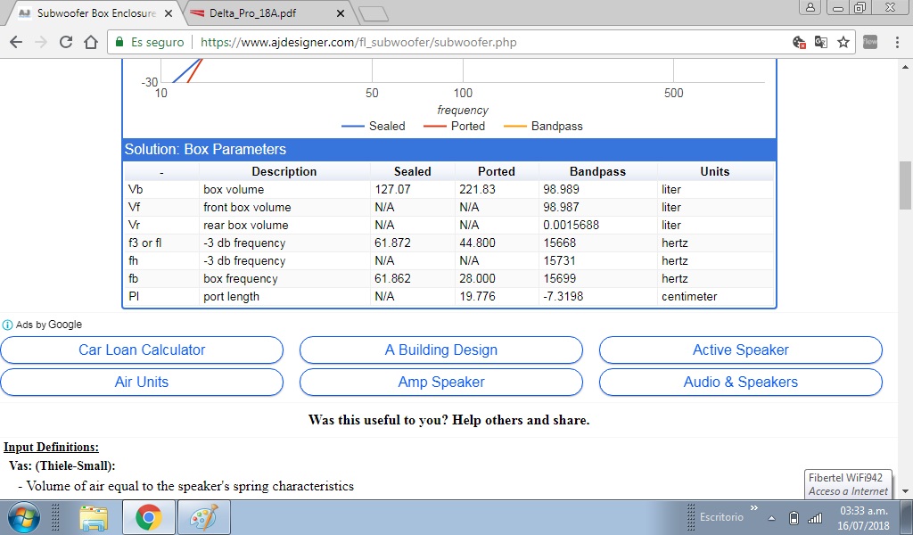

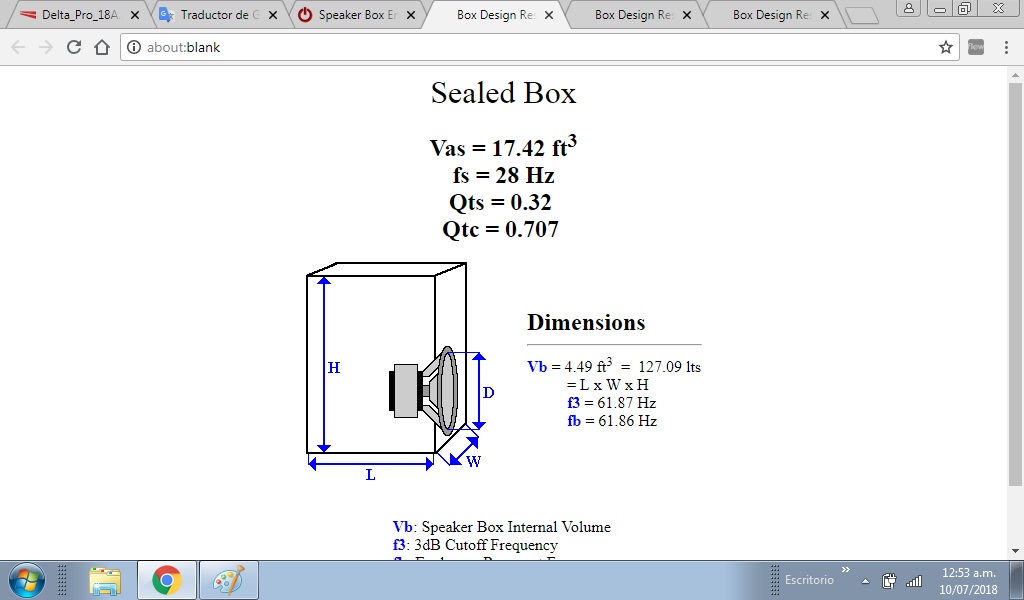

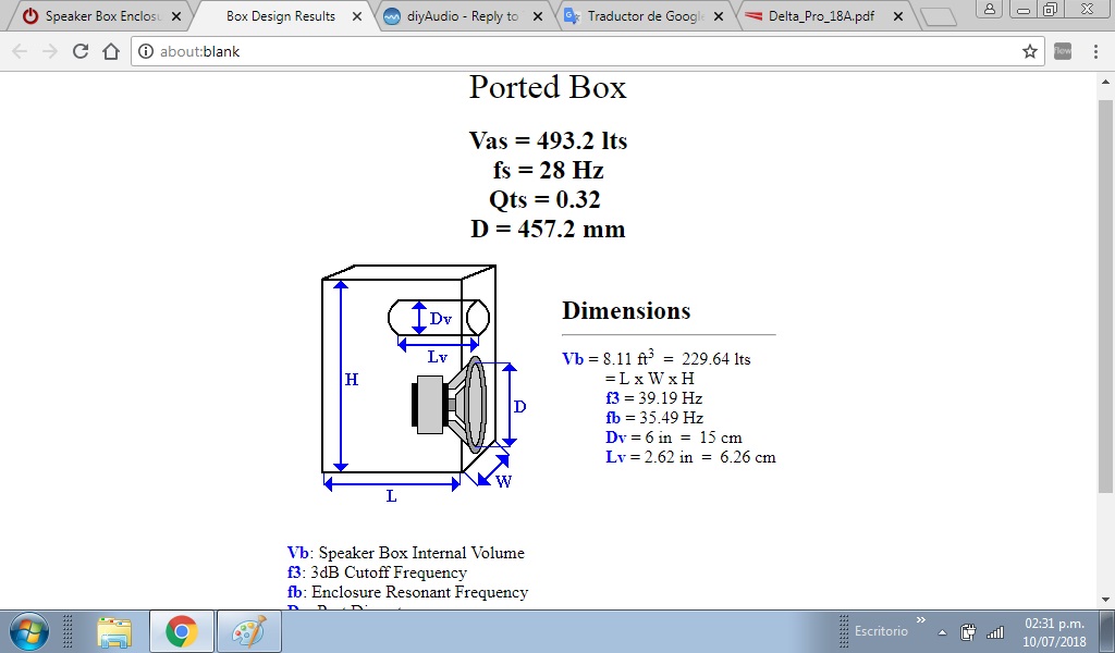

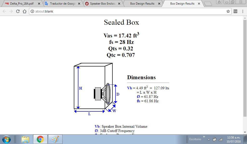

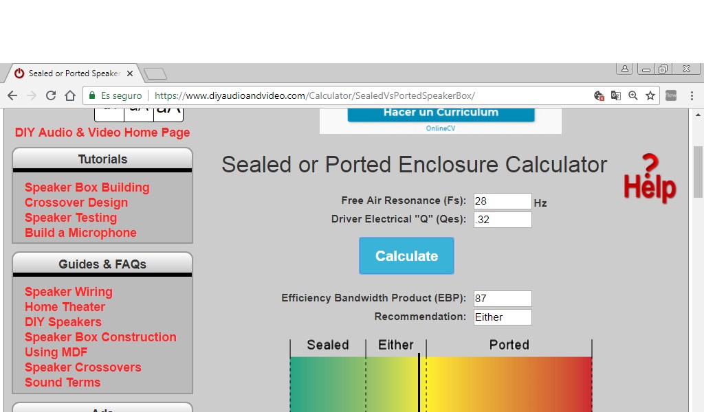

Speaker Box Volume Calculator / Designer Help

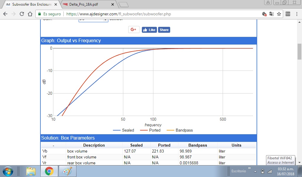

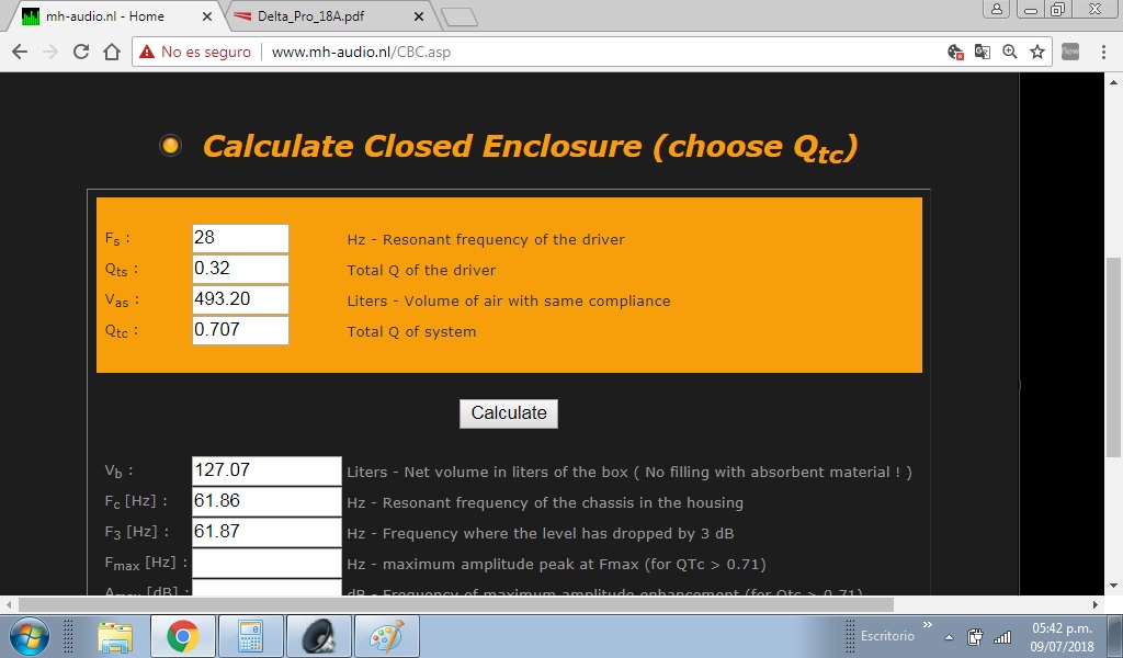

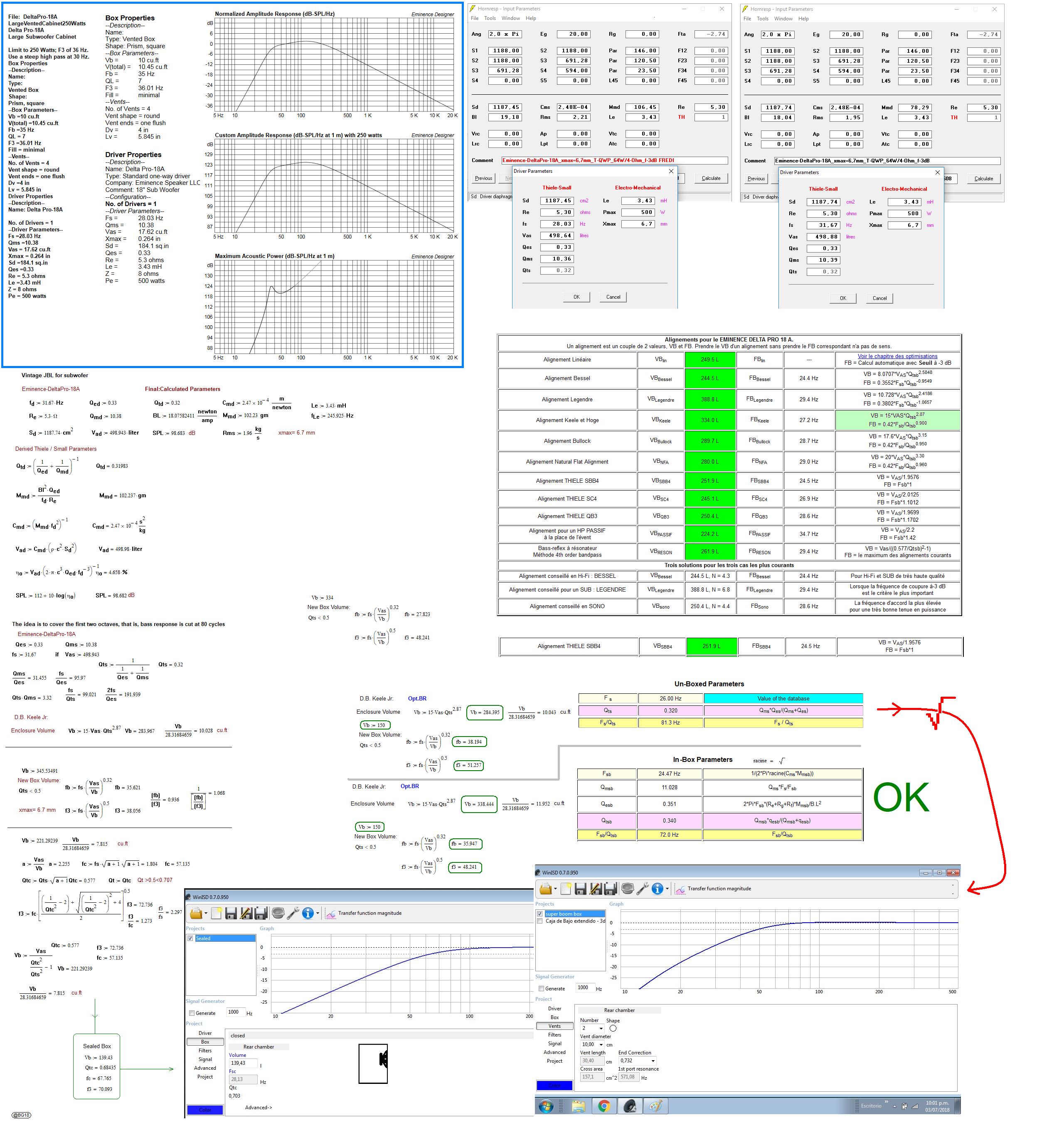

bjorno:
As I mentioned before, the graphics provided by you are excellent but I have to admit that they surpass me in knowledge.
In the attached graphic I see two of my simulations with WinIsd.
One is from a sealed cabinet and the other from a ventilated cabinet.
A red line with the square root symbol on it, which means? That sign replaces a cross, that is, not viable, crossed out ? :confused:
And the OK in green, to which of the two systems does it refer?
I think your answer will be for me the strawberry that is missing the dessert, please allow me to enjoy it properly....:)
Thank you !

I have a new concern for everyone:
The calculations for a cabinet are made trying to be as accurate as possible, because we want to achieve the best sound.
If we already have the exact volume of the cabinet, but then we add buffer material inside it, the virtual volume will increase, as freddi pointed out earlier.
But, there are no exact formulas here, how much will it increase? 10%? 15 % ? And this percentage will also vary depending on the type of material used. :confused:
The bracing and the volume occupied by the tuning tube will be easy to add to the overall volume, but not the influence of the absorbent material.
In short, is it worth taking risks using material in my particular case, with large drivers and boxes?
I leave a study here:
Data-Bass
What do you think ?

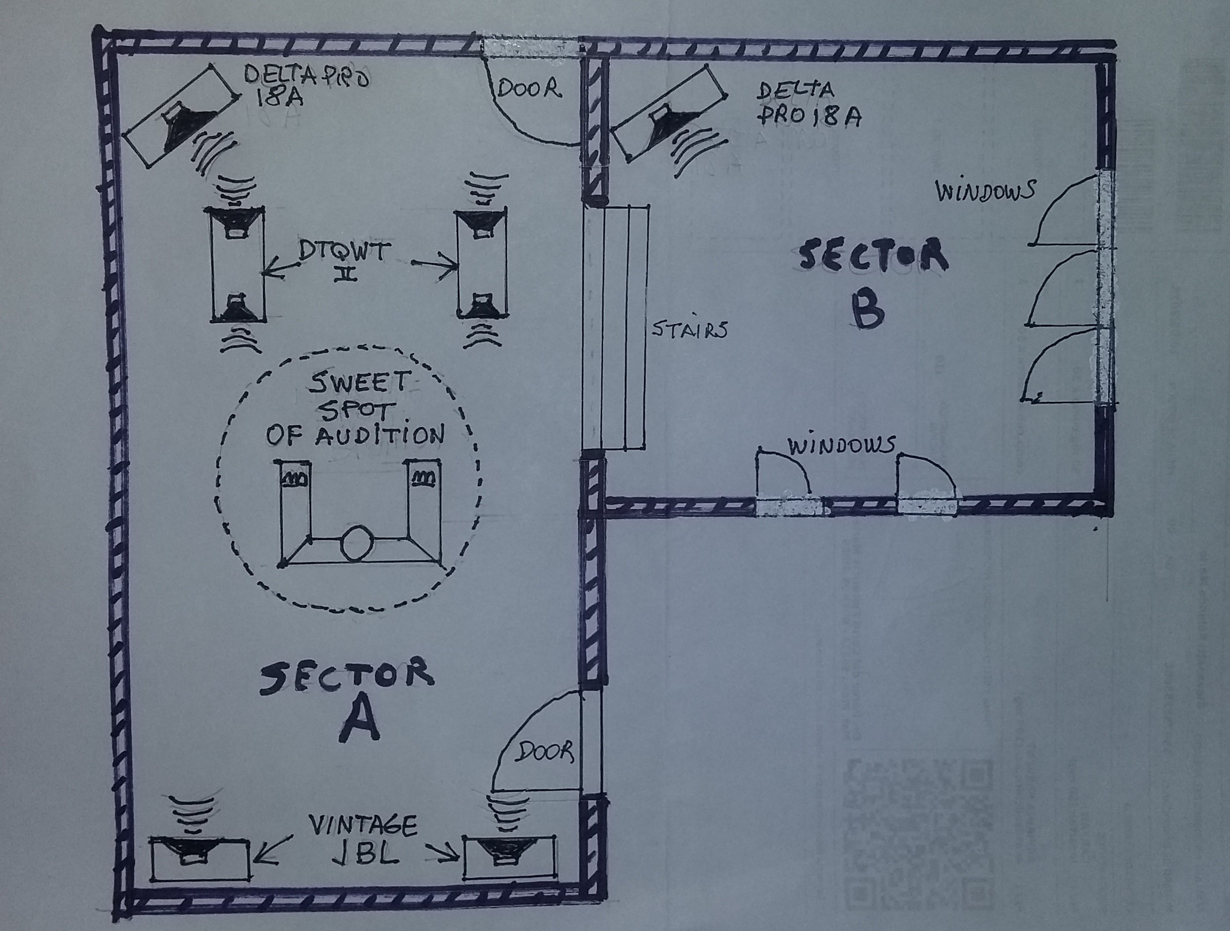

:cool: It is exactly the opposite of what I expect, that this is the final step ....
I recognize and I do not minimize the importance of the acoustics of the room at all.
But currently it behaves quite well by locating the old JBL subwofers according to the sketch attached
With these "temporary subwofers" :rolleyes: in phase or counter phase with respect to the main ones, no difference is perceived from the listening point. If there is one when I approach the front wall, there the bass reinforcement is notorious but I attribute it to the DTQWT rear speakers (four x 10 inches)
I do not rule out in the future to incorporate a measurement system, (like the REW that you advise me), however, first I want to experiment placing the subwoofers in the same plane as the front speakers, (I think it will be two, I agree with you in that give more flexibility to do tests) could try a sub in the sector A and another in sector B, both located in two corners to further increase the gain of the room. That way I would recover some DB that I am losing due to the roll off of the sealed boxes ... it is just an assumption, we have to experiment.
But first things first, I have to build the boxes ... although I must wait for a more benign climate, today we have a lot of cold and rain in Buenos Aires, we are in the middle of winter. So I will wait for favorable weather conditions to work abroad this time, because the owner of the room (my oldest son) demands that I return it. (I borrowed it to use it as a carpentry shop when I built DTQWT)
PS: An additional advantage of good weather is when I listen to music with all the vantanas of sector B open! It is infinitely better than conditioning with acoustic materials .....:)

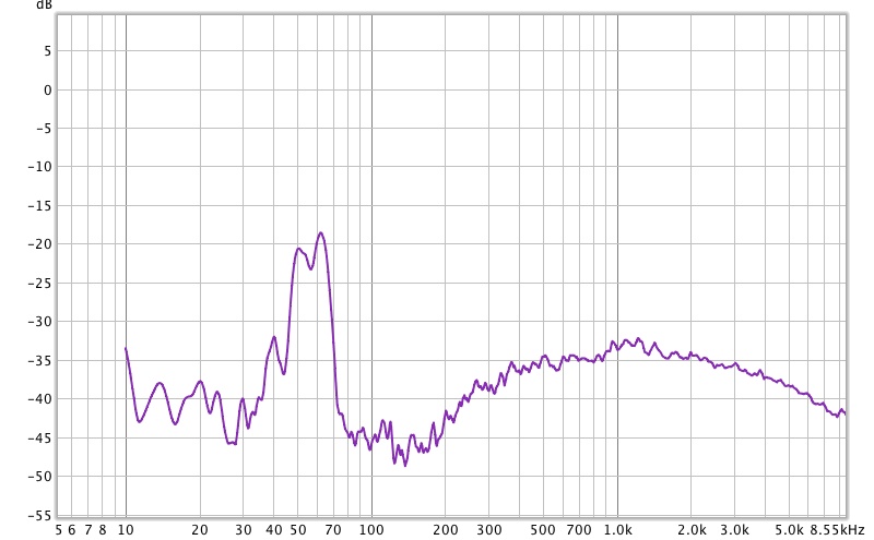

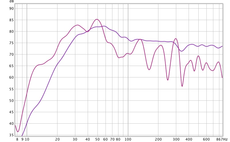

As an academic, I am sure you will be delighted to see actual measurements from my room... with my chair near the centre of the modest-sized room. The plot has no EQ or crossover. It shows (1) my 5 cu ft sub as measured at about 2 inches and then (2) one spot (randomly set) at my chair about 10 feet or so (I added 22 dB as my best guess at comparison).*
Anybody need help guessing which curve is which? Anybody want tp pick a good spot for crossing-over?
But the real question for all of us is: what is the best way to work with a sim, slide-rule, crystal ball, or prior-measurements to anticipate the chair FR?
Nice output below 20 Hz.
B.
*my subs are driven by my swell 1980 JVC receiver I bought at the Salvation Army for can$20

And here's sealed box distortion up-close. An astonishing curve below 1% for most of the sub passband albeit at rather low volume. The at-chair curve is of course identical although REW necessarily de-rates it due to noise.
(I don't know about that bump in distortion. Maybe it is the FR bump and/or the accelerometer I glued to the dust cap.)
B.
B.
Well, I think your room is the blue curve, the one that does not have so many peaks and valleys.
I understand what is your point, you say that before buying the horse carriage
you have to know if it pulled a racehorse (thoroughbred) or a percheron (draft horse) ...
Well, I already have the car and the horse, just need the rider to adapt more and more to it. I do not know if the example is valid, but it's the same .....
So I appreciate your good intentions, but I'll do the baffles first and if I decide to use REW the room will be conditioned later. If I noticed it necessary.
I would buy MiniDSP + Umik -1 + REW, I have been advised in this thread a long time ago, but this is learning with obstacles. It is not the same to live in Toronto as in Buenos Aires ... there are very big logistical and monetary problems here! Keep in mind that I bought Delta Pro 18 A because there were not many other options for a good subwoofer speaker.
Also, as I mentioned, my room behaves acceptably well, the irregular dimensions help the stationary waves to extinguish quite quickly.
There are also many books, armchairs, wooden furniture, carpets, etc. Everything helps to function as bass traps. Nor should there be too much, because it would kill the upper spectrum, even the dynamic range. I have a lot of accumulated experience in this regard. There has to be a balance "in disorder" between the objects, I'm sure you understand ..
Well, now I have to define the material to use for the boxes, calculate the exact dimensions of the cuts, the screws to use, etc, etc.
There will be no dowels for a craft work this time.
The smooth, lovely, sim-like curve is the up-close miking. The awful curve (with the swell lower bass) is the REALITY.* Ummmmm.
If any other reader made the same noobie mistake, take it as a "learning moment".
You seem to have a conceptual understanding of room furnishings. At least until you actually test and discover the reality. Of course even poor rooms become your norm once you are used to them (AKA your current "adaptation level" in psychology).
My point is that it is misplaced effort (and perhaps conceptually wrong) to follow sim slavishly, like some people who drive into lakes by following their GPS.
Get ready to sort-out your system after it is operational in your room.
B.
*the room curve looks awful; while any other haphazardly chosen single ear location would look awful too, it isn't the same as hearing perception.
