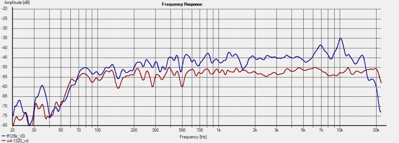

Not that I've toyed with a ton of small FR drivers, but the 4" bamboo (in ~9L DCR) is one of my favourites so far, along with the old Fostex FF125K in a ~8L reflex. The Fostex is not as smooth on top, even has a couple of large peaks around 10kHz, but is much less beamy and probably has a more even power response because of this. I prefer the Fostex overall. As far as I understand what is meant by DDR, I think the FF125K has lots of it. I also like that it has very high sensitivity for a sub-6" driver. It allows me to use it with my 2.5W SEP 6GW8 amp, which gives it a hand in return with its ~2ohm output Z.
Here are these two drivers, measured on-axis, mic probably 20"-24" away and speakers on the edge of my desk IIRC, same drive level, so the sensitivity difference is correct. Not an ideal setup by any stretch, but fair enough for comparison IMO. Calibrated UMM-6 mic and, even if not shown, gate must have been ~600Hz, the data above ~1kHz mostly likely reliable enough. TB in red, Fostex in blue.

I saw the chart earlier but thanks for posting again. I have the TB1320 and Fostex 127e. To me they represent two different approaches to achieve similar goals. They sound different but are both very good examples of what a manufacturer can do. The Fostex is more efficient and probably has a similar sound to the 125k in the chart.

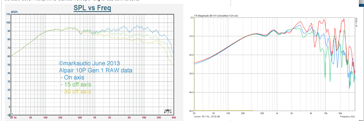

When Mark Audio drivers appeared I was excited by their frequency charts. But what's posted is not what most people measure. The trends (while you can see similar peaks and dips) are not quite the same. They may sound very good but I can't get a handle on their sound from looking at the charts. It's unfortunate because they may sound great. But there seems to be inconsistent praise / dislike for them similar to the measurements we've seen.

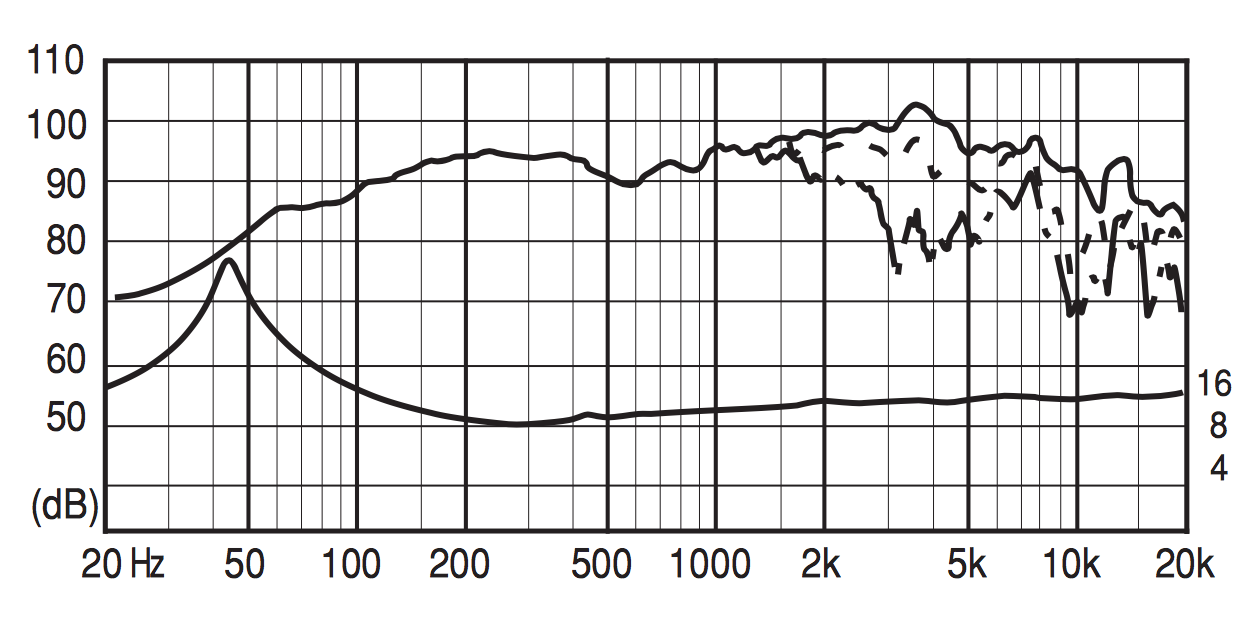

Their data isn't more useful than what Markaudio posts. They don't even care about labeling the off axis curves. Quite frustrating. See attachment.
It's typically 30° and 60° for Fostex AFAIK and they do sometimes indicate it (see my FF125K link a few posts back), but I agree they should make it consistently clear. The FF-WK graphs are a bit more brutal (and useful) in their less-smoothed nature.
If the customer has to guess what the product performance might be then there's something fundamentally wrong.

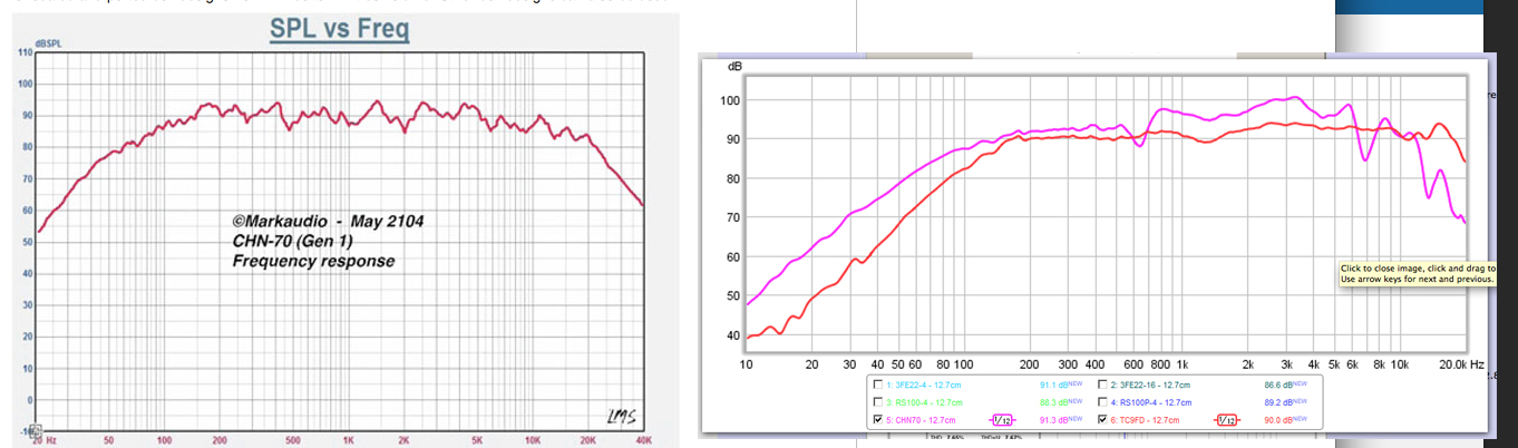

There are some that think it's frequency response that created this DDR
That is very hard to square with the differences shown between the VIFA & the CHN.
The VIFA has considerably better FR but is sorely lacking in DDR with the CHN.
After seeing the plots, and all the accolades from XRK i was expecting a lot more from the VIFA. Perhaps very heavy damping of the VIFA smooths its response at the expense of its ability to retain the small details?
or ringing
All FRs ring in the broadest sense of the term, since they would have no high frequency response if they didn't (that is physics). Uncontrolled ringing/breakup is another thing.
dave
dave
The uneven response could be the reason behind the DDR observed. It would emphasise some parts of the music and obscuring other parts. No driver with flat response would be guilty of that.
But there could be other factors at play, like distortion or ringing. But as I said, without a bit of work it remains just a guessing game. 🙁
