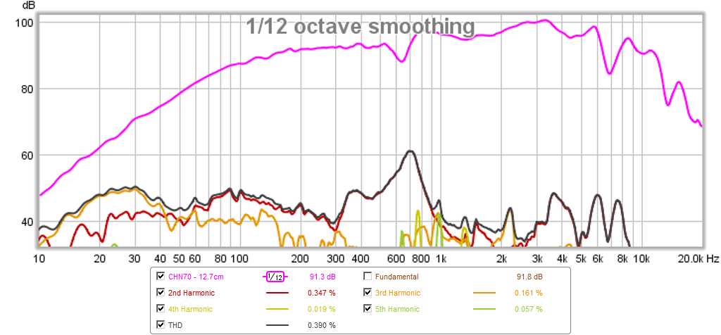

CHN-70 Measurements
The CHN-70, is a paper cone driver with published specs that appear suitable for many vented alignments, especially MLTL's and bass reflex. The $27 price puts it in the same class as the other drivers in this lineup - especially the RS100/P which has a similar Qts, xmax, and sensitivity.

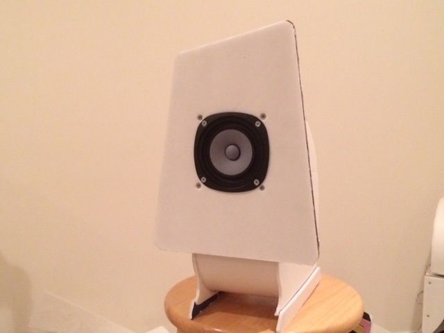

CHN-70 mounted in trapezoidal supra-baffle Nautaloss:

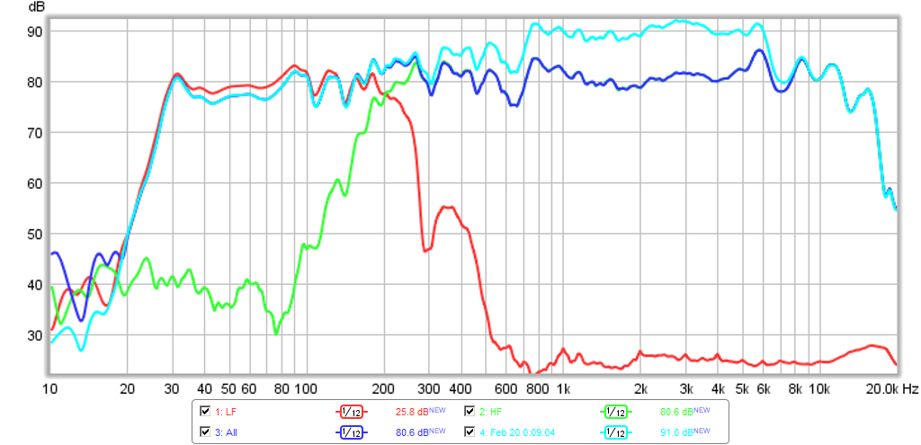

Upon measuring the response in the trapezoidal supra-baffle Nautaloss, I obtained the following response and harmonic distortion plot which was very puzzling: a big dip near 670Hz accompanied by high harmonic distortion there, and several other dips on high with a notable 12dB dip at 7kHz, and a rapid falloff above 12kHz. Initially, I thought my setup might be to blame, but none of the other drivers showed anything like this kind of response. In any event, I had to look deeper to make sure the measurement and enclosure were not the source of the dips and falloff.

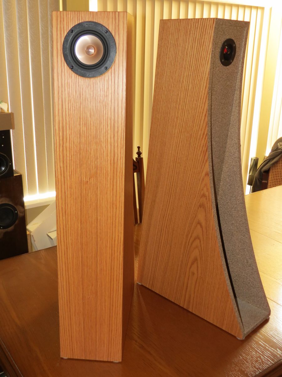

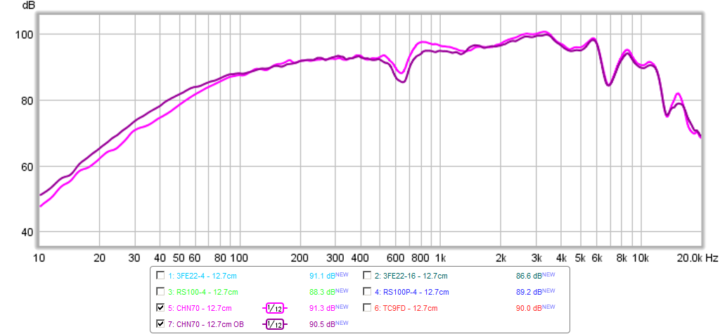

CHN-70 mounted in OB:
I thought that the Nautaloss chamber may be the source of this so I then proceeded to put it in a 24in wide x 36in tall open baffle and repeated the measurement. The OB data matches the Nautaloss data almost perfectly, which indicates that the dips are not caused by the enclosure. This test also shows that the trapezoidal supra baffle Nautaloss is very similar to an infinite baffle in that the rear chamber act's like a reflection free rear chamber.

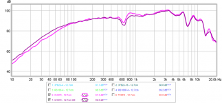

Comparison of Nautaloss and OB response:

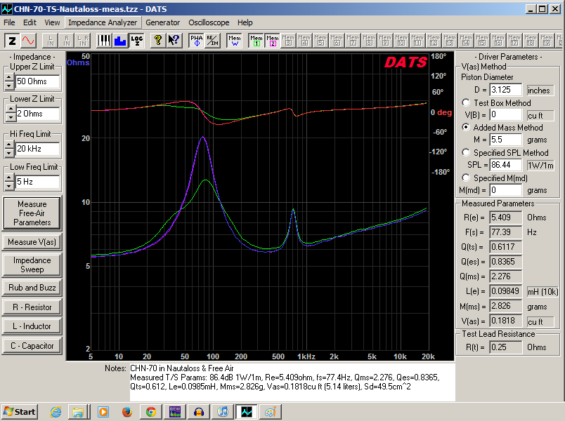

I then did an impedance sweep of the driver in the Nautaloss and in open air and see that the Nautaloss TL helps to smooth the impedance peak but there is a 700Hz peak corresponding to the dip and high HD, even in free air. I also measured the T/S parameters and the values are within family for the fs and Qts.
From DATS v2:
Based on this info, it appears that the dips and response seen are intrinsic to the driver and not the enclosure or the measurement method.

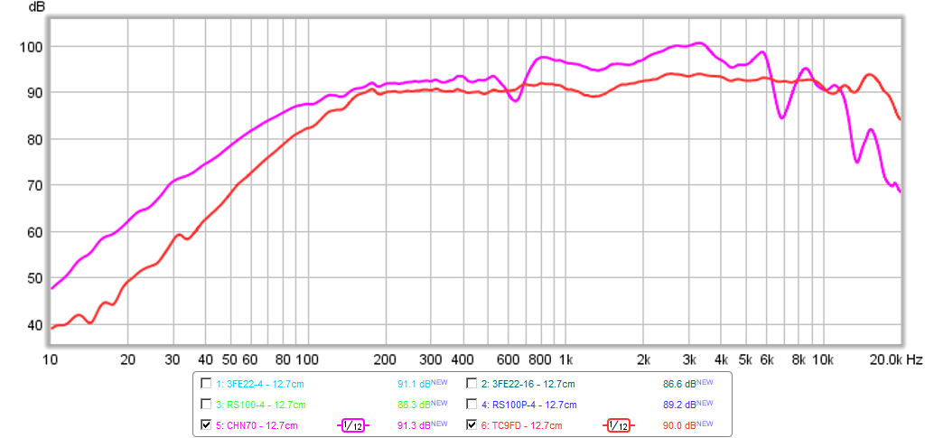

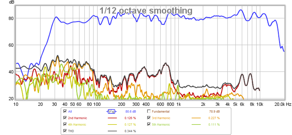

Here is a comparison of the CHN-70 and TC9FD:

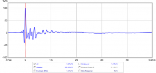

I also used a 670Hz sine wave generator and looked at the RTA to see what the distortion components look like. This is for 2.83v drive with mic at 1m away - most of the distortion is coming from the 2nd order.
Given the very uneven response and its lack of HF extension, I think that the TC9FD is the clear winner. The CHN-70, will have better bass performance in an appropriate enclosure as it has a lower fs and more xmax, as well as a moderate Qts very suitable for MLTL's and BLH's. However, the very high distortion in the midrange and dips and peaks will color the sound from how it was intended to be heard. I really was hoping to find a good driver for use in full range applications here, unfortunately, that was not the finding. I want to make it clear that I really did try to repeat the measurement using other baffles, looked at the free air impedance sweep and the anomaly at 670Hz is there regardless. If anyone else has a measurement of a CHN-70, I would like your feedback to see if what I have is a fluke or defective unit.

The impedance peak around 670 Hz is in the published measurements also, so, you are not seeing any anomalous behavior. But that big dip and peak smack in the midrange has got to be disconcerting. And the response up top is quite ragged also. Your 80 db scale is actually making it look better; it is much worse in reality.
