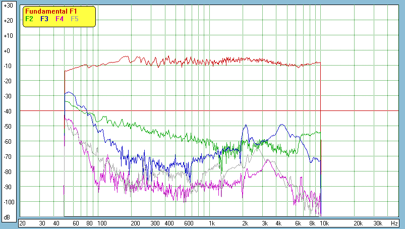

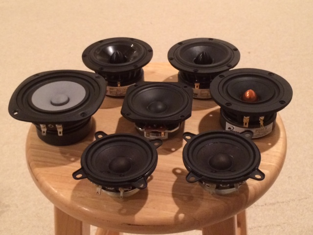

I received the Dayton Audio PS95-8 (point source 3.5in full range) today. It's a a very nicely made driver with superb fit and finish. The cast frame has slender little arms so that it obstructs the back wave as little as possible, there is a copper phase plug, an inverted rubber surround, and gold plated terminals. The cutout is exactly the same as the RS100 so that was very convenient.
Here are some photos of the driver and the new lineup of drivers tested:
Here is the measured harmonic distortion and frequency response at 12.7cm distance from cone:

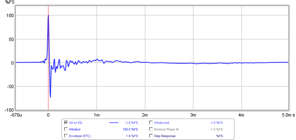

Here is the Impulse Response:

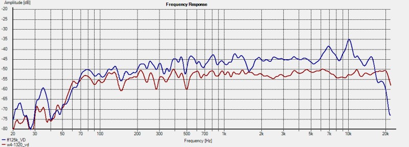

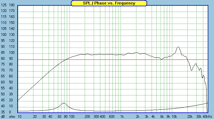

Here is the comparison with the TC9FD - not a bad performance:

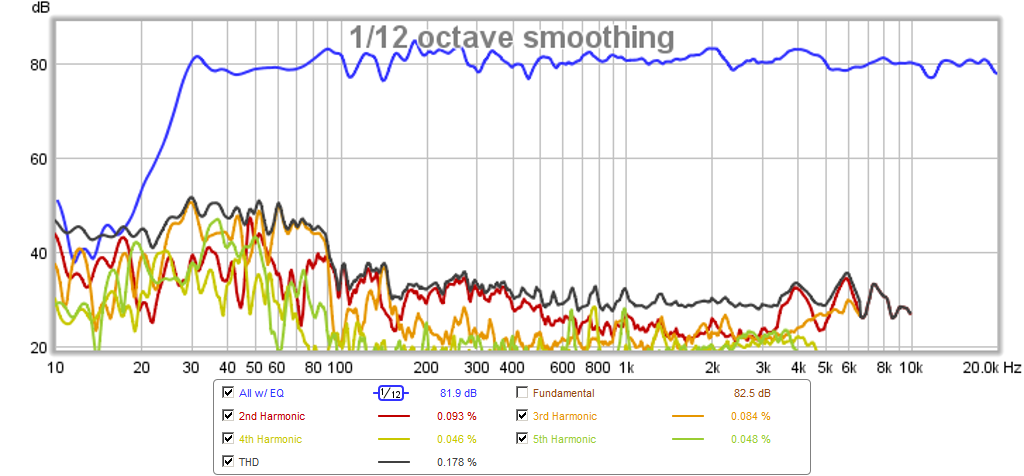

Here is the implementation in a FAST with an XKi dual W5-876E as the sub (http://www.diyaudio.com/forums/full-range/268524-xki-xs-ab-initio-karlson-6th-order-bandpass-26.html#post4226956), the is the XO (there will be two soundclips with and without EQ):
Here is the harmonic distortion:
