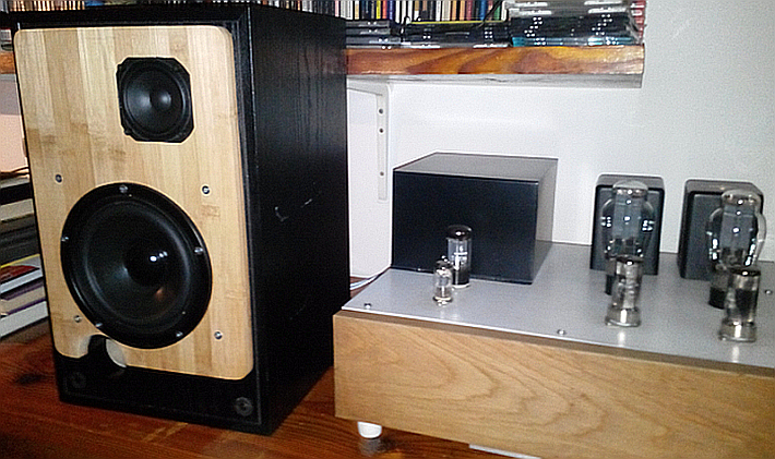

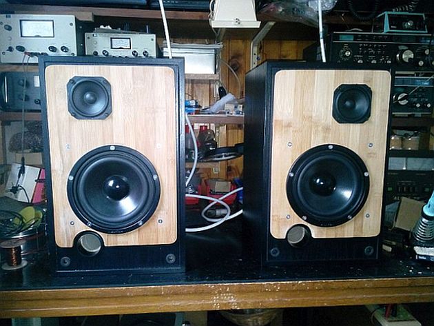

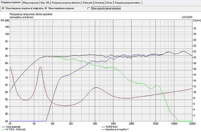

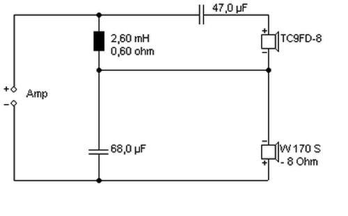

Just for fun I made a simple FAST. All components are from my attic except Vifas.
25 liters vented box with a round chamber for TC9.
TC9FD FRD and ZMA files are from Zaph measurements.
Simple series crossover with standard values for C and L.
These speakers are not fun, they're really nice sound with my SET amp. I still think, might be my main speakers in the future 😉
No measurements, sorry. Maybe when/if my acquaintance wills.
But from past experience I know that Boxsim is very reliable design speaker software.

Very nice. What woofer model is that ? Are you using electrolytic caps or poly-foil caps?
Thanks Byrtt. I admit, I did not expect such a good sound from these speakers. I'd go to make a neater bamboo face on the box.
Yes, I wanted to compare the possible difference with the newer production TC9, in relation to the time when the APH do measurements.
XRK, thanks for your help and suggestions about TC9.
Capacitors that I used are from my drawer. Basically, it is paralleling MKP and MKC capacitors higher values.
BTW, I am not of those who think that all capacitors in the crossover sound identical or good.

that looks great.
would you mind to upload the boxsim file and the boxsim model for the tc9fd?
thank you very much!
Boxsim is relatively easy to use, so a quite accurate model of the vifa is very welcome!
Did you measure that data yourself or did you get it elsewhere?
You are wellcome.
TC9FD files are from ZaphAudio measurements.
