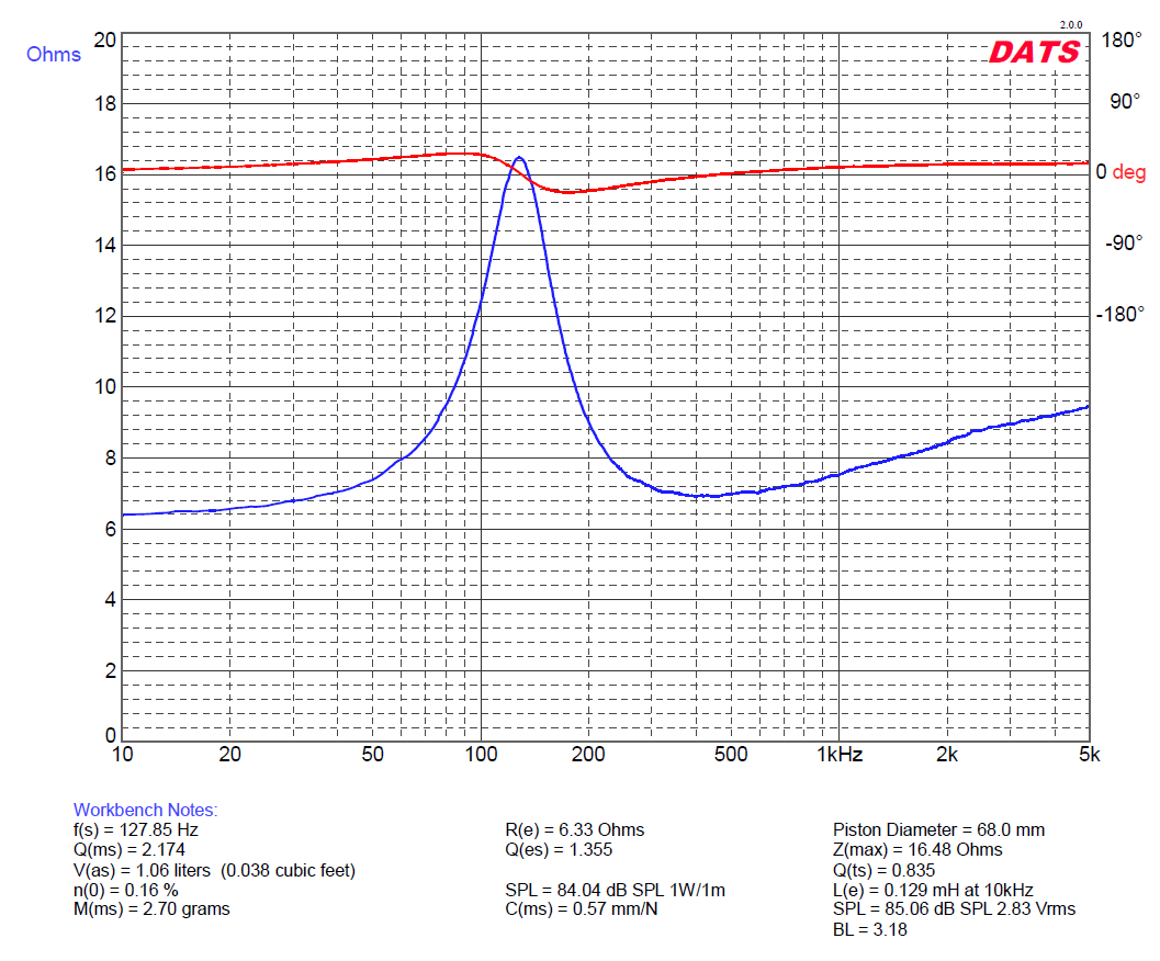

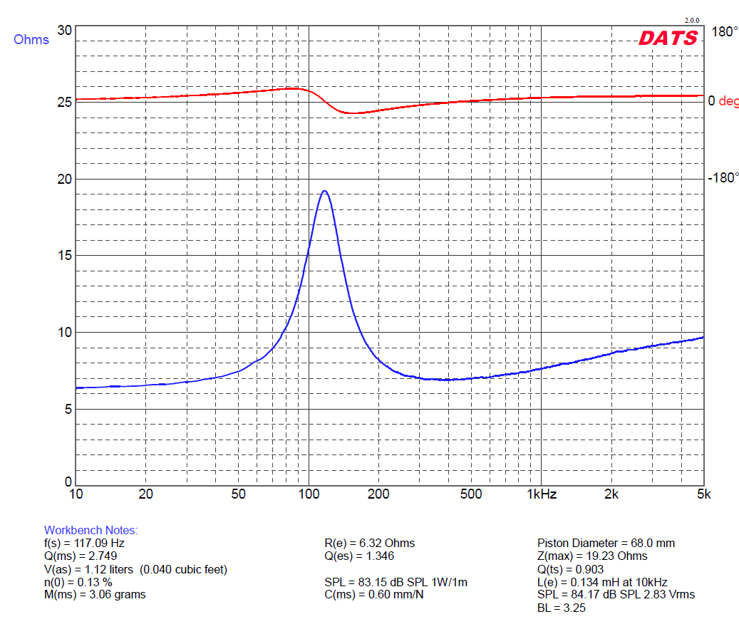

I just measured the TG9FD10-8 that I have and the Qts is quite a bit higher than spec, actually higher than my TC9FD, which is supposed to be 0.89.
Here is DATS T/S (using added mass) for TG9FD:
Here is DATS T/S (using added mass) for TC9FD:

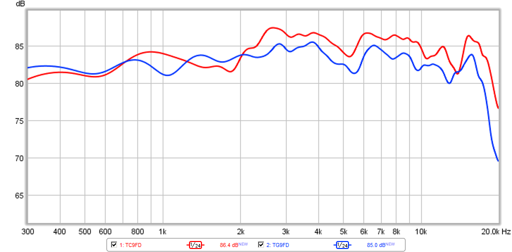

Here are some initial measurements in the Nautaloss and trapezoidal baffle at 0.5m, 0 deg, 0.71volts, no miniDSP - straight to amp.

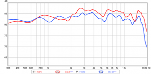

Freq response as compared to TC9FD - the TG9FD appears to be smoother than the TC9FD, but with a tad less sensitivity:
469763d1425585440-vifa-tc9fd18-08-best-bang-buck-tg9fd-tc9fd-compare-freq-response.png

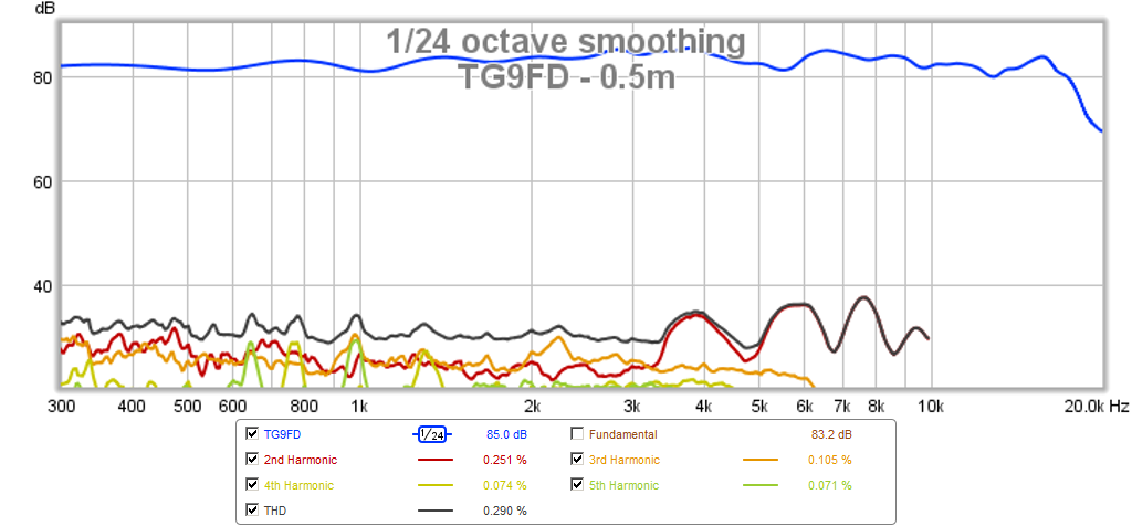

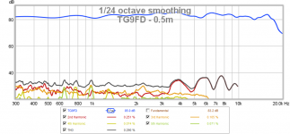

Harmonic Distortion is actually very low, not quite as good as the 10F/8424 but a very respectable performer:

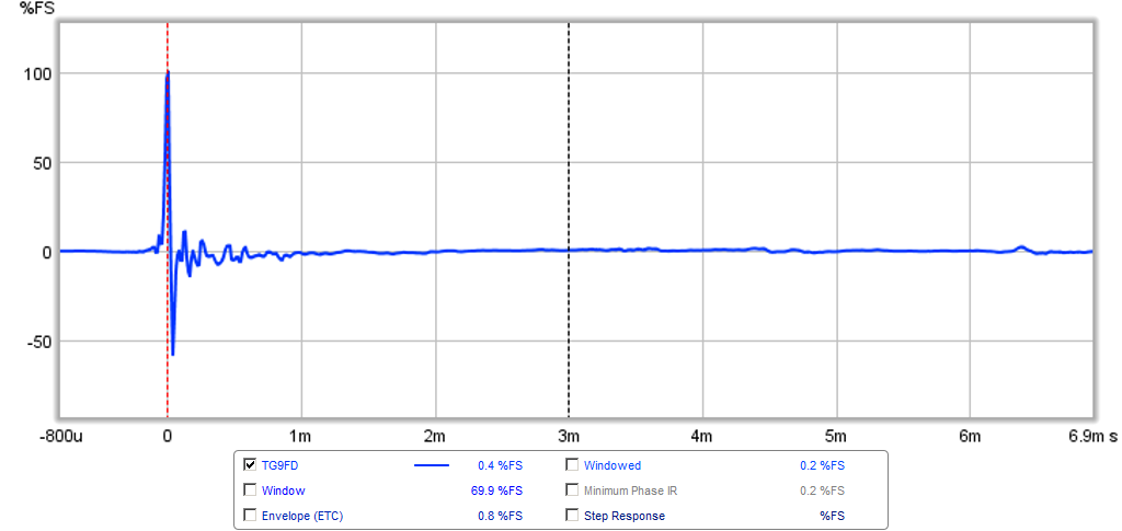

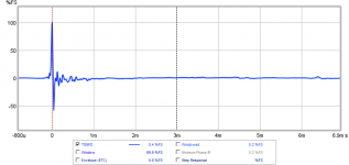

Impulse Response - very clean, almost similar to the 10F/8424:

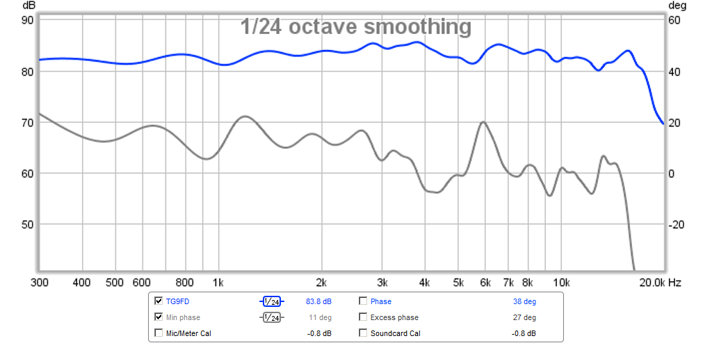

Minimum Phasen - phase variation is less than the TC9FD, not quite as good as 10F/8424:

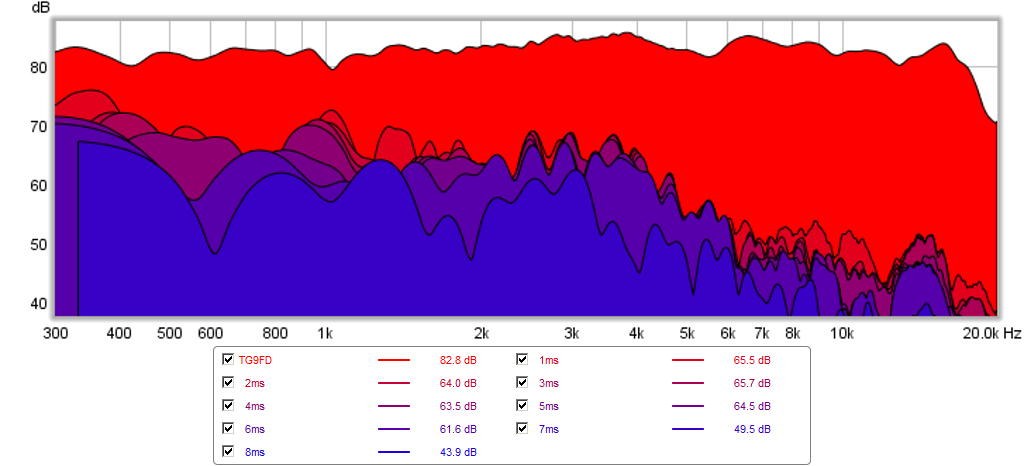

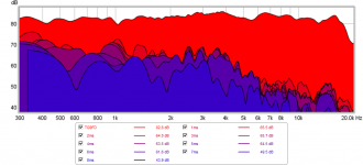

CSD:
Given the similar cone material between the TG9FD and the 10F/8424, this driver appears to be a low cost, less sensitive alternative. A very nice performing driver. Sounds very good too but have not had too much time to listen.
I wonder if break-in might loosen up cone and change the Qts a smaller value.

I am almost coming to the conclusion that the TG9FD10-8 may be the hidden gem here as it is smoother than the TC9FD. For double the price - it may be well worth it given how close it is to the 10F/8424. You will have about 1.5dB less sensitivity though.

Seems my guess wasn't wrong and it's in the middle of the other two as it's price suggests based on measurements. Maybe even closer to the 10F than to the TC9.

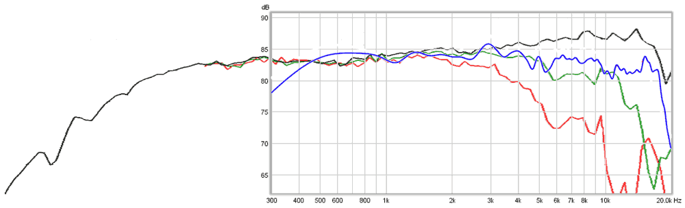

X asserted that all but one of his measures closely mirrored the factory data but for the MA CHN70. I scaled all the graphs to do a proper comparison. None of his measures matched factory (X has those graphs). Except for the PRV they were equaly far apart. For completness here is XRK vrs factory for the 10F. Blue is X, factory is black

The 10F was measured at about 10deg off axis as part of the FAST setup, hence the response is lower - approximately where one would expect it to be. You love pointing out how flawed my measurements are - I don't hear anyone else complaining or nit picking. Get over it and stop trolling.
