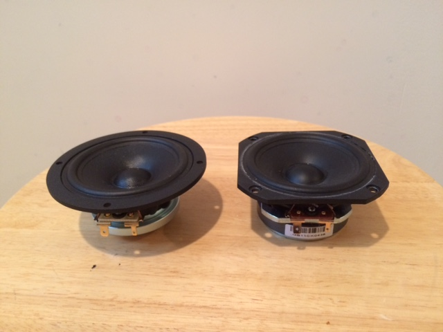

Here is a photo of the two drivers:

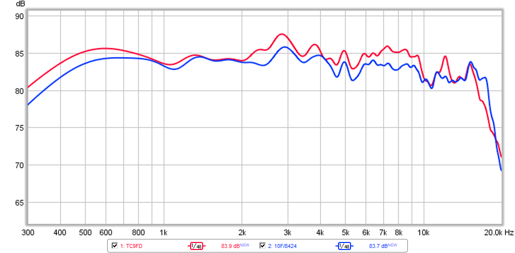

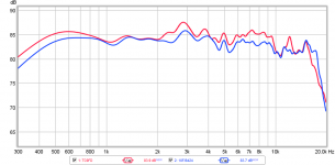

Here is the frequency response for the 10F/8424 vs the TC9FD (5dB/division, 1/48th octave smoothing), the 10F/8424 is smoother, has higher extension, and loses the 12KHz breakup peak - an excellent full range driver that is essentially free of breakup peaks in the 6kHz to 14kHz range - very rare to find this:

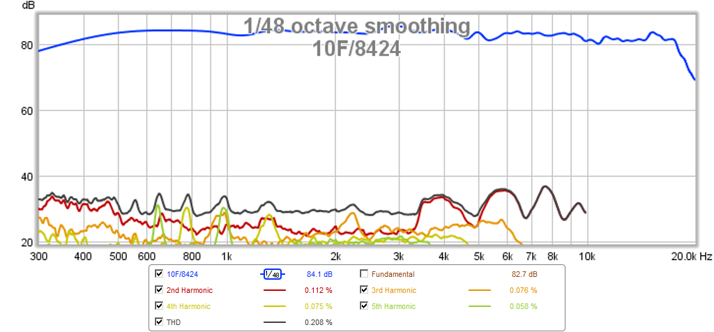

Here is the harmonic distortion of the 10F/8424 (slightly better than TC9FD):

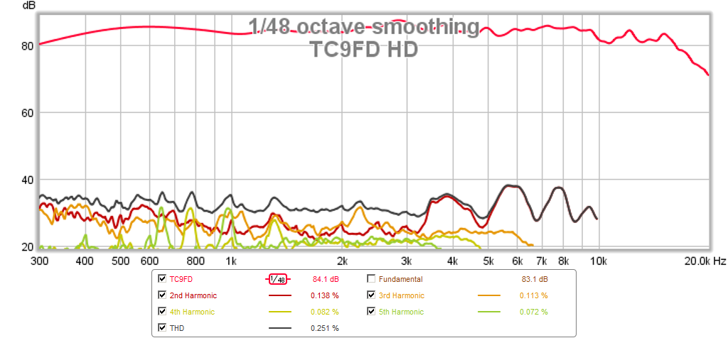

Here is the harmonic distortion of the TC9FD:

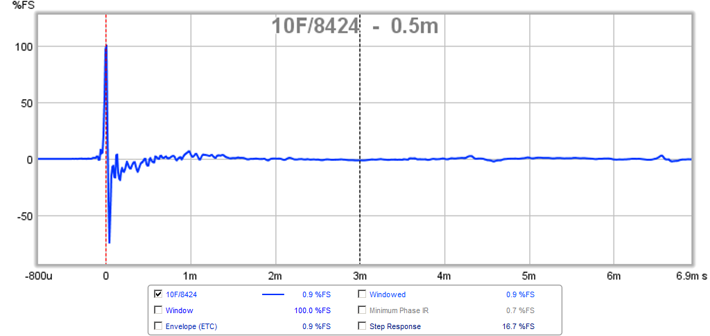

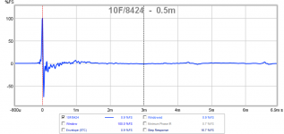

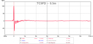

Here is the Impulse Response of the 10F/8424 (you can see first reflection at 6ms which is why I used a 4ms gate), it has less ringing than the TC9FD:

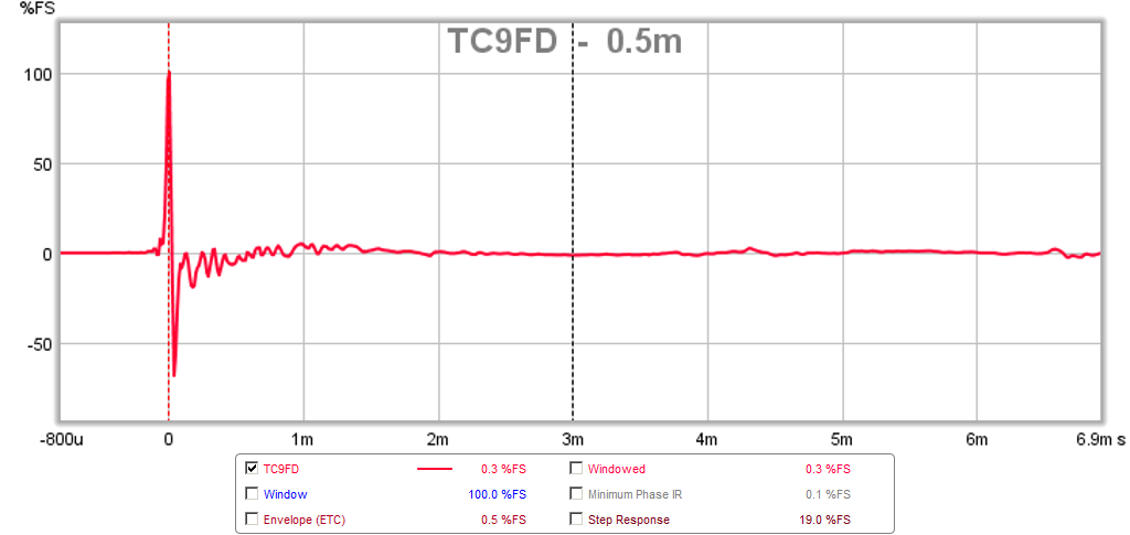

Here is the Impulse Response of the TC9FD:

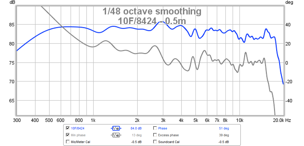

Here is the Minimum Phase of the 10F/8424:

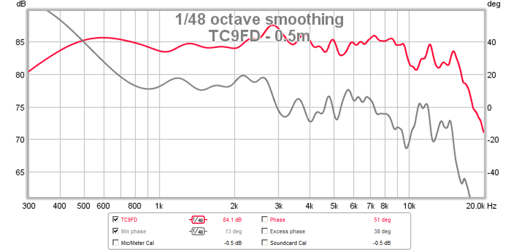

Here is the Minimum Phase of the TC9FD:

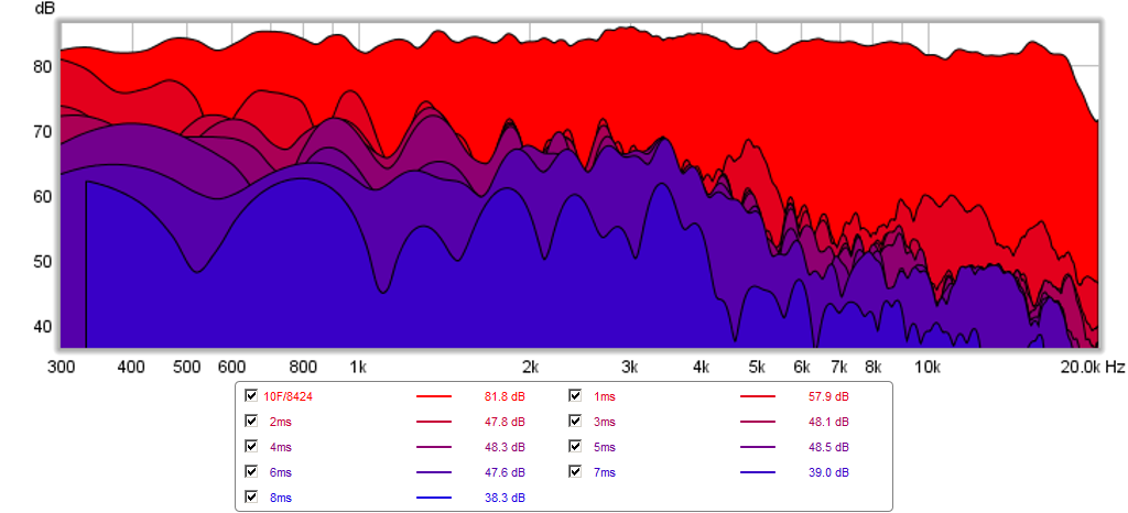

Here is the CSD of the 10F/8424 with 0.1ms risetime and 4ms window:

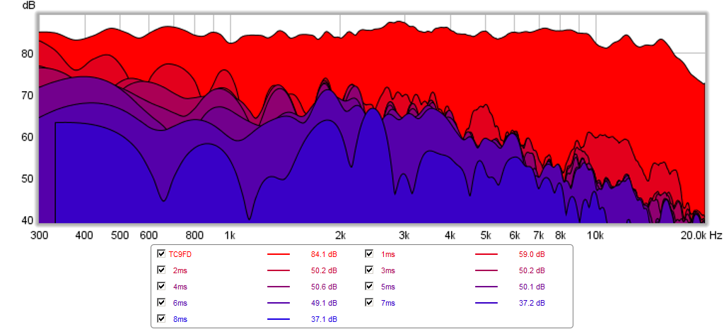

Here is the CSD of the TC9FD with same settings:
The measurements clearly show that the 10F/8424 is a better driver than the TC9FD, but at almost 10x the price, I am not sure if it is that much better. The main advantage is the smoother frequency response with cleaner impulse response and slightly lower harmonic distortion. Under a listening test, I am not sure one could pick out the two - but we will see when I compare sound clips in the other thread.

Do I see a little family resemblance here? Looking at both cones...
Almost looks like comparing the Vifa XT25 ring radiator to it's high cost Scan Speak sisters.

There used to be a time when they were all under one roof... don't know the history of the TG/TC line and the Scan Speak 10F but the XT25 tweeter from Vifa does have family ties.
