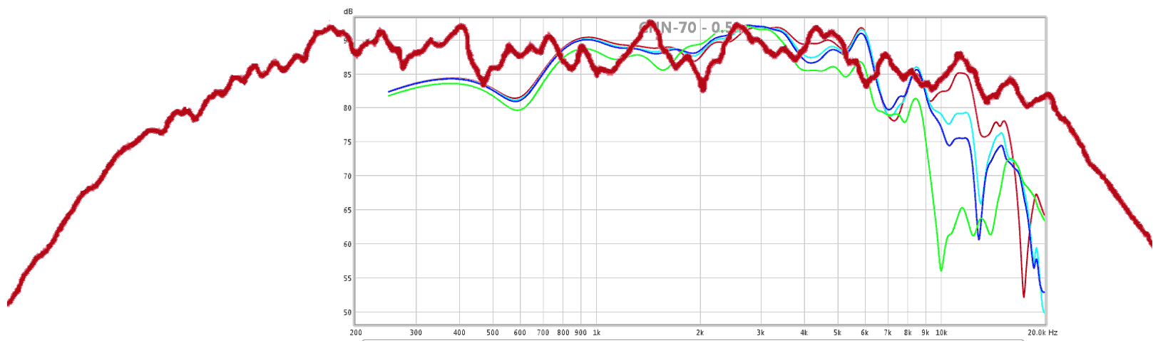

Why is it black line because it's a high resolution data that you try to explain is same as red line consumer datasheet that you had made an error to, but the error is too big those two not the same, and probably why you deleted because of realizing.

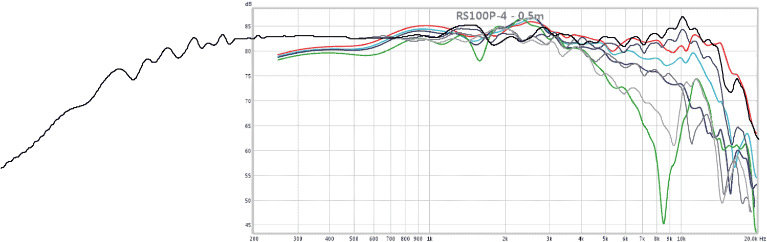

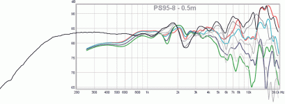

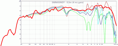

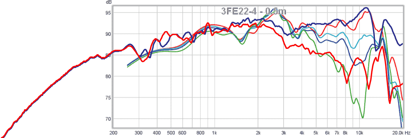

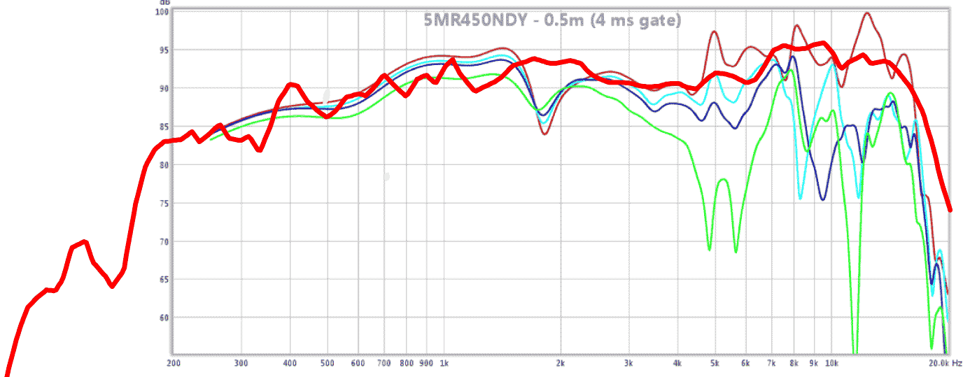

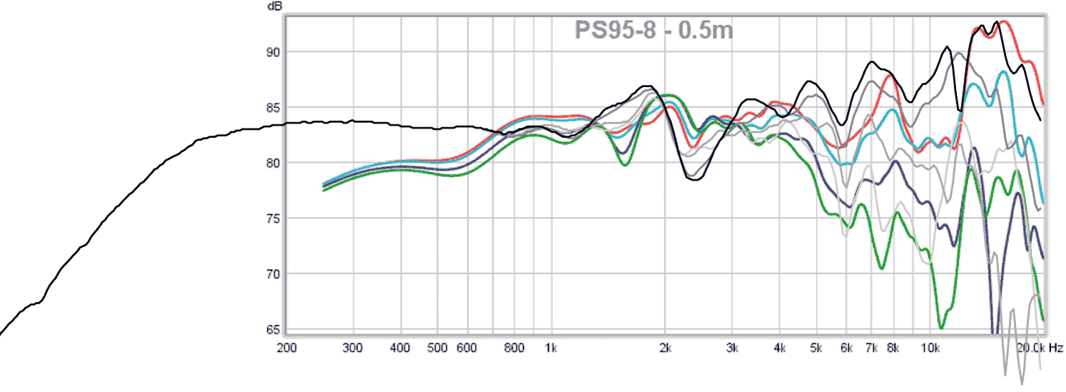

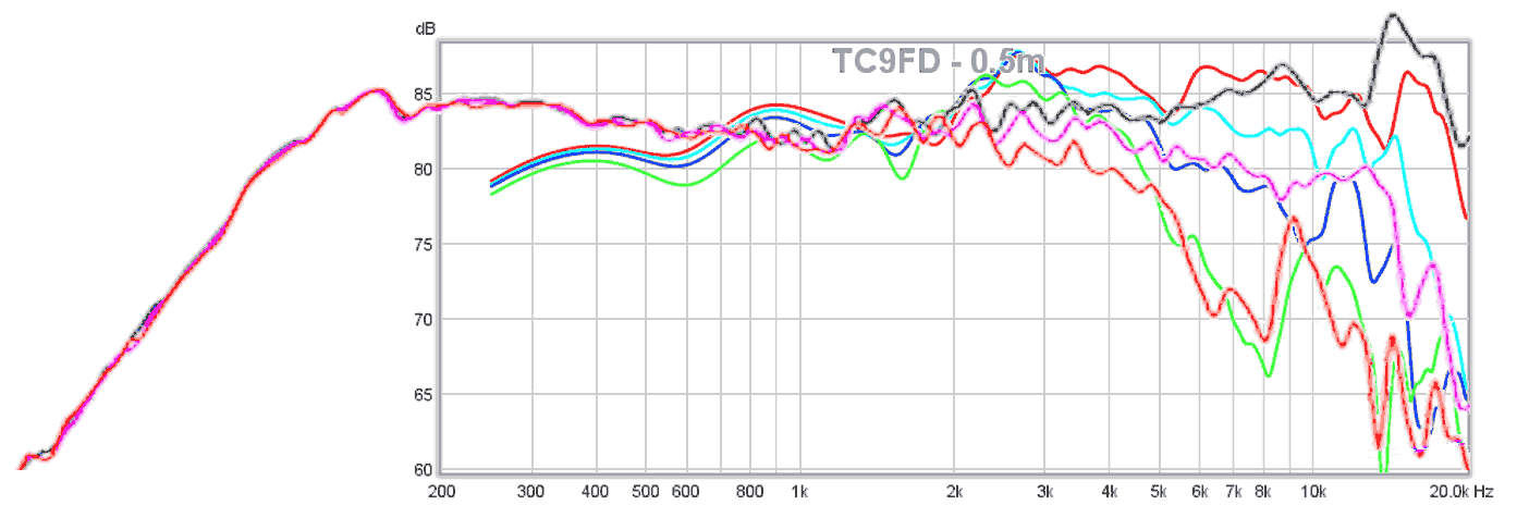

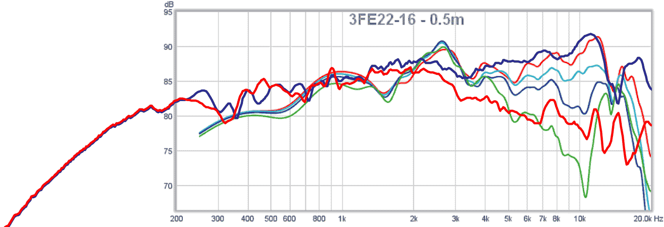

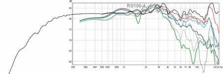

I am not sure what you are trying to say. I replaced graphs where i had mistakingly scaled the data horizontally by lining up the 20 Hz of the factory to XRK's 200 Hz (i had missed that XRK had truncated his graph). Ryan pointed this out, i corrected the error and replaced incorrect graphs with correct ones.
I have attached the rest of the set (factory data vrs XRK) so people can make their own judgements to the veracity of XRK's claim of that his data matched the factory. No 10F data yet, since XRK changed his measure technic which makes it different than the rest. Also no PS95 graph, as i could not find factory data. As well, one has to mentally smooth the CHN70 data to have it make any sense.

Lots of pretty colorful lines. Which is which? There seems to be some correlation in some plots but none in the Markaudio plot.
Why are we comparing factory data to what X measured anyway? Hasn't it been established that manufacturers go to great lengths to make their drivers look best? Wouldn't it be more helpful if others would post their measurements? Didn't you promise to do so?

Once again your #439 over there had for some hours the plot which you have deleted because you can and now hide for us for, how i have this read again #245 http://www.diyaudio.com/forums/full-range/268626-vifa-tc9fd18-08-best-bang-buck-25.html#post4248817, and this plot have ever never been same as the one you feed us now, no hills and valleys those two to match and mistaken scaling is impossible too especially taking into to count your many years Adobe experience. Now you are nit picking verse datasheets when scaled correct but take a look as is from manufacture and tendency is best the others compared your child. A question is do you accept the frequency response revealed for CHN-70 by comparison thread and Japanese site as you did by showing the deleted plot picture saying "For CHN-70. Factory data (Earthworks M30 in anechoic chamber on IEC baffle using LMS) scaled and laid over top XRK's", it looks like it when you now show the datasheet factory painting.
And now lets talk DDR 😡, no but it will be good to hear if you accept the relative steep curves at 700 and 6000 area which make it a good midrange with splendid off axis.
I still don't know exactly what or why you are going on. I deleted 2 wrongly scaled graphs and replaced them with properly scaled graphs. The mistake was made because XRK chose to truncate the charts at 200 Hz, and, in a hurry, i assumed the standard 20 Hz, not paying sufficient attention. All the rest of the post was valid.
Are you giving me a hard time, because i paid attention to another members observation, correct MY mistake and replaced invalid data with valid data?

They were not wrongly scaled graphs and replaced them with properly scaled graphs, it was the one i showed #245 this thread also a CHN-70 but raw high resolution and if smoothed close to xrk971 and Japanese plots, that one you deleted after several hours because you can, had you not had moderator privilege you have had to answer why new MA factory data is not as MA datasheet. Can't bring the original picture to surface else than the thread print i showed so stop here can't go forever.
Again do you accept the relative steep curves at 700 and 6000 area shown xrk971, Japanese, and your deleted plot, or are they still wrong and actual performance as datasheet or simply better.
That is the comparison of the SS 10G factory data to XRK's, As XRK has said, his data is 10 degrees off axis, so this chart is not showing anything useful. Why XRK chose to switch from on-axis (his other measures) to10 degrees off i do not know.
My 1st CHN chart was incorrectly scaled and used MA data i has on my HD. I replaced that plot with one correctly scaled and using factory CHN data supplied by XRK.
If i did not have moderator priveleges i would have asked a mod to replace the invalid chart with the valid one. That is something any one can do and is encouraged to do.
The one that disappeared was crap.
Why are you obsessing over this? You prefer to use known invalid data?
