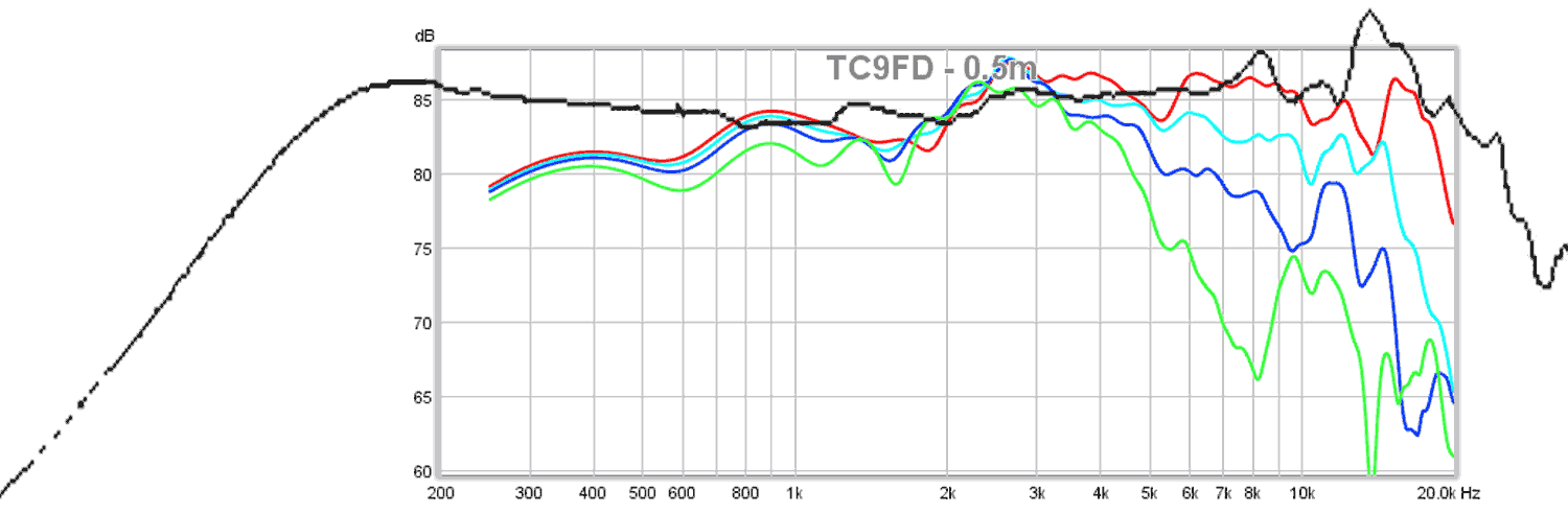

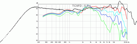

Zaph's measurements are fairly similar to XRKs measurements too
Zaph compared to XRK TC9FD
