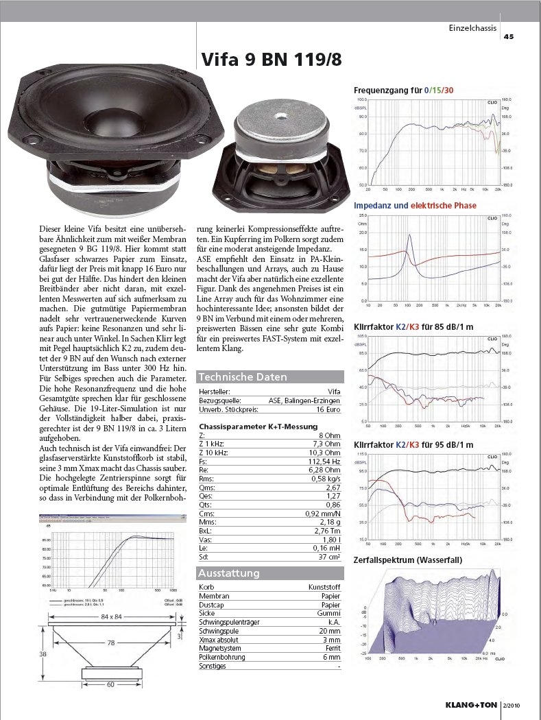

Believe it or not. The TC9 was cleaner in distortion plots at 95 dB than the 10F at same drive level from 250 Hz and above 😱. Pretty amazing right?
Look it up in Klang und Ton test of 19 full range speakers February 2010.
The 10F did win in the waterfall plots. I'd love to see similar data on the Visaton B80.(*)
By the way, in distortion it (the TC9) also beat the Audience A3, 3" driver with 12 mm xmax, costing even more than the Scanspeak.
That driver (Audience A3) had the best waterfall of all the tiny drivers though.

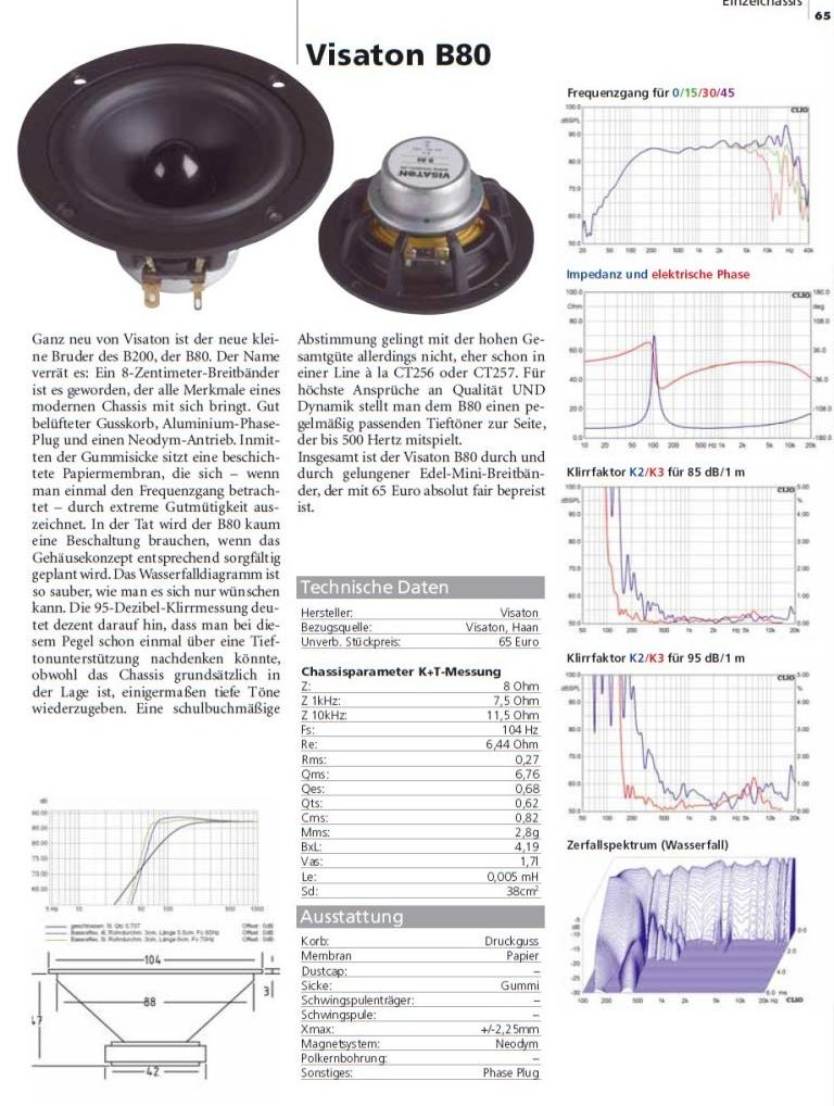

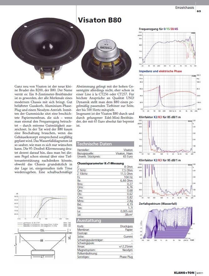

(*) just found some data plots from that one:
6/2011The 10F did win in the waterfall plots. I'd love to see similar data on the Visaton B80.
Here's the TC9, still not embarrassed by the Visaton...
I like the off axis performance of the cheap driver better and the distortion as well. Waterfall is a close call.
Not noticing the enormous quality difference you spoke of though.

am I seeing it correctly that K3 at 95dB was better than 40dB down to 300Hz for the little Vifa?
Slightly even better in lower frequencies..Here's the TC9, still not embarrassed by the Visaton..
In middle and high Visaton has less distortion.. also smoother frequency response..
Did you notice the rise of K2 below 500 HZ at 95 dB drive levels in the Visaton compared to the same range in the TC9?
I would consider the Scanspeak the better driver on paper. For me the TC9 does more things right than the Visaton judging these graphs.
Not only looking at distortion here. You've got to admit though that crazy cheap Vifa does very well on paper. Disproving your original statement about more expensive drivers being better.

Of course, that's why I use it above 500Hz..Did you notice the rise of K2 below 500 HZ at 95 dB drive levels in the Visaton compared to the same range in the TC9?
Measurement for Vifa and ScanSpeak are not identical compared to those for Visaton.. first two have distorsion in dB, last one in percentage.. when calculated 10F and B80 are very close, TC9 slightly worse..
