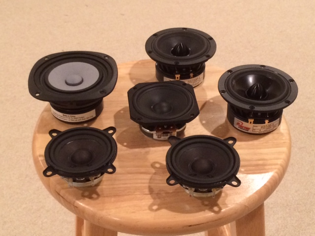

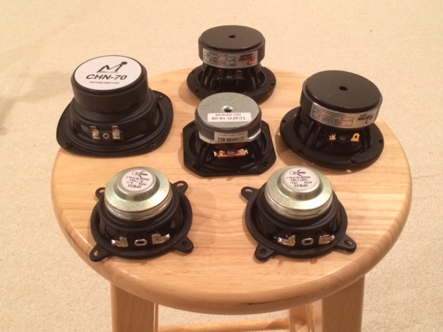

I can't believe I have 7 different drivers to test now:
1. TC9FD
2. 3FE25-4
3. 3FE22-4
4. RS100P-4
5. RS100-4
6. CHN-70
7. PS95-8
Technically 8 because I also have 3FE22-16

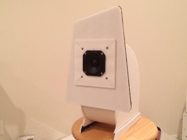

Once I converted the metric dimensions above to inches, I get a baffle that needs a 4.43 ft wide x 5.41 ft tall, which is larger in width than any standard piece of plywood one can buy. I am not about to make a multi piece baffle to satisfy the IEC standard. The standard is an exceptionally large baffle, perhaps larger than any practical OB anyone would care to use in a home.

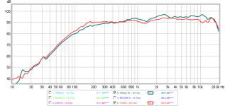

In order to get moving on the measurements quickly, I have developed a hybrid compromise of using the Nautaloss spiral sealed TL as the rear "semi infinite" chamber coupled with a trapezoidal supra baffle to minimize baffle edge diffraction effects. There will still be baffle step losses, but that will be a given as these drivers will be used in practical loudspeakers of typical widths ranging from 6in wide to 12in wide boxes. If all drivers are subject to the identical supra baffle, the baffle step effect is controlled and identical. An adapter is used to allow various drivers to be installed on the same driver centerline with the identical supra-baffle.
Dimensions of trapezoidal supra-baffle (edge lengths): top=7.0in, bottom=12.0in, left=11.25in, right=13.0in. Driver centerline is 5.0in from left bottom corner and 6.0in up from bottom edge.
Here is the measurement in a trapezoidal supra-baffle mounted on the Nautaloss with a TC9FD. The measurement is near field with mic at 12.7cm away. I think the design seems to provide a very smooth response in the near-field.
What do you all think of this approach?

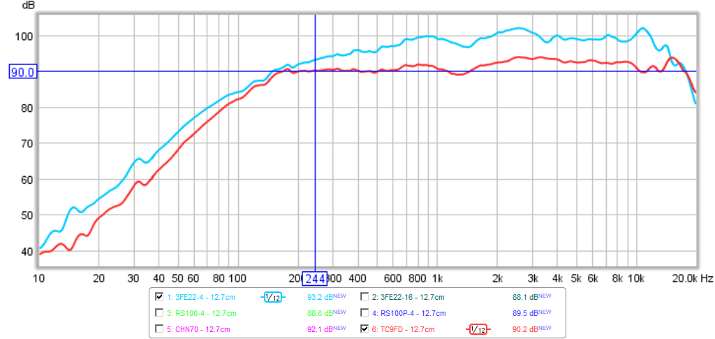

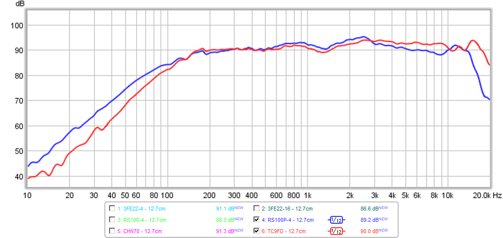

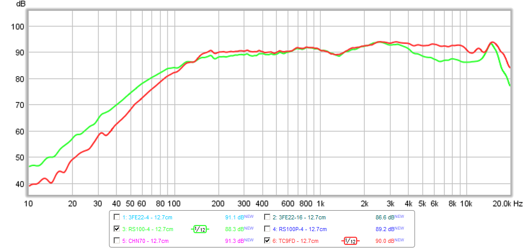

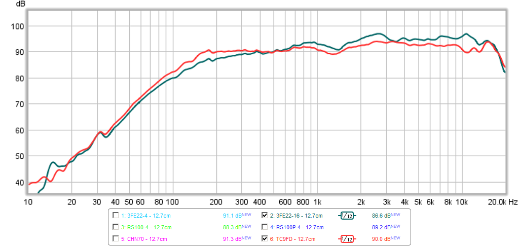

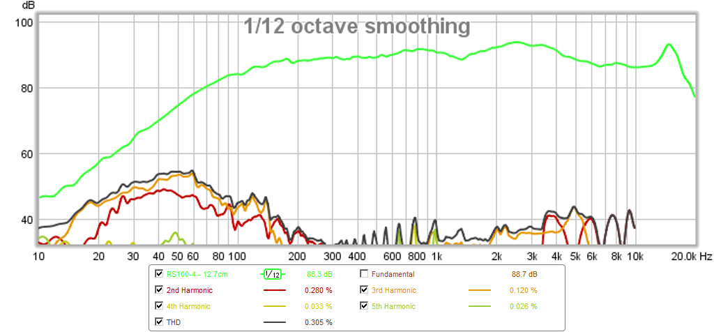

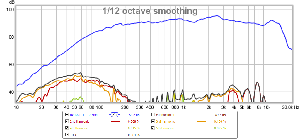

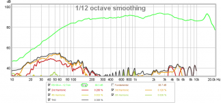

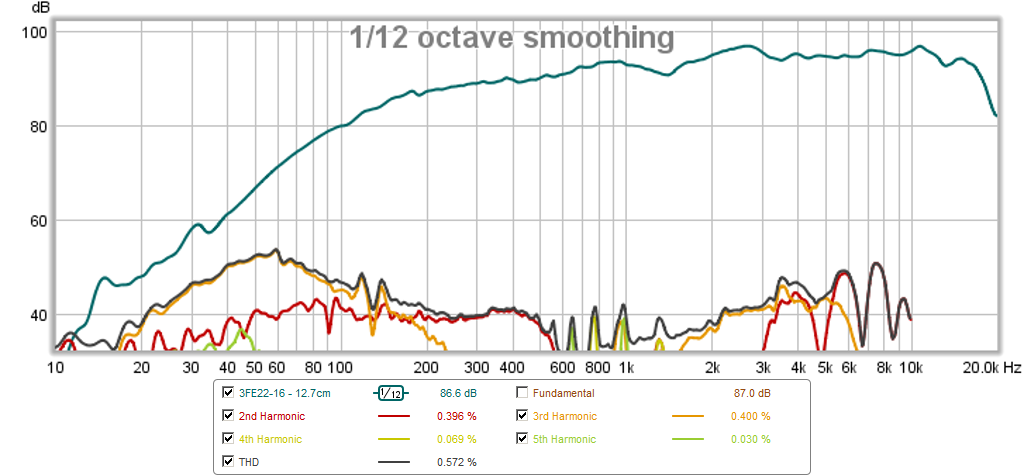

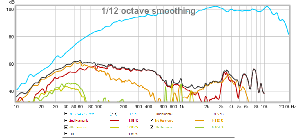

Using the same trapezoidal supra-baffle and Nautaloss rear chamber as the base test setup, I measured the following drivers at the same 12.7cm mic distance: Faital Pro 3FE22 (4 ohm), 3FE22 (16 ohm), Dayton RS100-4 (aluminum cone), RS100P-4 (paper cone).
Here is the lineup of the drivers to be tested:
3FE22-4:
3FE22-4 Compared with TC9FD:
3FE22-16:
3FE22-16 Compared with TC9FD:
RS100-4:
RS100-4 Compared with TC9FD:

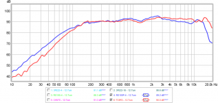

RS100P-4:
RS100P-4 Compared with TC9FD:
As you can see, the 3FE22-16 is probably the closest to the TC9FD in smoothness and flat response and reach. The 3FE22-4 is about the same but since it is a 4ohm driver, it has more excursion and more SPL so the HD is higher for same drive level. If you turn down drive level, probably about the same response as the 16ohm version (this may be a good option for those with high impedance tube amps). The aluminum cone RS100-4 has a sharp peak near 15kHz that will show up as ringing and sibilance. So far, the TC9FD is really the star here. The shallow depression near 1.4kHz appears to be consistent between drivers and is probably a characteristic of the Nautaloss cabinet.
