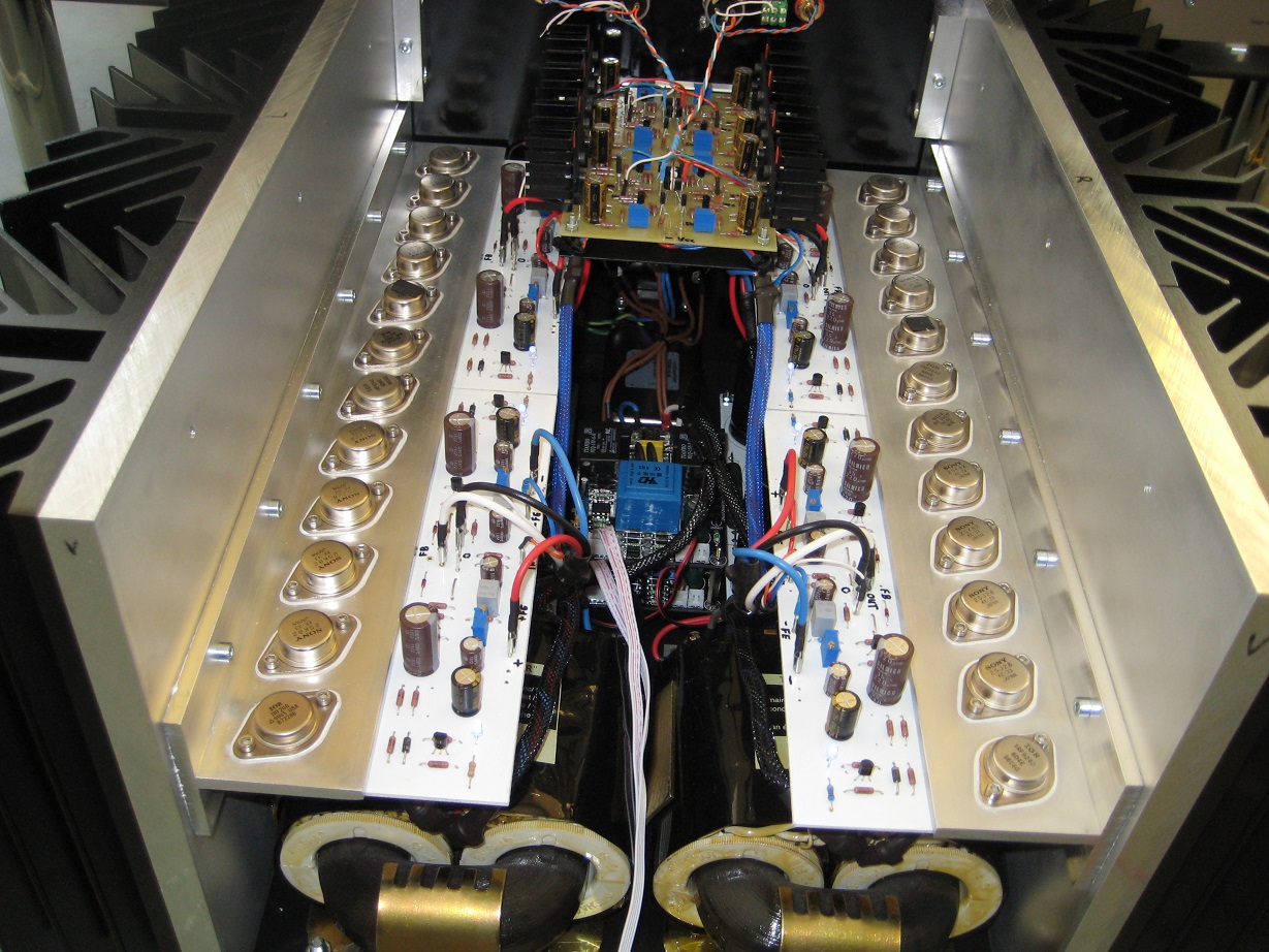

See post 46, there are already 3 holes in the heatsinks, I tapped M5 thread in the big aluminum plate, and each heatsink is mounted to the plate with 3 M5 bolts.
They are visible.
I tested without thermal paste and the heat transfer is already great. But for final mounting I plan to apply a thin layer of thermal paste.
They are visible.

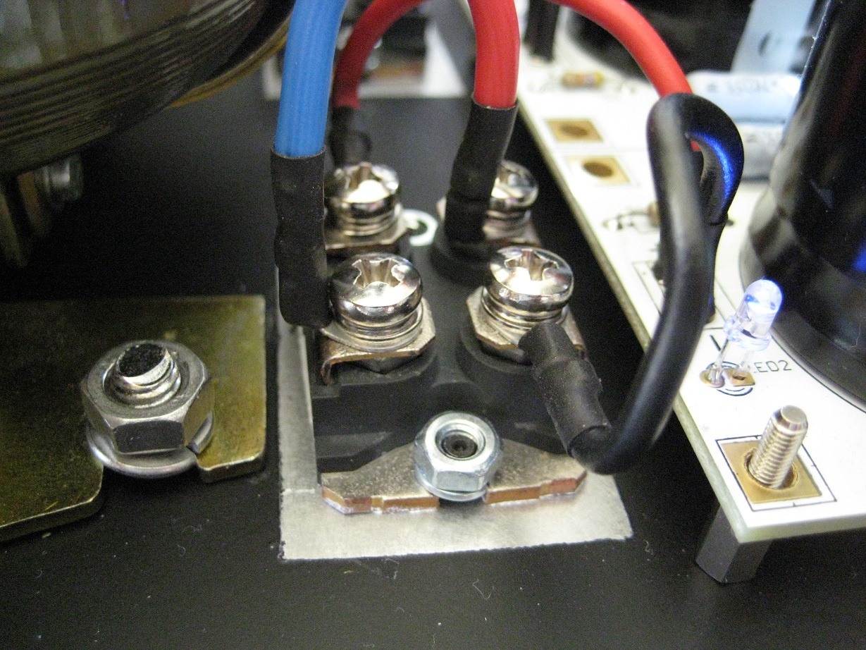

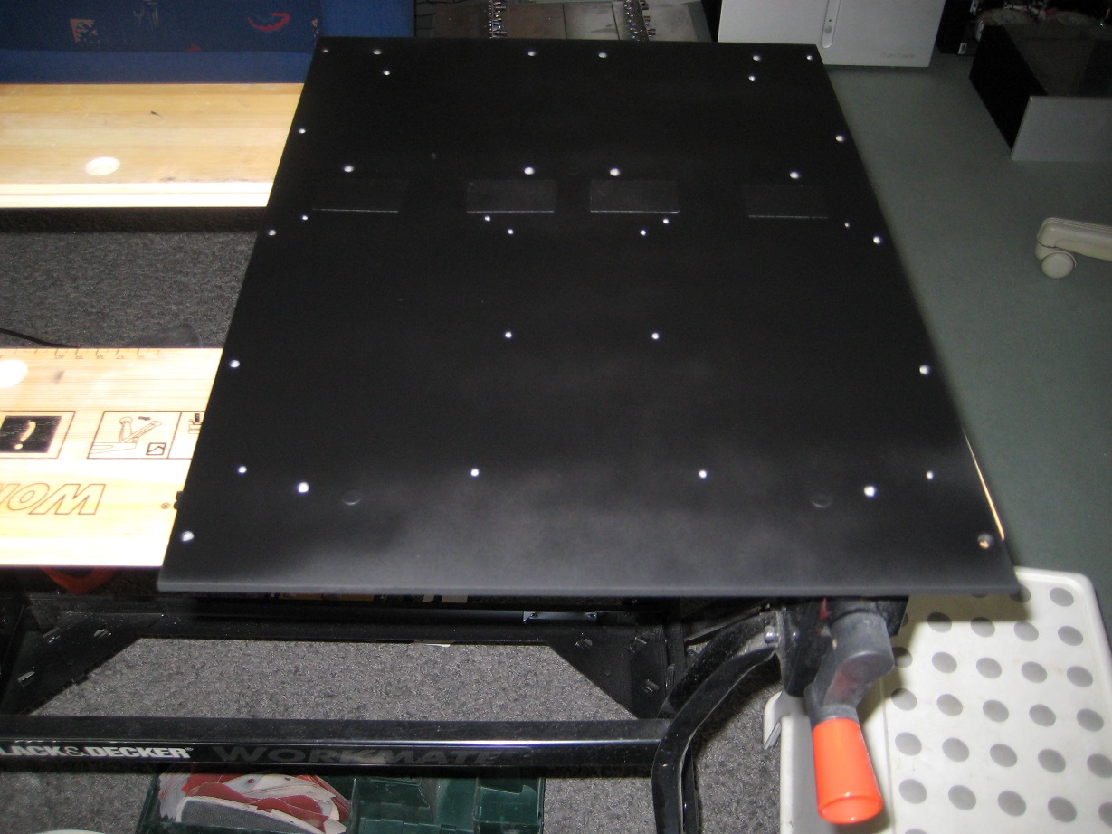

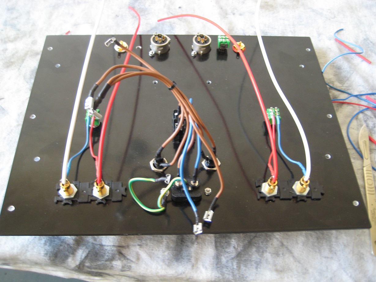

Finished spray painting the 5mm thick bottomplate. The tape is where I want to put the rectifier-bridges and some chassis connections.

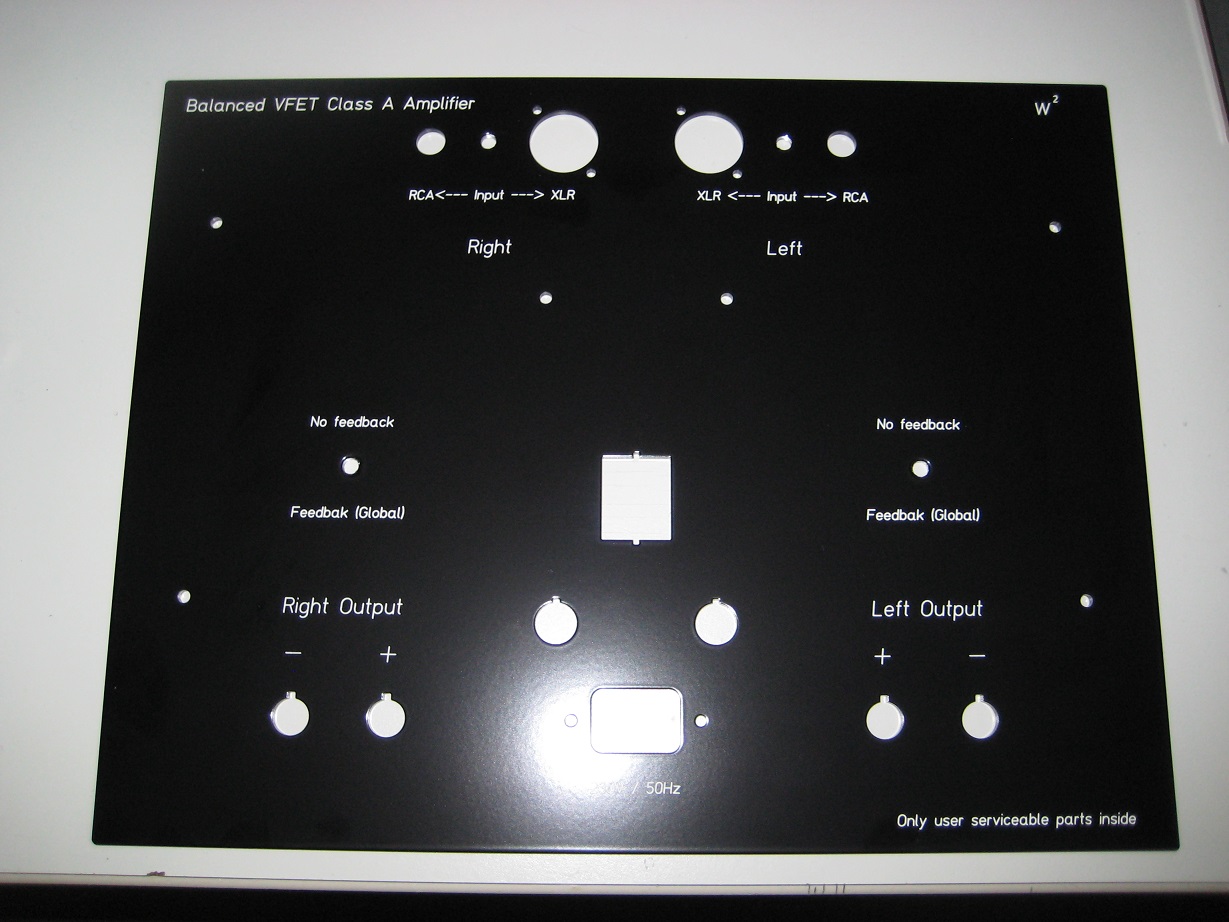

Also the backpanel has arrived from CNC and engraving. It is powdercoated in black. I like it very much. Normally I use anodized black panels, but this seems more scratch resistant.

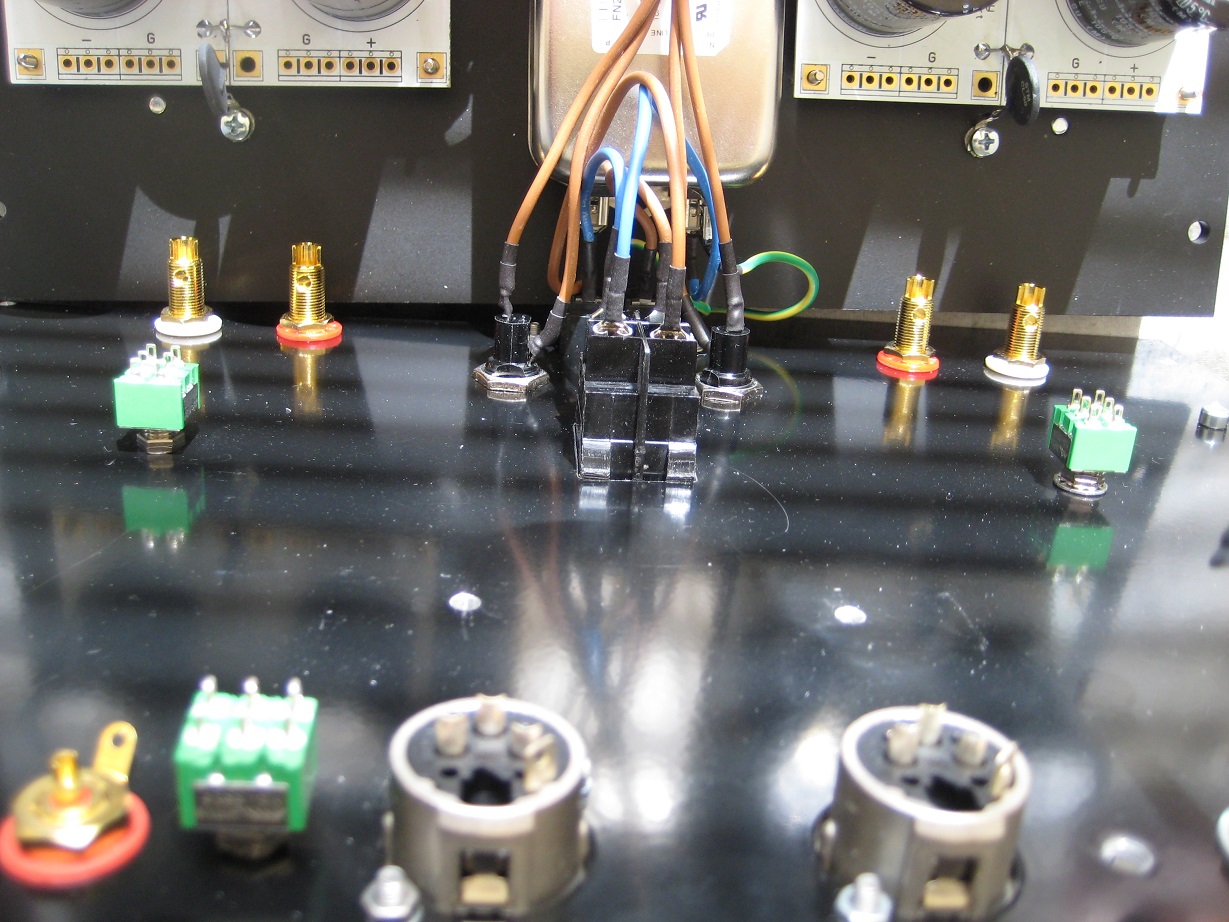

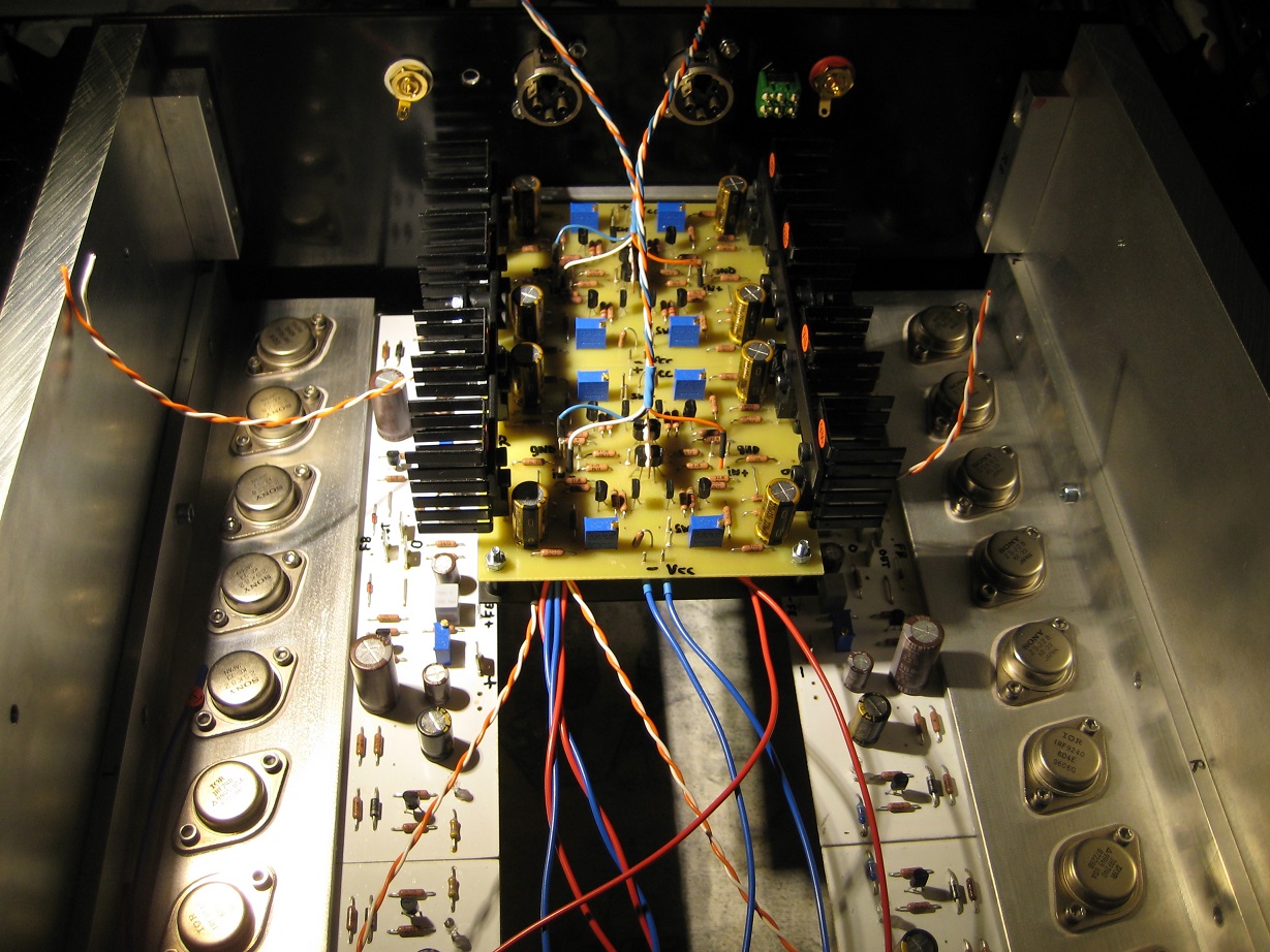

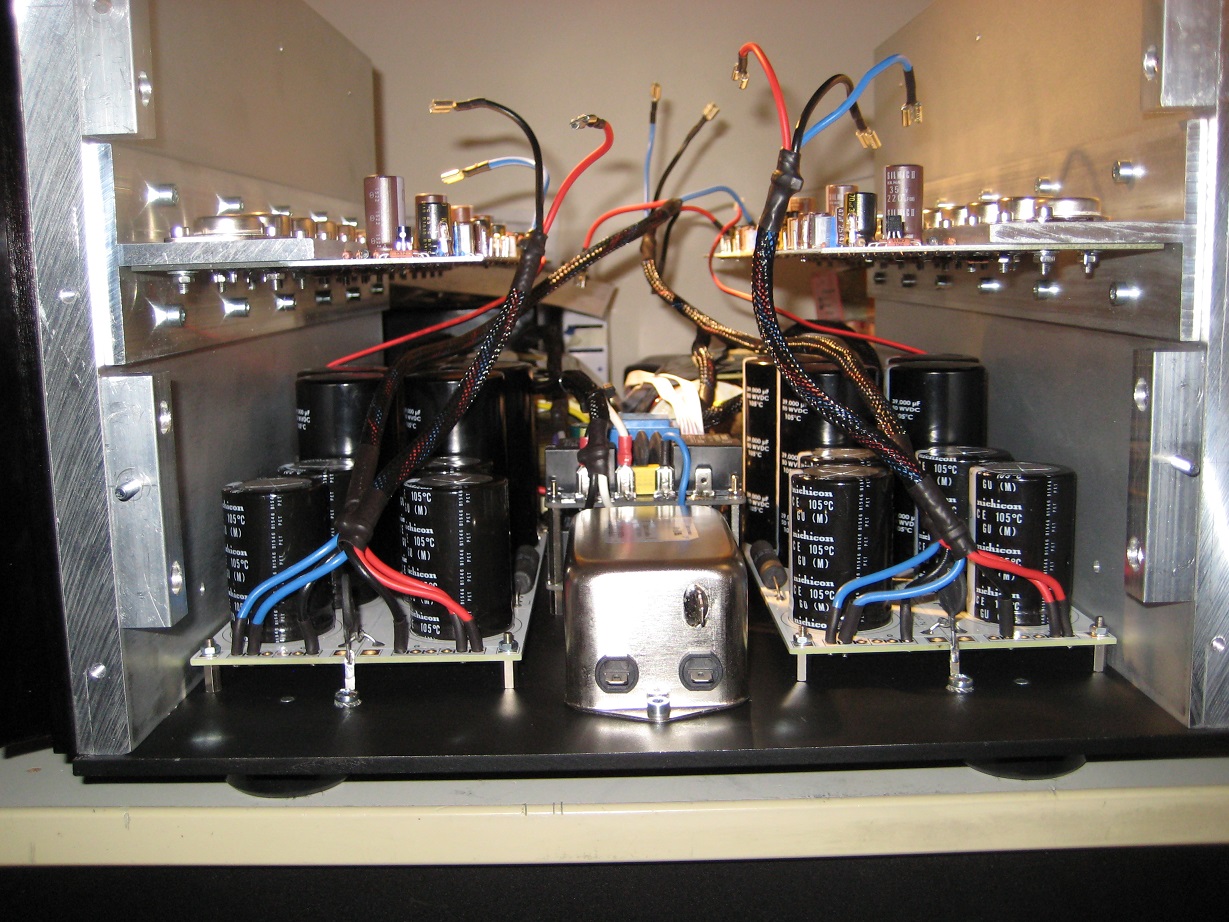

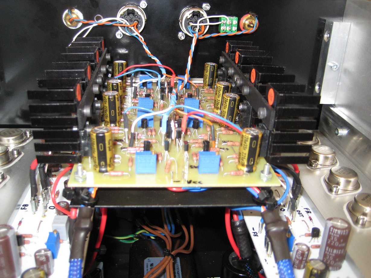

Also the frontend is all wired up and will be the last thing to mount in the chassis.

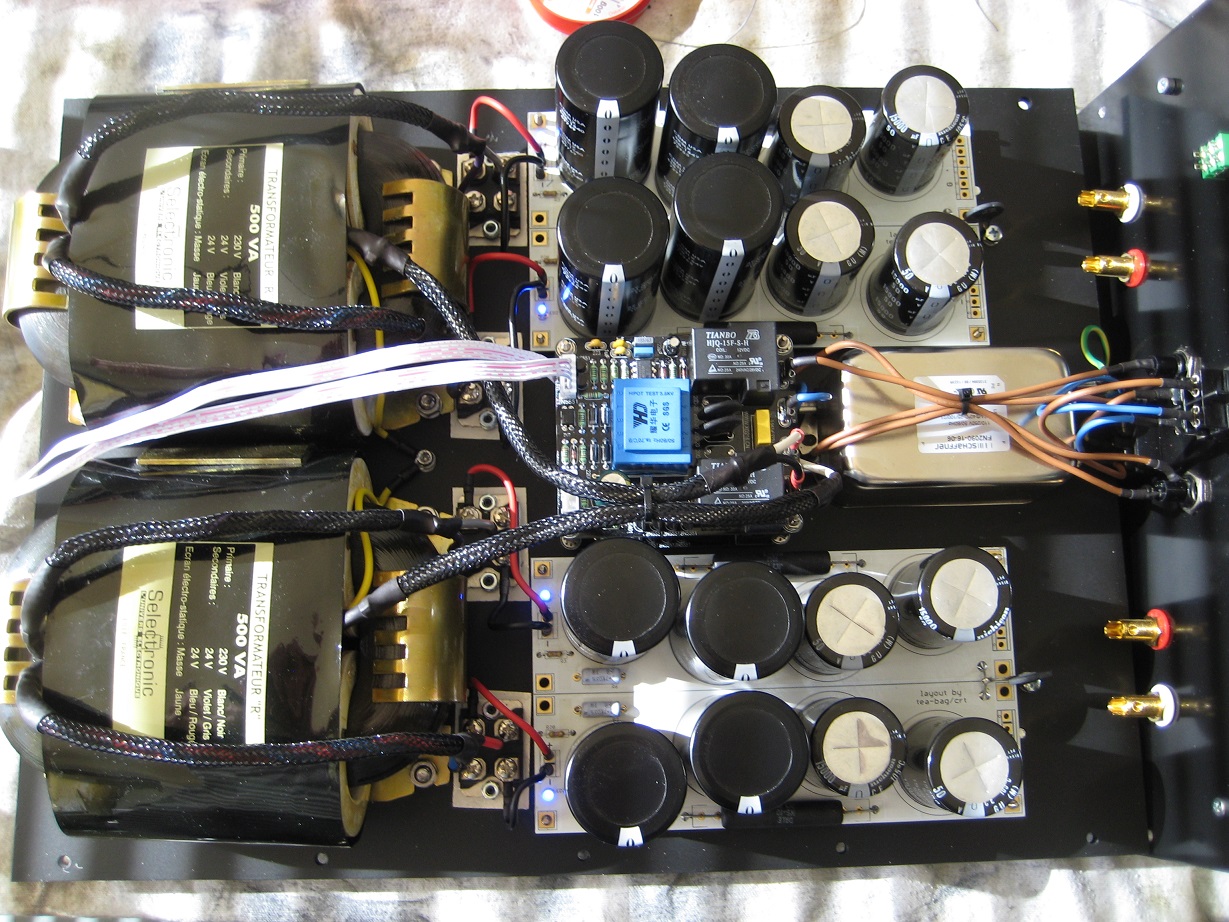

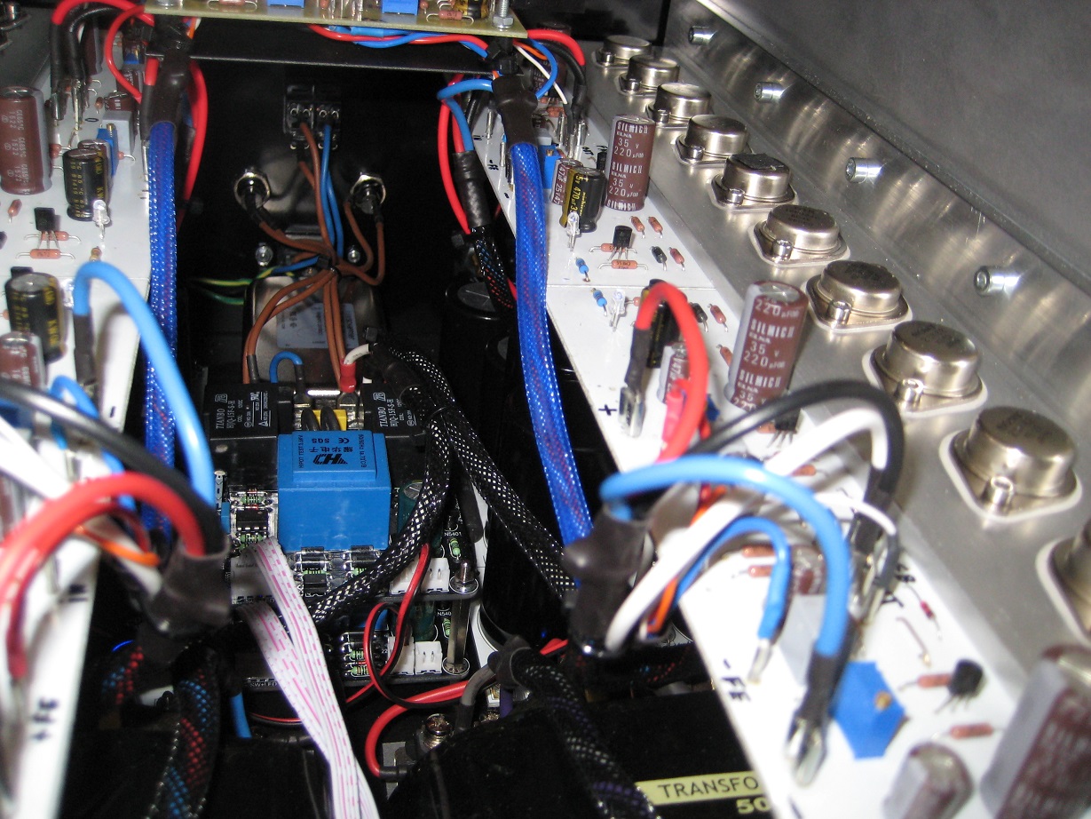

The PSU's are built and tested, everything is working fine. Around 33.5 Volt unloaded. Looks like a big power plant😀

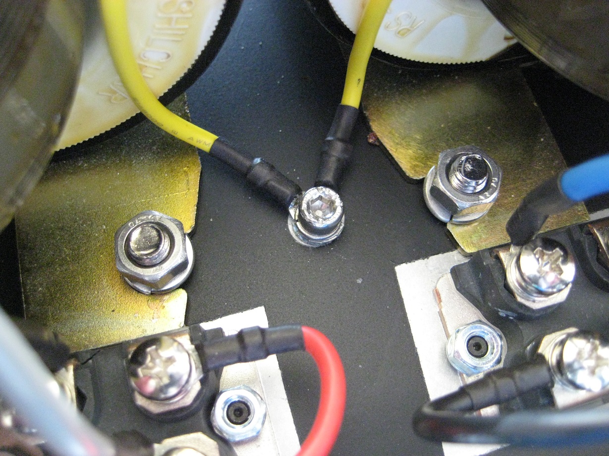

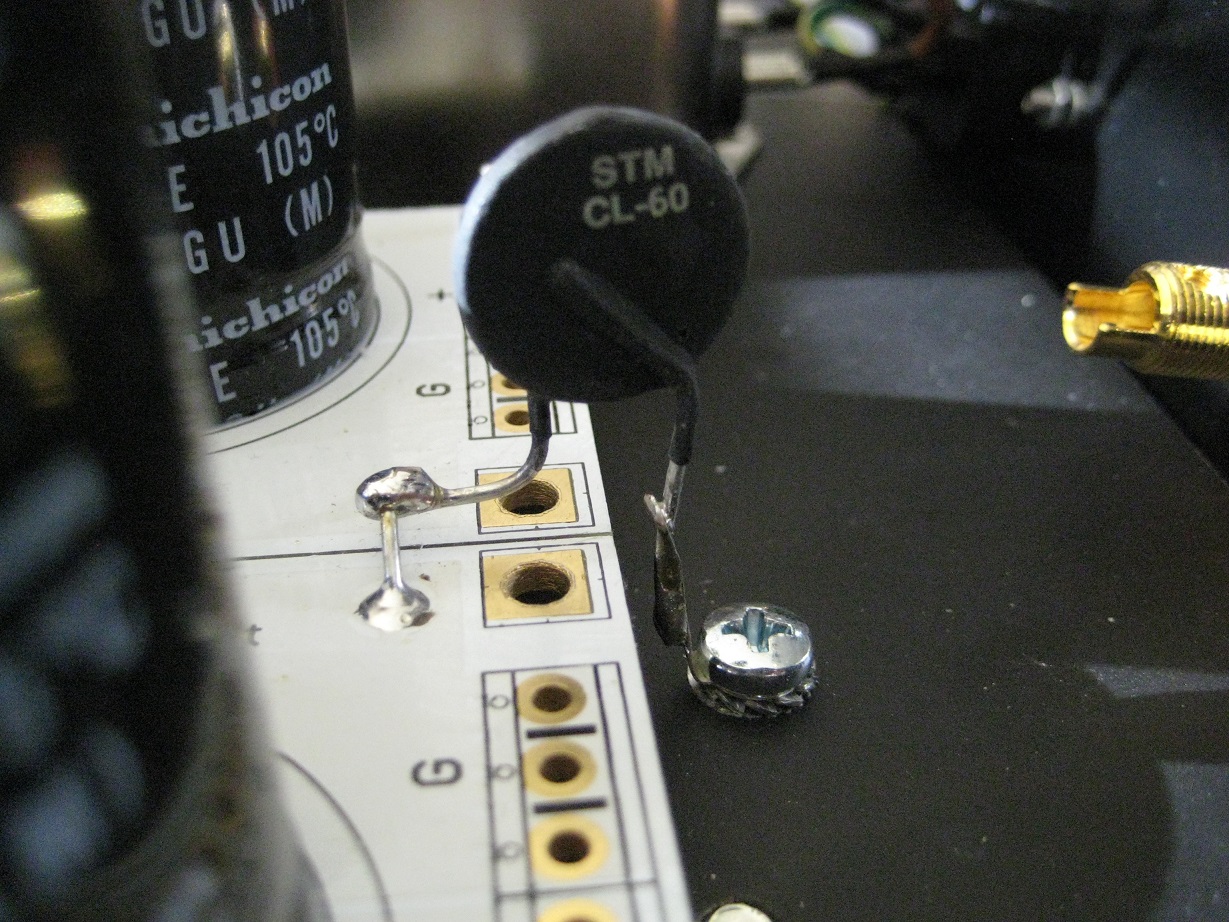

CL-60 from PSU's GND to chassis.

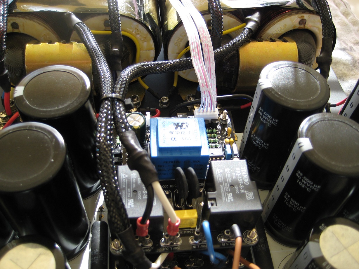

I de-soldered the Chinese NTC's from the softstart boards and replaced them with 2 proper CL-40's in series.
The R-core 500VA transformers have an electrostatic screen, yellow wire, and I put them to chassis also.
The trick is now to have everything wired up before I assemble the whole chassis, cause some connectors like the speaker terminals can not be reached when all is in place.

I like you "only user serviceable parts inside" particularly well!
BTW My experience is to build spacious amplifier chassis to ease accessibility to this and that. Nice build!

Hahaha, I must admit I stole the idea from another DIYAudio member😱
Don't remember his name...
Yup you are right, though this is the most spacious amplifier chassis I ever built, I just put in too much stuff 😀😀
Now I must constantly think what to do next, cause I almost have no accessibility to the components beneath the T-brackets with output stage PCB's.

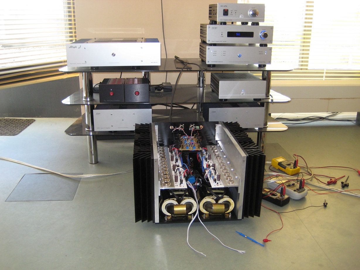

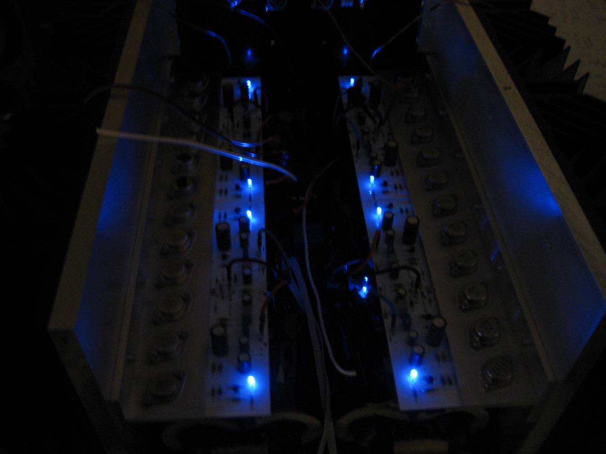

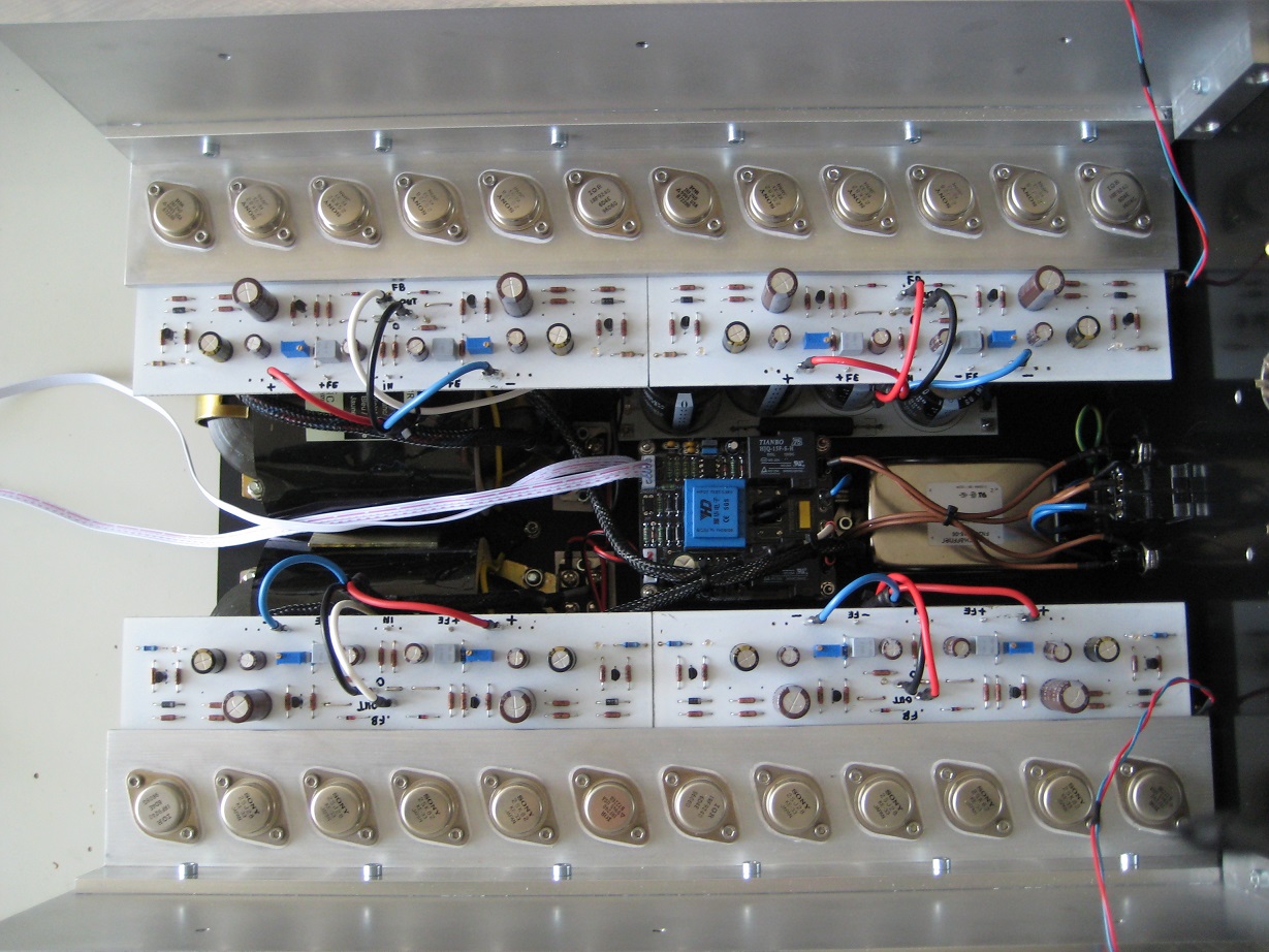

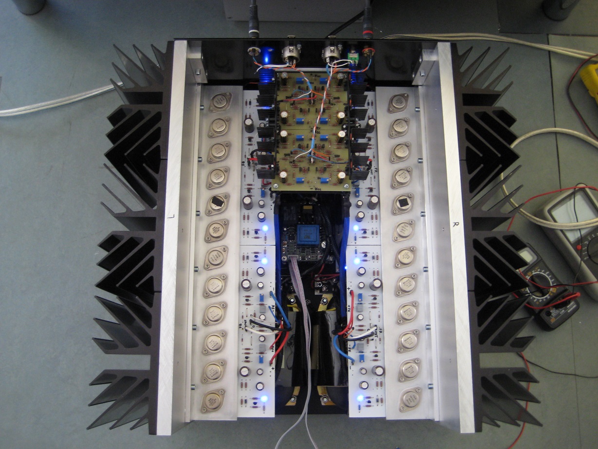

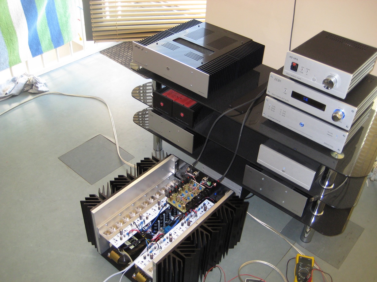

Update, output stages ready, tested and bias adjusted 🙂
Output voltage of my 24 Volts R-core is somehow lower than expected under load. ( 4 Ampere/rail)
They give about 30 Volts, I was expecting around 32 - 34 Volts, cause the smaller R-cores from Selectronics all give way more voltage then specified, but this 500VAs don't.
So I keep the rail voltages at 20.5 Volts to have some regulation for the MOSFETs.

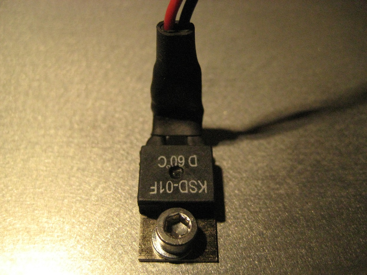

I bought 60 degrees thermal switches, but the wrong type....😡 These switch off at 60 degrees instead of on. Got to have the types with a 'H' on it and not a 'D'.
So I installed the suplied 75 degrees switches.
Amp is now running for two hours and has reached temp equilibrium: 53 degrees at heatsinks, and around 62 degrees on top of the VFET's.
Amp is pulling off 530 Watt from mains. Sick....😉😛🙂

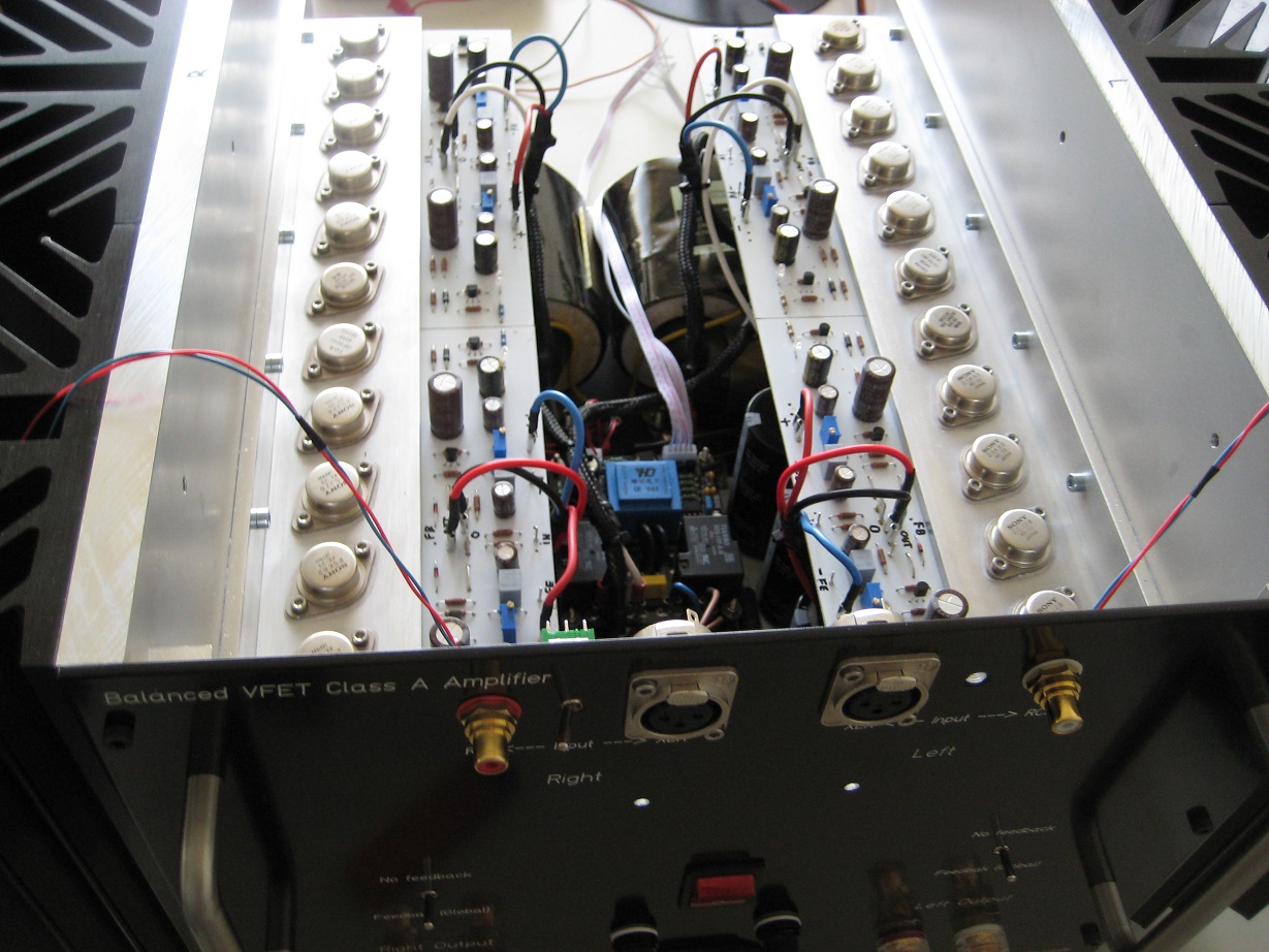

Yeah, making music !!!
It's up and running, all fine. No hum and dead quiet with my ears to the tweeters 🙂😀
Output offset per quadrant is very low <10mV so the resulting output between (+) and (-) is also very low and stable.
I biased a bit higher , starting at around 4.4 Ampere per rail of 30 Volts, so it ends up @54 Celsius at 4.0 Ampere.
It starts with pulling 620 Watts from mains and ends up around 550W fully heated.
When I connected the frontends I had to readjust the output stages, they have influence on each other.
The feedback switch can be switched when the amp is on, you hear no clicks or abnormalities, offset stays the same.
When I switch in the global feedback, the volume goes down for around 6 dB with the 4k75 feedback resistor.
I have been listening to it and it sounds very promising. I can feed the amp only with single ended RCA source for now. But my DDAC1794 has a output transformer so it will not be to difficult to feed it balanced soon and to listen to the full potential of the amp.
For now I can say it's very, very detailed, fast, dynamic, strong bass with authority like my F5Tv3. Soundstage is big and wide, very natural sounding.🙂🙂🙂
I must take some weeks to compare it to my other amps, will let you know.

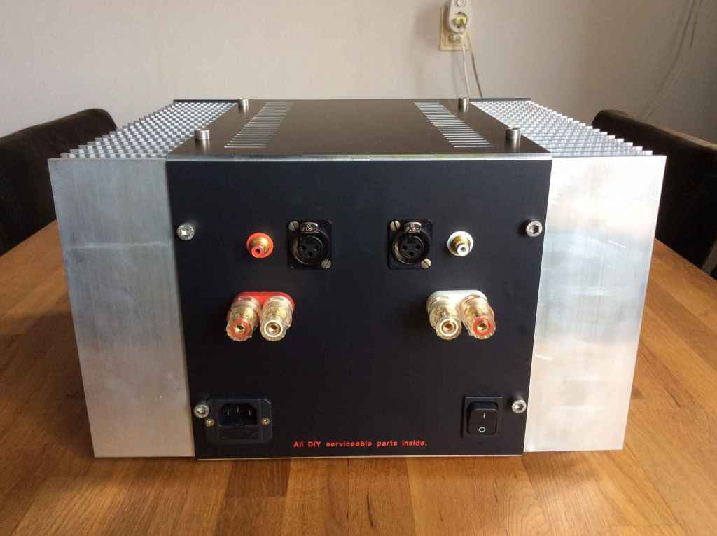

Next is to design a top plate and a nice frontpanel, Schaeffer AG (Frontpanelexpress) doesn't make thicker panels than 10mm. I would like to have a thick 20mm panel CNC-ed, like the real Passlabs amps and the Sony 40 years VFET amp from Nelson.
Any suggestions are welcome!
