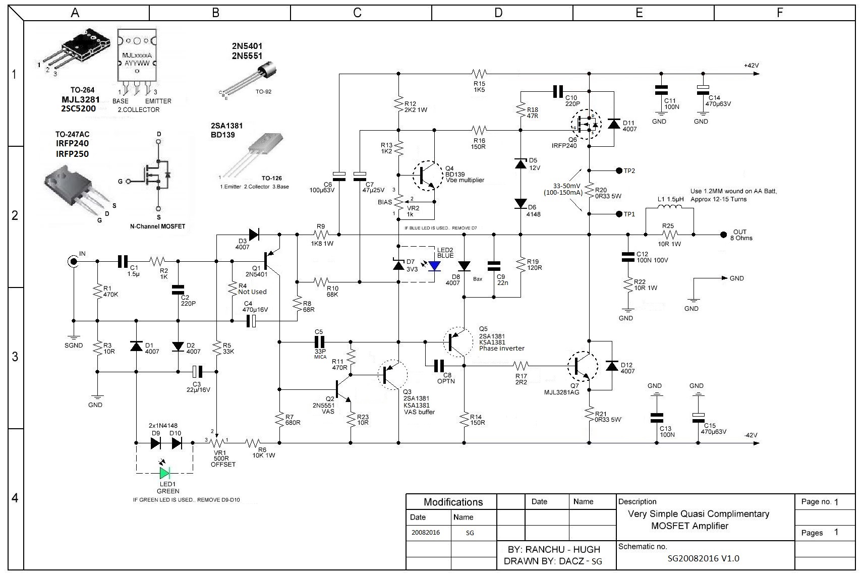

Trying to get it up and running. But it seems it will be a long journey!!
I can set bias OK, but output voltage is around -26V (39+39V rails).
I am using an 8 ohm resistor, and it kindly sent me some smoke signals.
VR1 is 1K. Using green led, no diodes.
NPN is 2SD1047 (from old PC power supply, I think), and MOSFET is IRFP250 (from an ancient UPS).
Input is shorted.
Any directions?
Input is shorted.
Any directions?
Max,
First, disconnect the speaker. With this horrific offset it would despatch any voice coil very quickly.....
Second, with respect to black probe on GROUND, measure:
1. Voltage on gate of mosfet output device
2. Voltage on the base of the inverting transistor, and
3. Voltage at the base of the INPUT transistor.

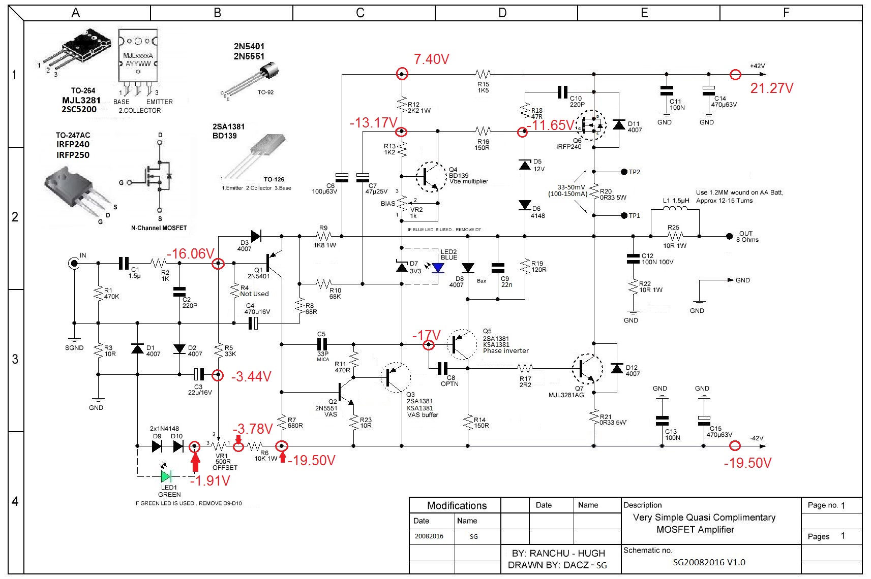

Thanks, Hugh.
In fact, not a speaker, but a dummy load.
With series bulb slightly on, measured values are (no load):
+V=20,97V
-V=-17,93V
1. Voltage on gate of mosfet output device = -11,65V.
2. Voltage on the base of the inverting transistor (Q5, OK?) = around -17.8V, but not stable (slightly decaying). Q5 is MJE350G, from OnSemi, like Q3. C8 not installed.
3. Voltage at the base of the INPUT transistor (Q1=2N5401) = -16,06V.
Other guys: Q2=2N5551; Q4=BD139.
LEDs are high bright 3V models.
QAP.
Max,
A little weird...
What do you measure on both sides of R15? And in the junction of R12/R13?
Measure around R6, VR1 and R5 too.

Max,
Something appears (?) to be dragging Q1 to negative rail... 😕
Please, measure Q2 base and collector, Q1 collector and emitter. Put values in the same schematic together with data already shown. 🙄
Maybe Hugh can perceive faster what's going on. 😎
Have you measured Q1 before mounting it?
Rgds.
Rgds.

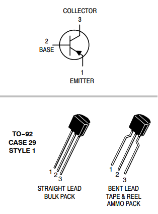

Wrong pinout
Sorry, guys, for messing with this magnificent thread. It is the first time I use a bunch of 2N5401/2N5551 I had bought from the same supplier. Unfortunately, the 5401's have different pinout from the standards. I knew it could happen, but I didn't realize it would!! Tomorrow I will replace Q1 and start it all over again. Thank you very much.

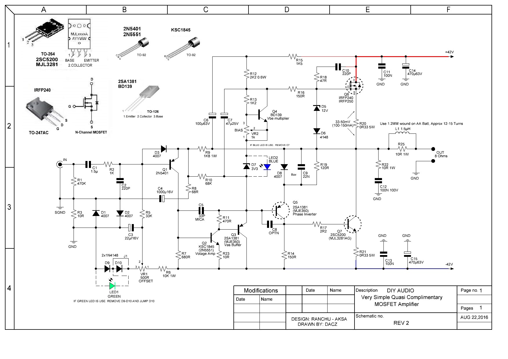

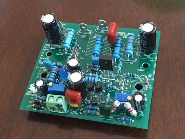

Almost done with new Dacz board. I made a few minor substitutions like 0.22R source/collector resistors and used SMT 100nF bypass caps on underside. Also 22pF NP0 SMT instead of 30pF mica. Using NJW output rather than 2SC5200. Still needs the output inductor to be rolled. It's a nice board and easily soldered with enough clearance in most places. Am I going to run into any issues with a 500R trimpot for setting offset vs spec'd 200R?
hi xrk971, can you please take the voltages so that i can update the schematic.. thanks,
dacz
dacz
Hi Dacz,
Sure, except that the amp is just in middle of getting installed in a proper case, so at present, not functioning. Maybe in a week I will have it up and running again.
Zman01 has a running amp at the moment using the exact same board. He is using a green LED rather than the two 1N4148's to get zero DC offset. I recall mine was on the verge of running out of room.

OK, it was only Q1 with inverted base and collector leads.
I replaced with another one and it started working as expected.

hi smartx21, congrats for the build. since you are now working on it kindly take measurement and update the schematic voltages. i will update the schematic once you supplied the readings.
