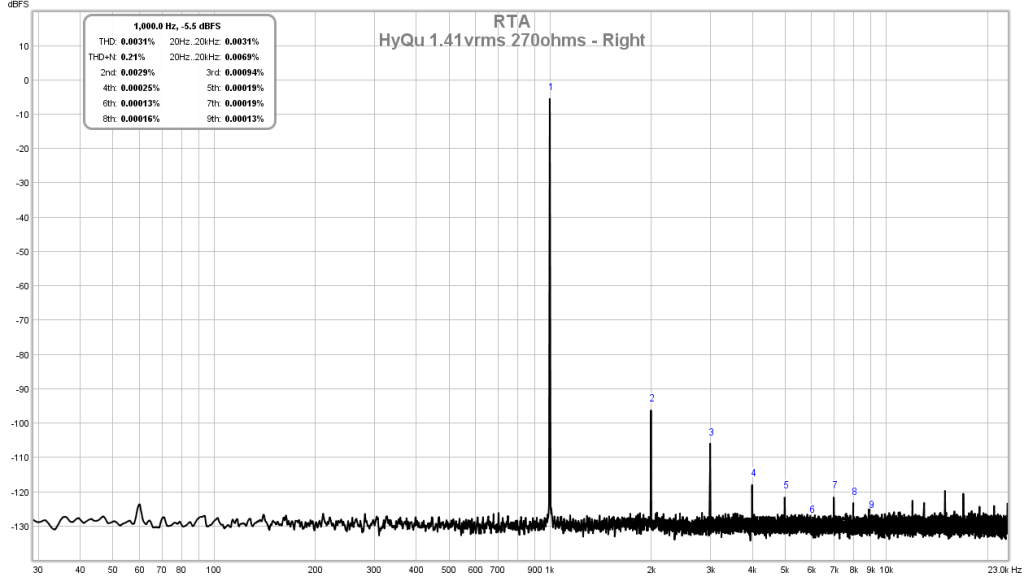

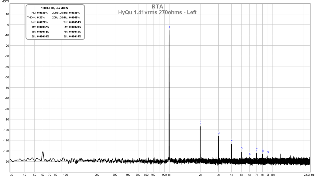

A new Quasi developed in partnership with Hugh Dean is born: the HyQu, a Hybrid Quasi headphone amplifier using smaller output devices and single rail power supply, with of course, cap coupling on the outputs to ensure safe operation with headphones. Here is my hand etched prototype running on 24v rail and 95mA bias current. Sounds great and measurements are not too shabby either. Here are FFT's for 1.41vrms into 270ohm load - about 0.003% THD with about 29ppm H2 and 9ppm H3 and descending higher harmonics with a -130dB flat noise floor. Suppression of the wall AC mains 60Hz worked out pretty well too. This will be a product line so sorry, can't share the details of schematic.
Left:
Right:
Left:
Right:
Well to show that this amp topology can be used for a headphone amp. If it bothers you guys I can ask a mod to move it to commercial section.

No harm, no foul. Thank you XRT for sharing the design concept, photo and plots. It gives us DIYers new ideas on how to use this circuit.
Have you considered selling this as a short form kit set consisting of pcb and board components, in the same vein as the original AKSA 55? Would seem to be a good candidate; low parts count, simple construction. If so I suggest that the final, debugged circuit be laid out on a single pcb comprising the stereo amplifier and power supply - all in one - just like Hugh's boards.
Some nice, compact, aluminium enclosures are available from China that would suit this nicely. Orient the output devices so they are underslung and bolt directly to the alloy chassis for heatsinking.

Thank you for your understanding and consideration in making this a kit. I have actually been thinking exactly along these lines. Layout would indeed be single board with integrated PSU and under-hung outputs to for the standard aluminum chassis that is available on eBay/Aliexpress. What's neat about this amp for headphone use is that, although relatively cool running (5w dissipation), it runs in Class A for 99.5% of most headphone use - that is up to about 500mW to 700mW info 55ohms depending on supply rail). That's actually threshold of pain in many headphones. 🙂 but it provides that dynamic headroom needed on some headphones such as inefficient planar magnetic ones that are only around 82dB sensitive. Those particular units are looking for up to 2w - which is achievable with higher voltage supply rails. All the while retaining this incredibly beautiful harmonic distortion profile. The above measured profile is in fact, one of the best examples I have measured in any amp, ever.

No six legged critters here as this amp is a singleton input stage. The most exotic part is still readily available: the legendary Toshiba 2SC4793. I will keep you posted Christian and thank you for your support, customer No. 1 😀
