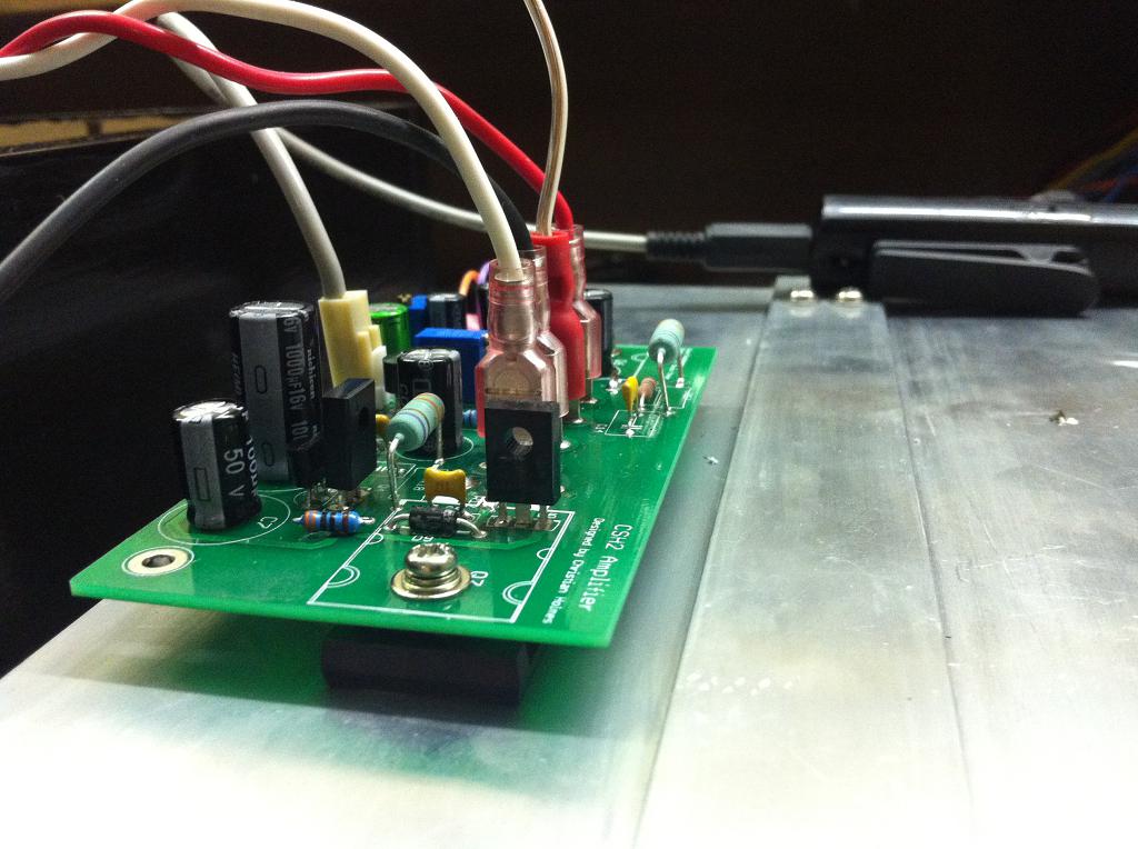

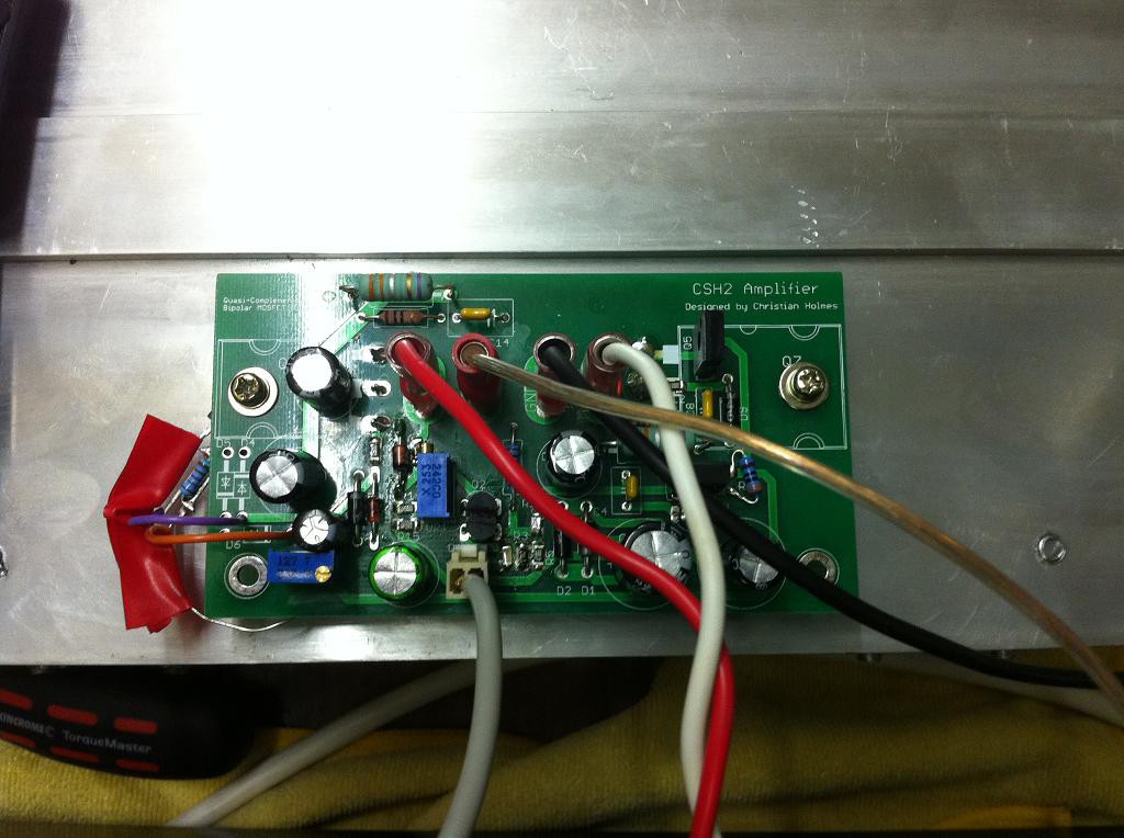

I built up a prototype today, it went off without a hitch, except that I ran out of compliance on the input bias generator: halving R13 cured that. I didn't have any 12p caps at hand so I substituted a 22p instead.
This is the first quasi I've built, the first I've owned, and one of a very few I've heard.
I want to preface all this by saying that I've only spent a few hours playing music through a single channel, in the workshop, under the house, through a bookshelf speaker. A proper listening report will follow once I get it into the living room and hook it up to a pair of floorstanders.
I've formed the opinion that capacitor burn in is a non-trivial concern. I conjecture the NFB shunt cap is particularly problematic, evidenced by my observation that circuits with a high value NFB cap (such as this) take a little while to achieve their potential.
After only an hour of listening the difference was profound and I expect further incremental improvements to come with further listening time.
This amplifier does sound better with a more bias than I'm accustomed. In this case I started with 50mA across Q6 source resistor; some crossover distortion / high frequency artefacts were evident.
With 150mA bias and a little music time on the caps it started to hit its stride: bass is prodigious for such a small amp (I can't wait to try this on my floorstanders...)
It is similar in some respects to the TGM8. Very musical once the caps had started to bed in and the bias was increased above typical levels.
I believe this has the potential to be a very good amplifier indeed 🙂
Did you reform any of the electrolytics before assembly?

Hi Borys & Hugh (AKSA)
I'm really enjoying the sound 😀 This morning I snuck downstairs while the family were asleep and had another listening. I dialed back the bias a little and the sound was still wonderful, leading me to think that the caps just need a little time to form properly.

Output biasing
I expected bias stability to be a major issue (actually I half expected the MOSFET to go up in a cloud of smoke within minutes!). That hasn't proven to be the case at all.
Borys, be aware that I went straight to Hugh's suggested bias generator shown in the schematic attached, instead of the simple bias string arrangement I originally designed the boards for. In the photos you can see a TO-126 sandwiched between the MOSFET and the board underside so that it tracks the MOSFET temperature. The diode is in free air per Hugh's recommendation.
With bias set so there is 50mVdc across the MOSFET source resistor, it varies between about 40-60mVdc between stone cold and hot. I don't know if this is good or not (I've seen better tracking in all BJT designs) however it never drops to the point where crossover distortion is evident, nor would it appear that thermal runaway is a concern.
