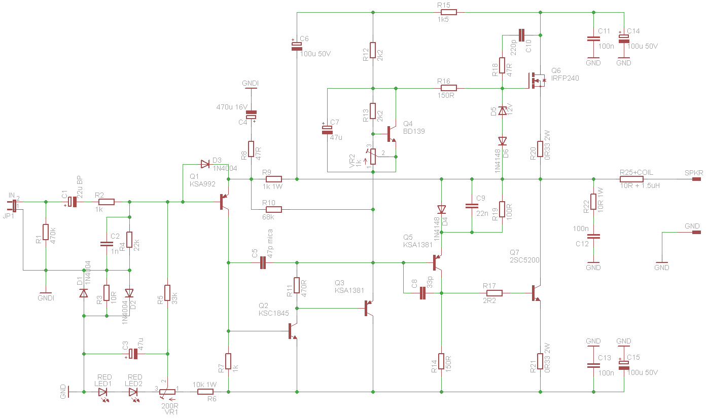

I built up a prototype today, it went off without a hitch,
Well done - I recall playing with a similar architecture back in my student days (I only had a 2N3055 and a Hitachi MOSFET ex ETI-5000 to play with and no money to speak of) but never went any further than a quick jury rig. Sounded nice when it wasn't oscillating.

Interesting ideas AndrewT and ivanlukic, I will rig something up and give it a go.
On an unrelated matter, I've done some more testing and the bias is not as stable as I first thought. With the trimpot adjusted to, say, 50mV at quiescent, after I stop the music after a long, hard session, the bias drifts to about -200mV or so. I'm going to experiment by placing another diode in series and see if that helps. Failing that I'll try increasing the value of Rbe on the Vbe multiplier.
Ranchu, please clarify, -200mV - the bias, or DC offset?
OK, that's what I thought, however it looks like some others took it as an offset...
I believe, a diode, or even a LED in the spreader will solve this over-compensation issue.
Elegant design in overall - very cool

I had a little time last night to play with the output bias generator. I removed the diode and this has improved matters: the bias does not jump nearly as much after the music stops. Bias stability is heading in the right direction now, so I'll play around with the Rbc resistor to see if further improvements are possible.

Can you kindly post the final schematic, if different from post 95?
Updated schematic

Prior to Christmas, Hugh and I refined the design at post #140 a little. Whilst I don't want to divulge Hugh's secrets, I do want to provide you an updated schematic that addresses a few shortcomings, namely:
- Gate-drain zobel added to prevent a potential source of instability here. I've used similar in my other MOSFET projects and it really does work wonders to quench any tendency towards oscillation.
- Cdom has been increased slightly to 47p and C8 added to prevent another nasty source of instability that results in HF ringing.
- The input transistor biasing has been simplified, and now uses a simple voltage divider to set its operating point at the base.
I do encourage anyone that is mildly curious to build and test this design for yourself. In my humble opinion the sound is absolutely sublime; I take no credit here and attribute this entirely to the expert input from Hugh, Richard and Gareth, without whom this project wouldn't have been possible.

Unfortunately not thimios. I did a layout based on the original schematic, and have subsequently "hacked" them to incorporate several changes.
It is probable that I will revisit this at some point in the future, but it isn't a high priority at the moment. I'll update this thread with any further developments.
