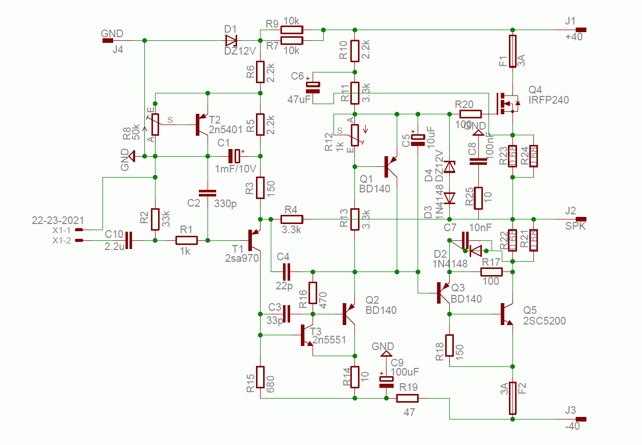

Hmm, try a 22uF cap from emitter of ground. I suspect some of this bad behaviour at HF is due to the bias system.

I will measure the exact votage between the base and gate of the output transistor and replace the bd140 transistor with few biasing diodes+resistor and increase the cap at the vas stage

That is not a quasi complementary push pull stage.
It is a CFP lower half and a lonely mosFET in the upper half.
There's nothing complementary in there.

But if it is a CFP lower half should not be C7 D2 and R17. Then Q4 should be a P-channel MOSFET.
You could explain me how this circuit works?

GE,
It's a modified CFP, using a R/C/diode all in paralleled between the master emitter and output to replace the pn junction of the driver, which of course is deleted with the upper nmos since its gate does not require a driver.
Since the inverting master and the nmos comprise the bias control, you need to soften the turnon of the master so that setting the bias is not too tetchy.
The diode is included so that when the lower output turns on the base current is high, and the diode prevents more than 0.6V dropped across the R/C/diode network. This is very important on a quasi since inserting the master costs rail voltage; you can't swing as much voltage at the output compared to a complementary output stage. This diode limits the loss of rail efficiency.
This phase inversion at the drive stage for a quasi is almost always used, many over decades. There are other ways, specifically to the JLH Class A very example, the advantage of this topology is that you combine a quasi drive with strong bias control at the output stage.

Again I ask the question from the previous post:I've always seen in a quasi complementary output stage that R17 = R18. In this circuit, what is the reason that R17 = 100 and R18 = 150?

R18 could be any value from 330 to 100 ohms, depending on the type of transistor used for Q3. In my Quasimodo design, I use a 220ohm resistor and use a 2SB649A for Q3
I arrived at the value of R18 just by listening! I also use the 2SC5200 for the final transistor- a good combination, I find.
You just can't beat subjective listening tests as the final arbiter of finalizing an amp design.

There is small progress anyway. Today I have lowered the NFB resistor values to investigate the high freq artifacts, I have desoldered the bootstrap cap and all is ok.
I will put resistor in series with the bootstrap cap anyway.

Could my problem be caused by the bias tranistor (my one is pnp bd140) emiter is directed to the not active side of VAS, should I change it with bd139 (emiter directed to the active side of VAS) ?

Good question. I'm working from the schematic on #92, so I will use the designations on that schematic.
I don't think it makes any difference regardless if you use an npn or pnp; the AC path is via C6 which communicates very low impedance from Q4, an emitter follower, to BOTH gates.
I may be wrong because I do not use this Q2 bias system on the emitters of the input singleton, but I believe that the cause is a result of changing the impedances of the fb network wrt R15 3k3. I believe that changing R5/R6 dividers to LOWER impedances forces changes on the bias point. The current from Q2 which controls the offset supplies BOTH current into Q1 emitter AND R6, the series fb resistor. I think you need to make R15 relatively LOW wrt R6, and you also need to have a 47uF cap from emitter of Q2 to ground to hold this potential low. Actually, I believe this is a compromise though clever trick; my preference has always been to bias the base of Q1 via a 33K resistor, then ALL the current passing through Q1 is supplied entirely from the output node via R6.
I do not criticise this circuit. I think it is very clever and I'm very interested to hear the subjective tests. I know the THD will be high; particularly H2 and H4. This is not a purist, engineering design, but it will probably sound wonderful.

Thanks. I will try to do some modyficaions soon and post results. I do not care a lot about THD numbers anyway in this case. Amp was playing whole day without bootstrap capacitor, the sound is really smooth and nice. I have some spare time and basic tools, I have also lack of knowledge so any help is really gratefull.
