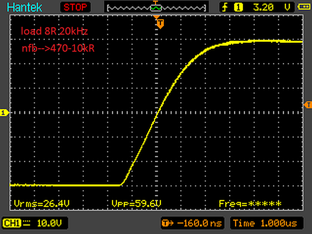

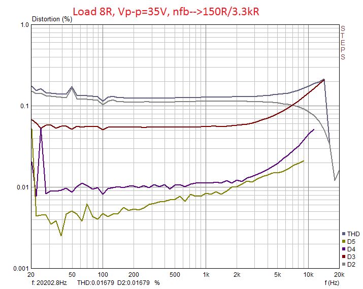

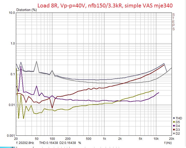

I have few more postcards. I tryed simple VAS transistor too and it seems to be ok but so far I found one diffrence to Ranchus VAS, with single transistor the THD spectrum is different threw the output amplitude range but with Ranchu's VAS the THD has very similar character threw the output amplitude range.
I have missed one detail, the input compensation transistor is different type to the input one - so I will have to change it.
Bigun
The small question - input temp compensation - set the power dissapation on the both transistors the at the same level (input and compensation transistors) ? So they will heat up the same way or set the compensation transistor a bit lower so it will take a small bit of VAS transistor temp drift ? Or just experiment 😛
Now the nfb resistor network:
-47R-1k - the square wave's --> game over, 1mF cap is discharged completly and output looks like my 2yeares old daughter drawing 😛
-150R-3.3k - square waves are ok at 1-4kHz but at higher f looks like a drawing as above
-470R-10k - i can do the square wave tests ok.

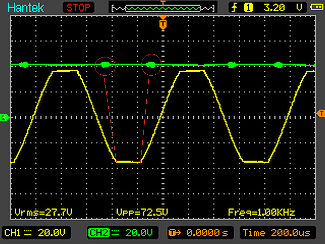

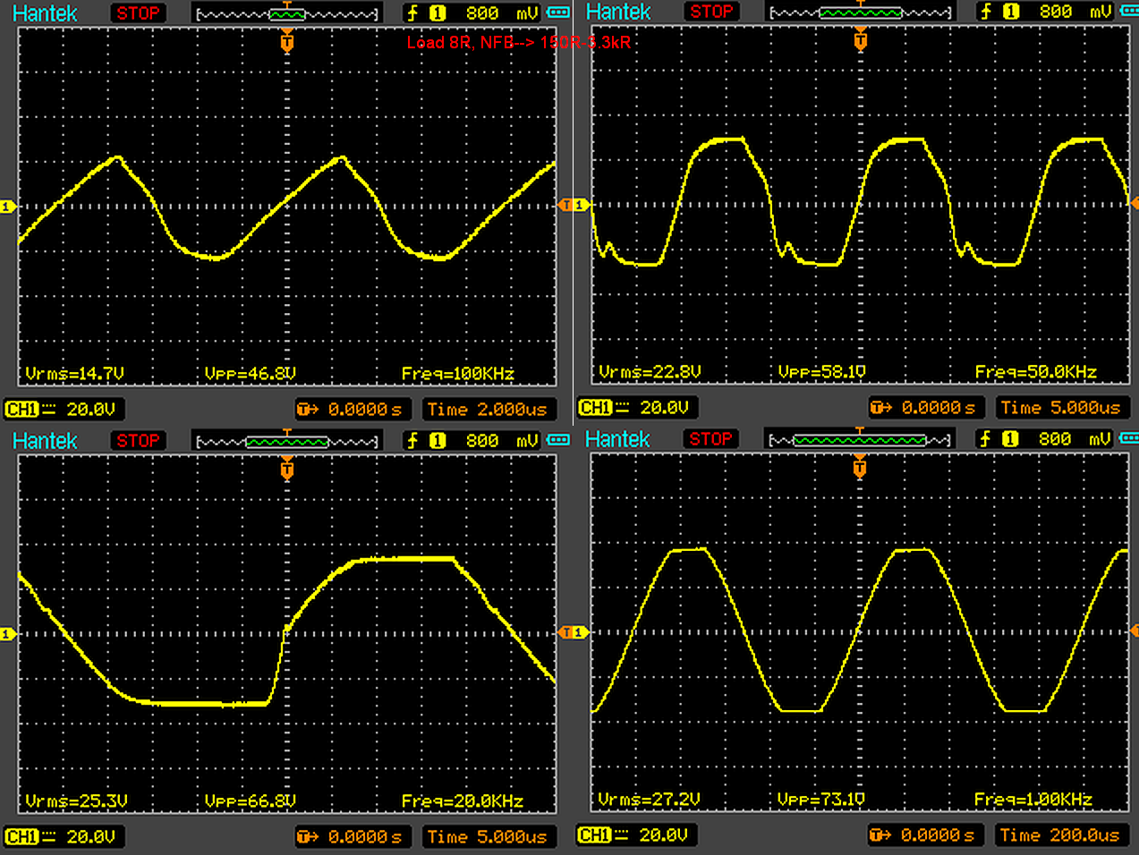

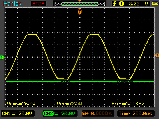

I have no decoupling caps right now on the board but please take a look at the clipping at the mosfet side rail supply, it needs some investigation.
Right now da Ranchu's time machine is driving rs125 paired with tw022wa04 monitor, time for ''the ear'' tests.

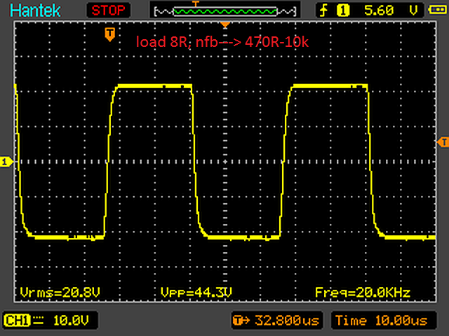

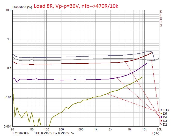

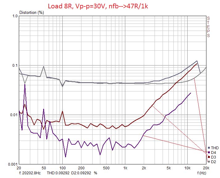

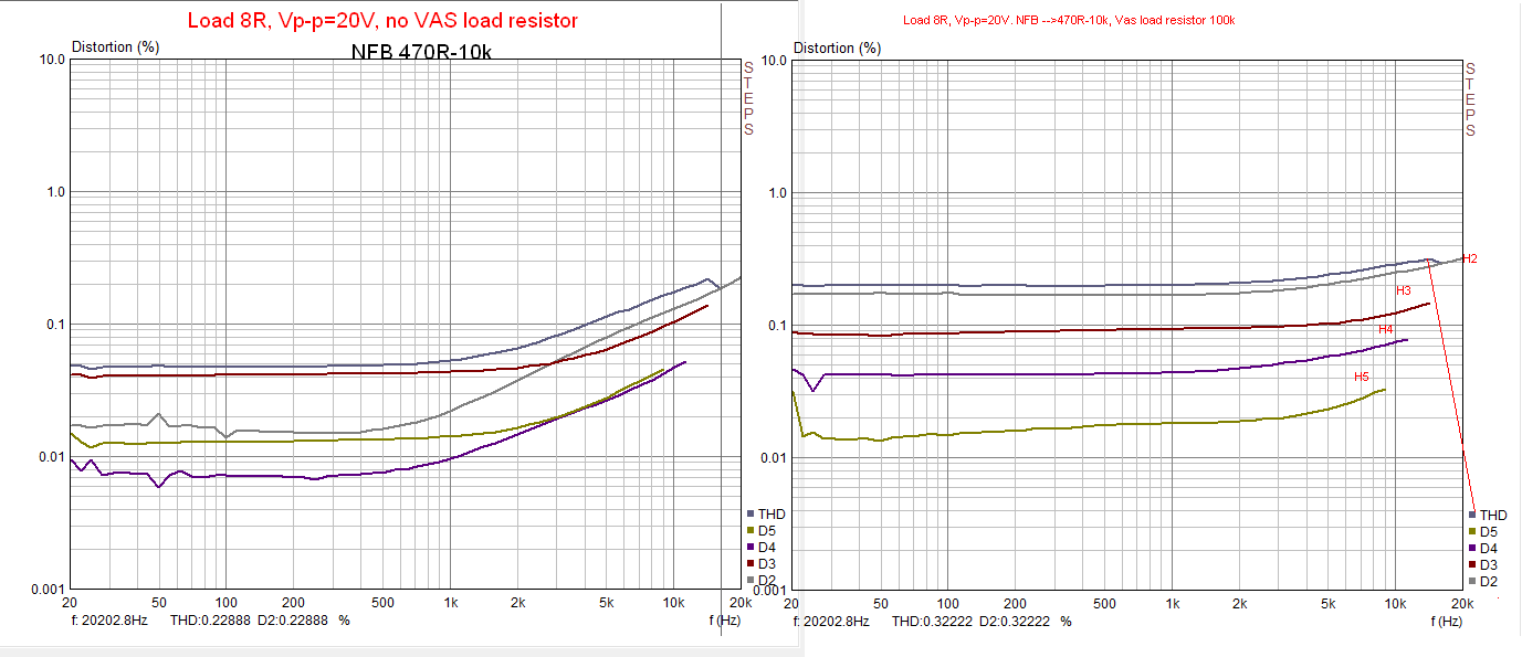

Hi Borys
Are you able to show the results with normal sine waves? More importantly, have you been able to listen to it yet? :-D
I will post tomorrow. Please write down what you need (what amplitude and what frequency) and I will post it tomorrow.
Yes I was listening the amp for about 16-20 hours so far. I will have to improve the wiring on my messy bench and take the thd measurements again.
Borys,
Don't be too worried about the measurements. This type of amp does not measure very well, high levels of H2, H3 and H4. Square won't be wonderful either, although the recovery from clip is excellent. Trust your ears, however.
Congratulations on getting it laid out and built so quickly.
Hugh

I will try to do as many listening test as possible, the measurements were bit worse because my wiring meas on the bench. But it is really interesting piece of amp.
I am waiting for Ranchu to get his board done and some feedback, togheter will be easier to work further.
At the moment i have soldered MJE350 in vas and as a lower driver, there can be bit sticky, slowly comming back to live after get saturated, i will solder some better trannies and compare results.
I dont mind if the amp isn't very good in measurements while it sounds right but I have to check if it is stable. The next step is to work a bit on the compensation because with capactive load the overshoot is quite big - i do not know if it is important factor but do not won't the amp to ''answer the questions asked by itself'' i mean oscillations with difficult loads.

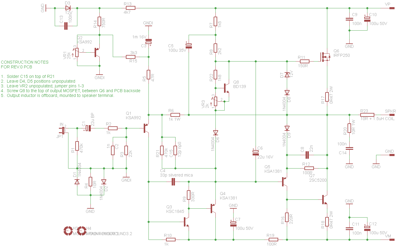

Hi Borys, Ranchu,

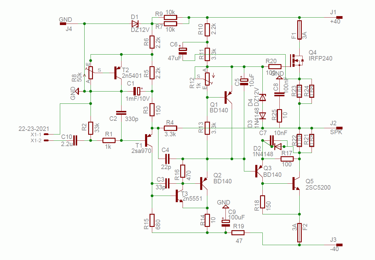

I have the latest schematic, appended.
A few points I noticed:
1. C3, lag compensation, should be about right but I would connect between emitter of Q2 and base of T3. Collector of T3 is very high impedance; it's over compensated.
2. C4, phase lead, should be 12pF.
3. T3 should be very low Cob and high beta and speed. I suggest a KSC1845.
4. C6 bootstrap works best from the output, is improves stability at high output.
5. The Vbe multiplier will generate around 5V bias. This will create almost 8 pn tempcos, and you really only need about half that. If you inject a free air 4002 diode into the emitter of Q1, increase pot R12 to 2K and use 1K8 for R13, you will get around the correct compensation as the outputs warm up.
6. I would replace D2 1N4148 by a 4002 since the smaller diode will blow at around 100mA. If Q5 is at 5A, you much be driving almost 100mA current into the base, and almost all of it comes through D2.
7. I would add a 1.5uH inductor in series with a 10R damper in the output lead.
To test the thermal behaviour, use a hair dryer on the outputs will playing!

Nice circuit,
Hugh

Borys,

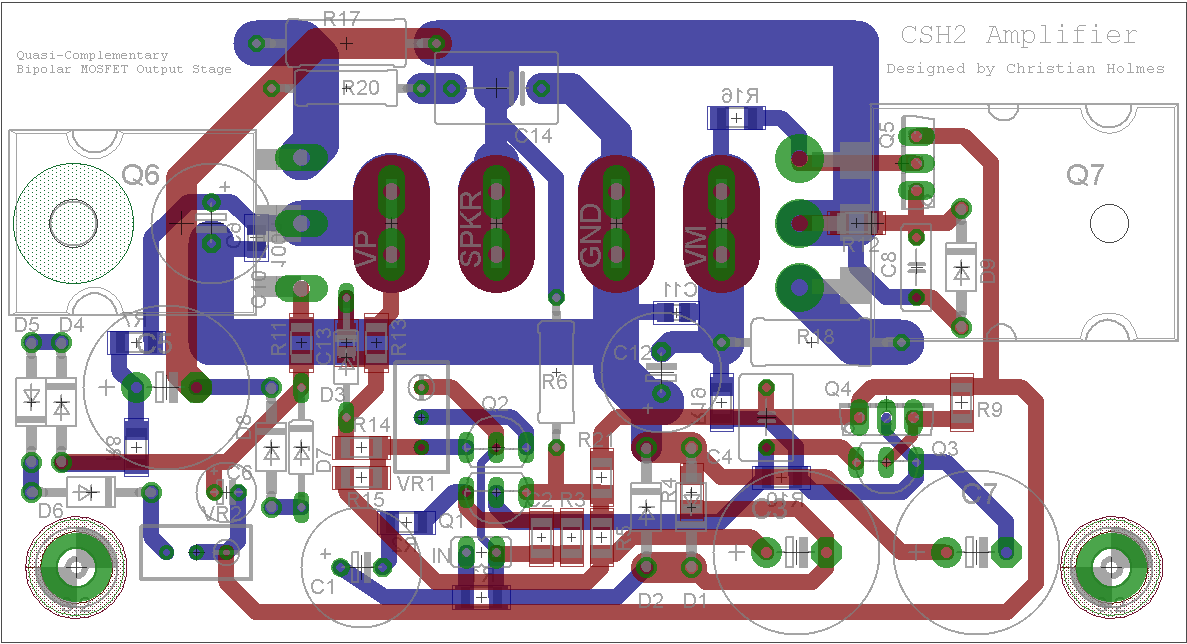

I would love to join the fun, unfortunately my printed circuit boards are on a ship, somewhere between Taiwan and Australia! I anticipate it will be another week, perhaps two, before they arrive.
AKSA,
The board layout i posted at #63 is what I came up with and matches the boards currently en-route to my address. If my layout is deficient I would gratefully accept any criticisms and rectify them. I'll also send Alex MM a message and find out if he's interested in producing a version.
Schematic and board layout attached.
AKSA,

Ranchu,
Looks terrific - at least from where I can see it!
One detail; D6 should be inserted between emitter of Q8 and the bottom of VR3. Thermally bond Q8 on the mosfet, and keep the diode in free air.
The only question will be the tempco issues with the bias current, might be a big strong, but better to reduce with increasing heat than the reverse...... this is a trick on PA amps.
You might consider fiddling R21 too. At 470K your set OLG of first and second stage is 470k/47, a tad high at 100k (100dB)!
Very nice schematic to read, well drafted. Clean drafting is much easier to understand.

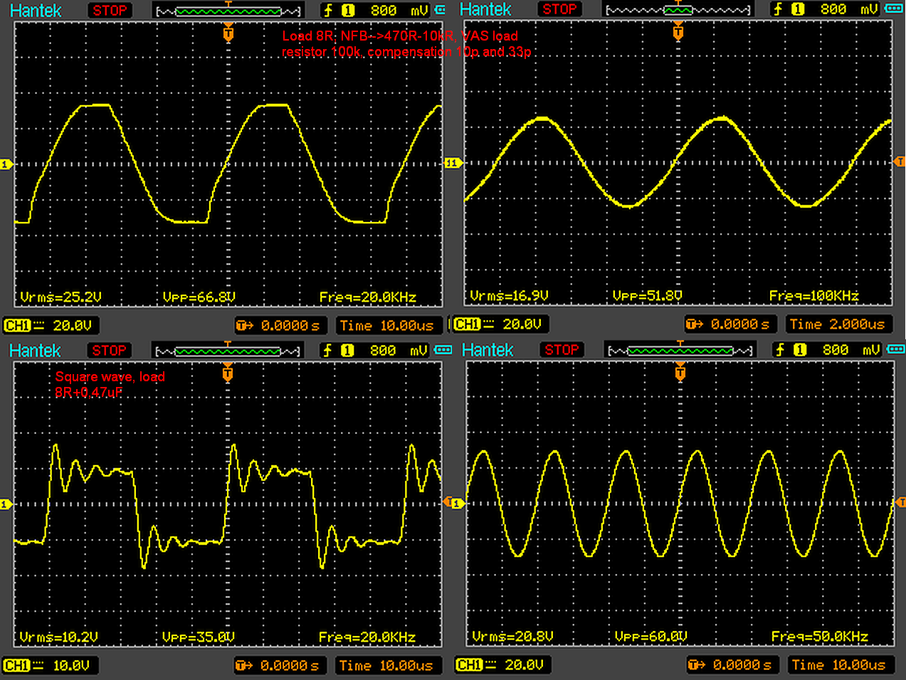

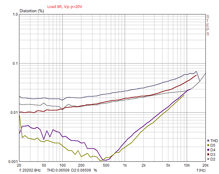

Ranchu32

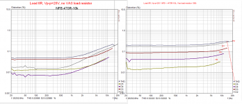

I have made some sine tests today. One test with 150R-3.3kR nfb resistors and the second test with 470R-10kR resistors.
If I will drive harder the amp with lower nfb resistors values it behaves very badly at higher frequences (take a look at the amplitude), even it is burning both fuses on the board. If I lower the nfb resistors values it it gets better. I do not know if this is some fault on my board or the impedance of the AC ground is too high. I am wondering if Bigun can give some advice here.
The 1000uF cap on my board is Panasonic FC.
As a VAS load resistor I have used 100kR value (nfb network 470/10k), look how the harmonics spectrum is nicely dropping down, smooth threw all audio band.
Hmm, try a 22uF cap from emitter of ground. I suspect some of this bad behaviour at HF is due to the bias system.
